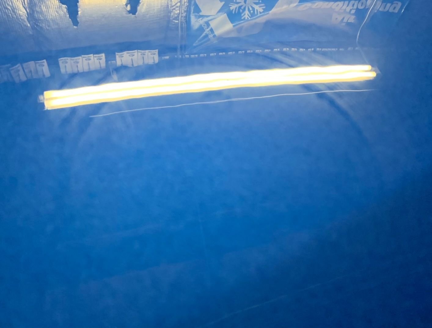

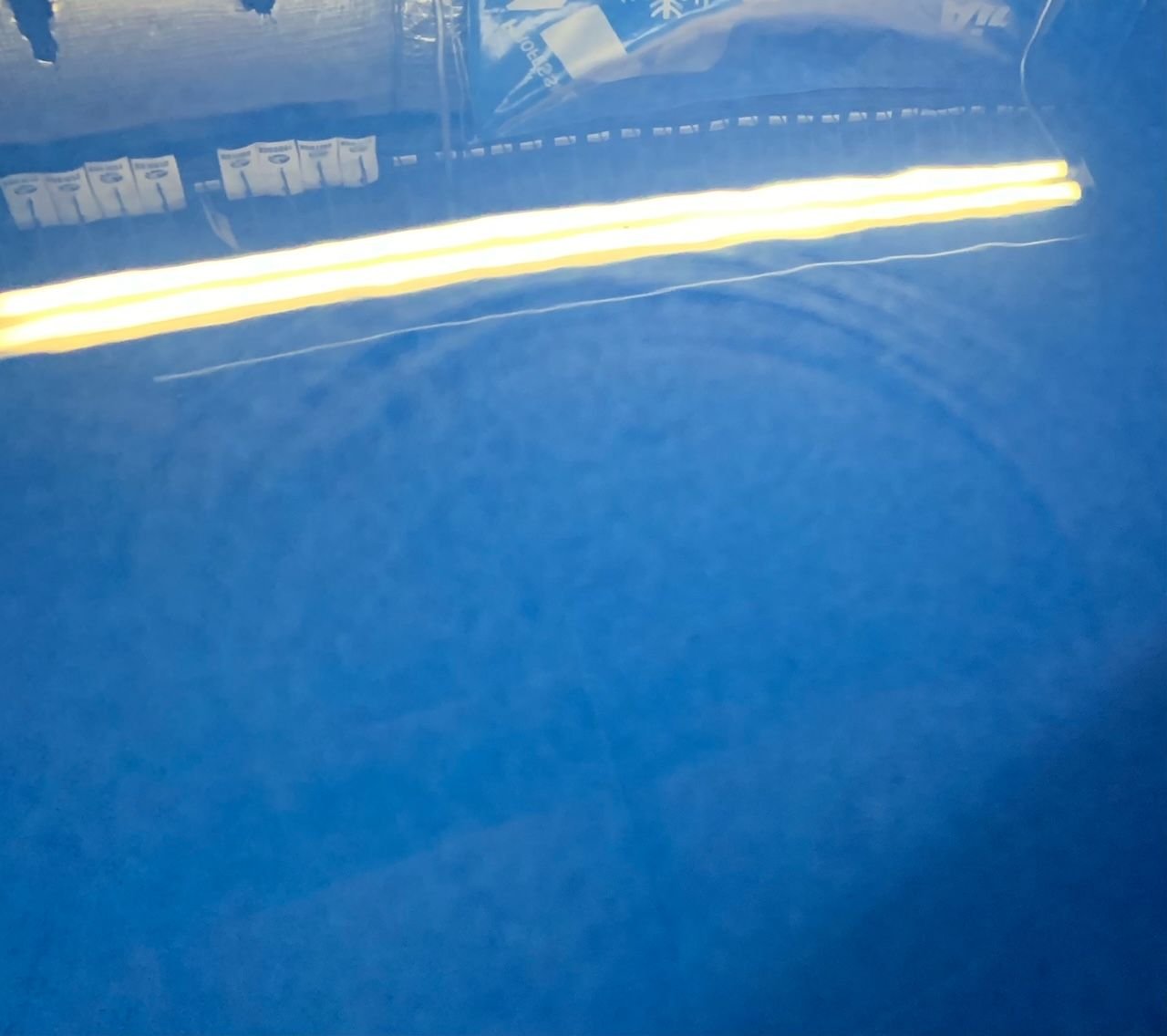

Has anyone else seen what looks like suction cup marks on the panel over the engine? I assume the panel was held in place with these cups. I gave the car its first wash and applied a graphene/ceramic coat and noticed I'm not able to wash the ring marks out.
I'll try and get clearer pics next time.

You won't be able to wash that out if you applied a coating on top of it. You'd have to use a DA to buff the coating off and then the rings and reapply the coating afterwards. Remember to wash and decontaminate the area with IPA or another prep solution before applying the coating.

Yep, you'll need to buff them out (I used McGuire's ultimate), repolish, and then reapply the ceramic/graphene/etc.

Yep, now that you've put a ceramic coating on you've made it much more difficult to remove.
