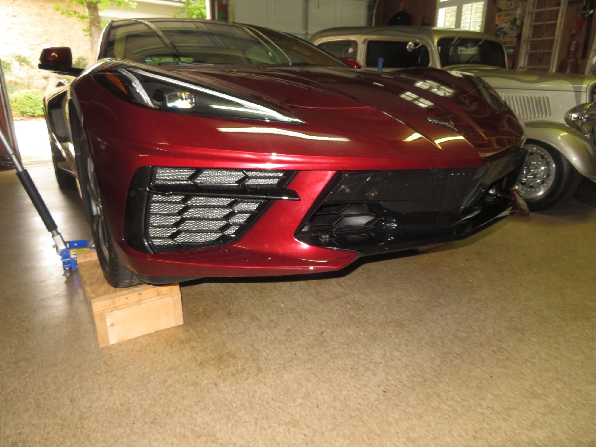

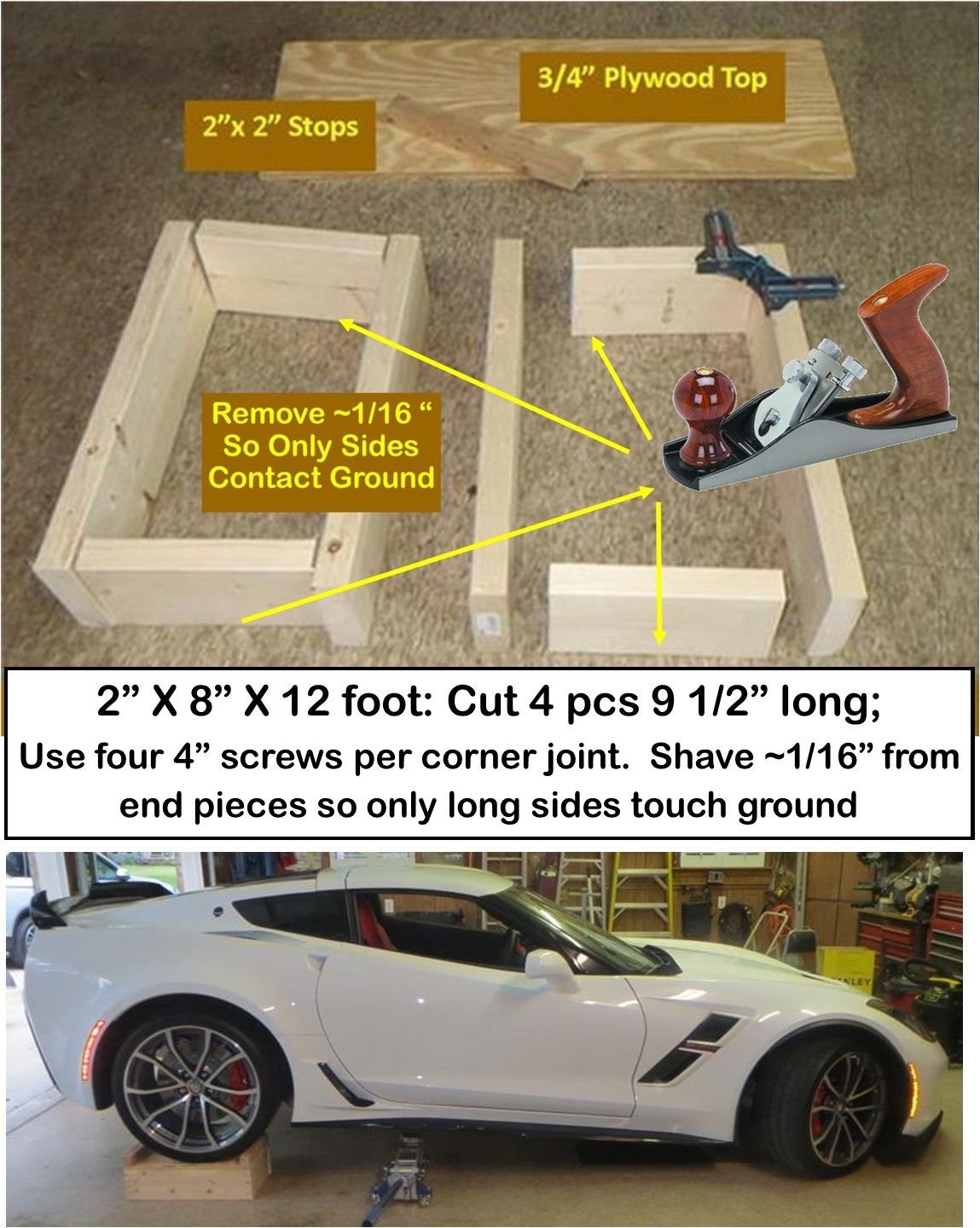

Not really, be careful but 10 inch is pretty high. Frankly even with my lower height stanchions I use two jacks alternating jacking each side. 10" is higher than needed. For far less $ you can make your own and although mine are ~6+ inches, 8 inches can be made for not much more.

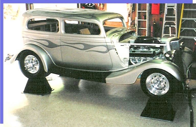

BTW I have 12 inch high stanchions but a PIA to jack up that high unless, as I did when building my street rod where I was on my creeper for several months installing exhaust, fuel lines, wiring, etc etc. Never use for my 6 Vettes.
I used my 6+ inch stanchions to install my condenser mesh and my 5VM type splitter.

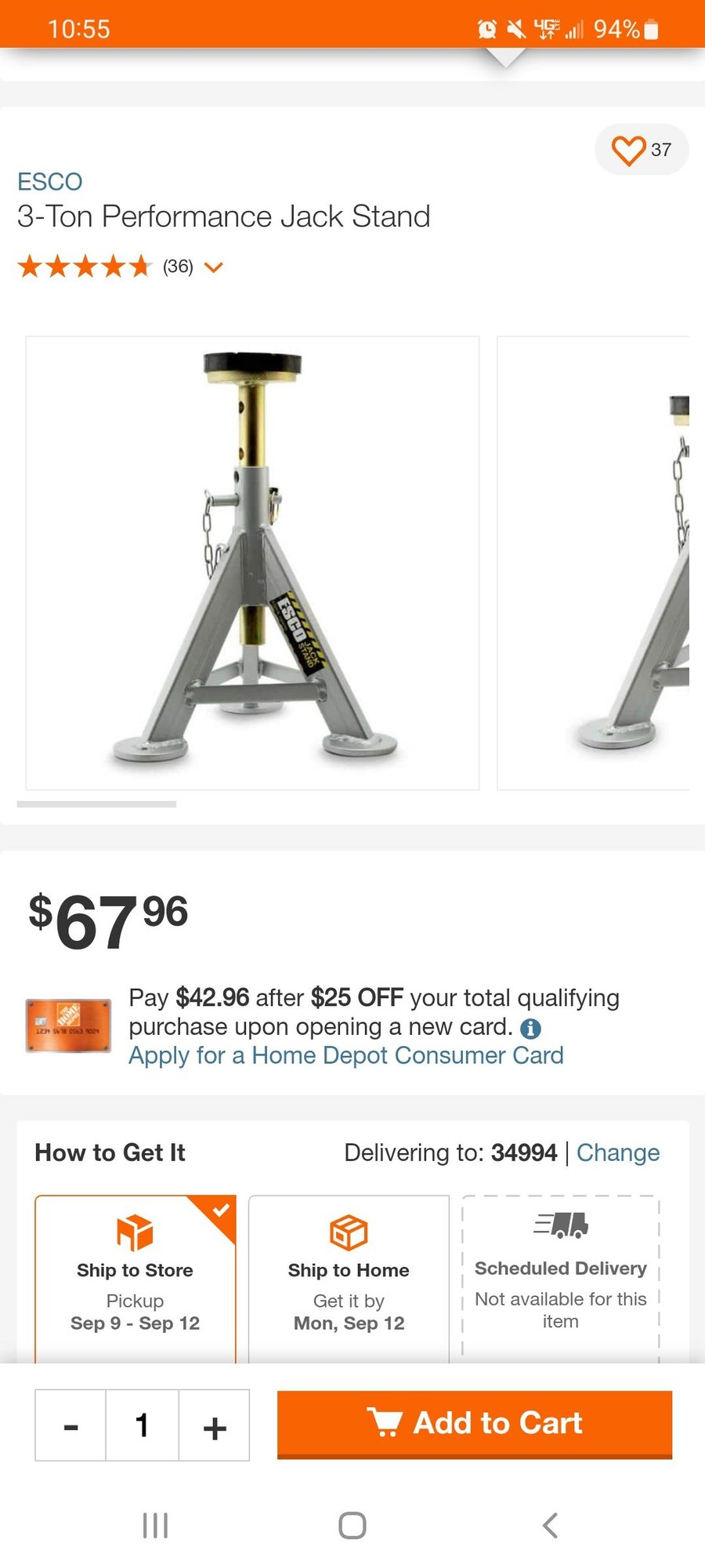

I lift from the opposite jack point then slide in a Esco stand under the side (front or rear) im working on then swap out as sides change.
Ill get Jack point jackstands when they come back in stock

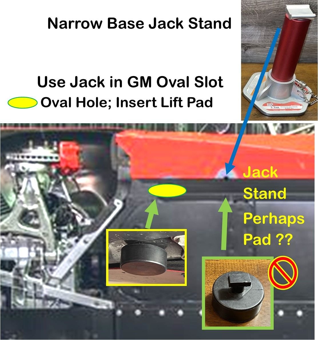

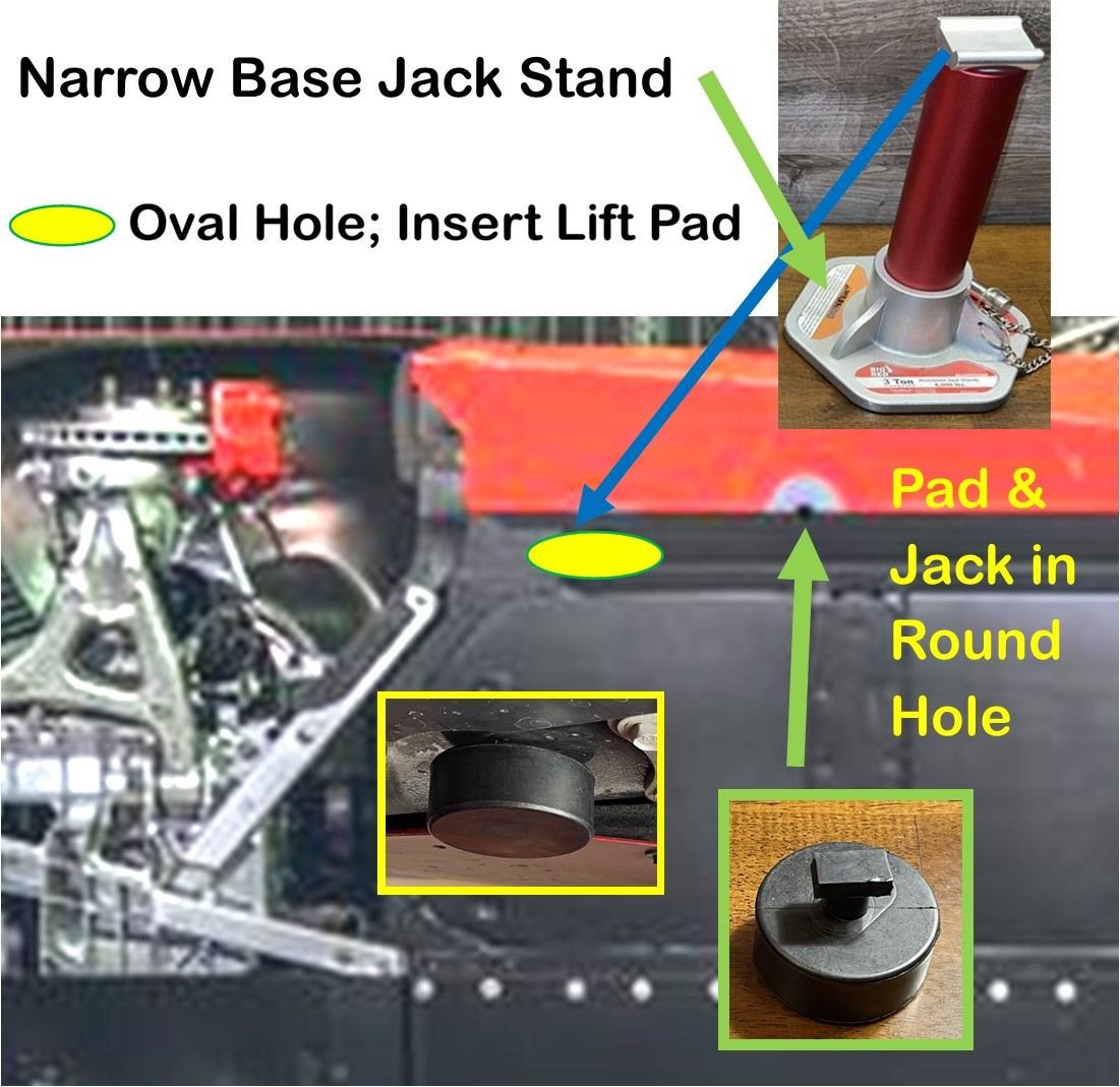

Bob Lebowski showed an interesting, inexpensive way he used to safely lift his C8 when changing his front brake pads and removing the calipers. He used a narrow base jack stand located at the GM oval lift hole. Removing the caliper requires a higher lift height than what I and some others did who changed pads with the calipers in place. All methods shown on my How Too PDF.
These are pics of what Bob did. Note he modified the tab on his jack pad to fit the round hole. No issue at all for the front with only 40% of the weight.
My inexpensive ($10) small jack stands (I bought to use under the lower ball joint) may work as well.
This would also work for the front AND if careful may work for the rear by placing the narrow base jack stand as close as possible to the jack lift point. Then no need to modify the jack pad.
There are two other devices folks advised they used when changing brake pads I included in my How Too PDF. They both 1st use a hydraulic jack to lift the car then insert the jack stand portion. The jack is then removed. Names are given in pics you can google and see a video, which makes operation clear.
