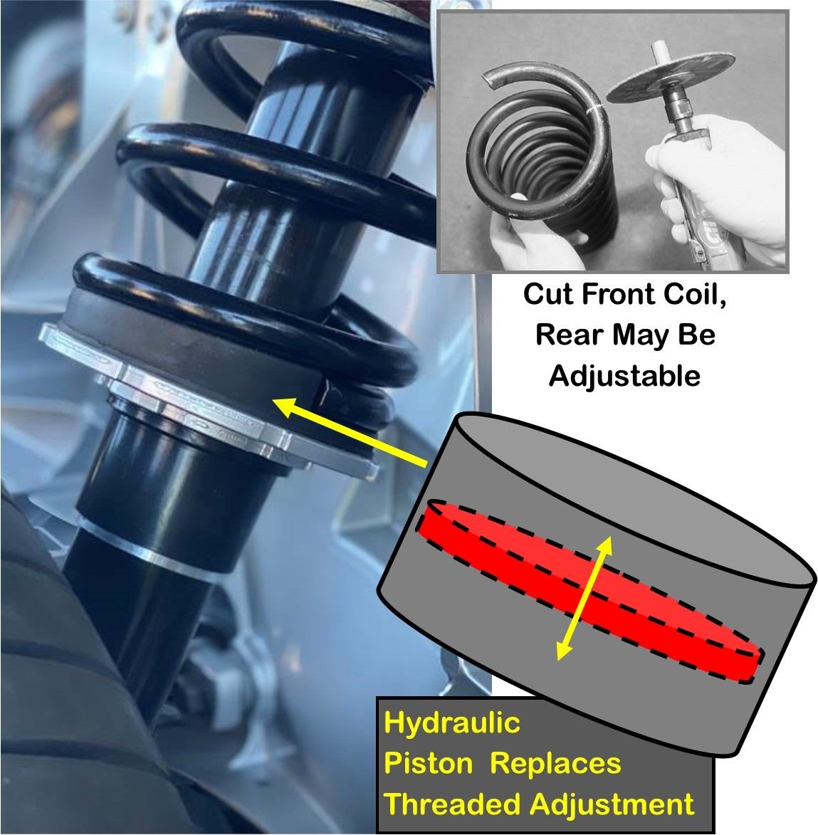

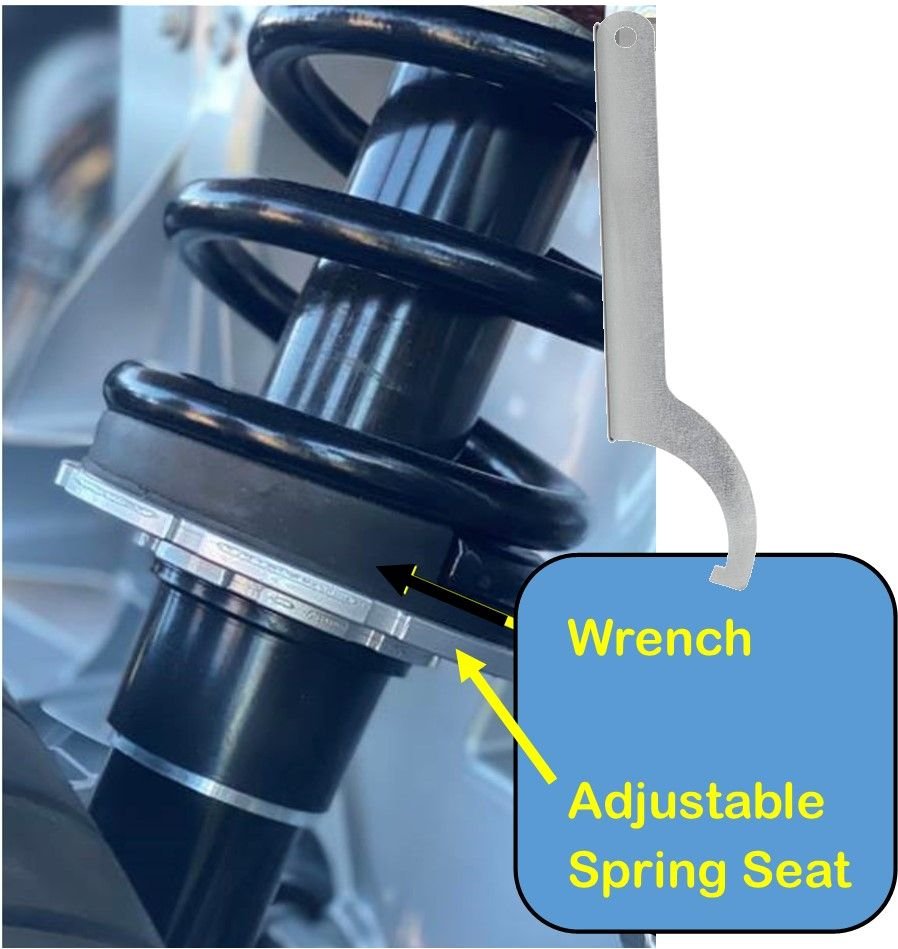

Originally Posted by GenVGuy
My 2022 C8 is equipped with Z51 and front lift adjustable height options. I would like to lower it 1" front and rear.
Does the car have adjustable oem lowering capability, and if so, how much can it be lowered front and rear?
if not, which is a better lowering choice, lowering springs (ie: Eibach), or less expensive lowering collars (ie: Paragon)?
Thank You.
Since you have the Lift Option, for the front you'll need paragon collars. The rear's can be adjusted with proper wrenches.
The front's have a hydraulic Lift cylinder that replaces the adjustable threaded section of the coilovers. You can use Paragon collars (best have a pro install who has done it successfully before.) Better than cutting springs! Most lower replacement springs are designed for Tracking, and are also stiffer, look carefully!
