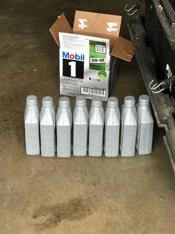

Had my first oil change today..Only had 2600 miles so I PAID for the change...$183 ,,,,,Wait till next year for the free bee....Everything went fine and cked. oil level when i got home and it was fine...Since the vette only takes 7.5 quarts I asked If i could have the 1/2 quart left over and they said fine...So If i get low I can add...They use quarts and had the supercar oil...
Only took an hour....
Ready for another year and plan on putting more miles on her
Very pleased with the experience..

So the dealer actually used 1 qt bottles for the change? Usually they meter the oil from a larger container such as a drum.
If that is what they are doing (from a drum), you probably aren't getting Mobil 1 0W-40 Supercar (or ESP - the prior name). You're most likely getting generic Dexos 2. Mine always uses bottles for the Vette - I can see exactly what they are using.

They might not be packaging the oil in bulk yet given a newer formula, but for a commercial unit like a dealer to be working individual 1 qt bottles makes the oil more expensive throughout the supply chain.

Most dealers don't service enough Corvettes to justify buying that particular oil in bulk. I have mine done at a Corvette Signature Dealer and they use bottles. For other vehicles, they use bulk.

That was the problem with my two C7's and why free was not worth the risk to me at the large Chevy/BMW/Mercedes dealer in town so I did my own. The usual Newbie tech working the Oil Change Bay (hard to find mechanics today and that job may be filled with a person flipping burgers the month before) may well use the oil in 55 gallon drums the boss bought from the Low Cost Supplier! There are many dexos 1 approved oils that are on the GM approved list. Some even blends NOT full synthetic!
In addition that Newbie tech, rather than fill the C7 (or C8) the proper way (per the C7 4 volume service manual and what I have been doing for ~70 by the oil level mark) might read what the service manual says is an ESTIMATE in a table. With the C7 and C8 have to heat the oil to 175 F to measure the level. Takes time.
Many working the oil change bay may NOT want to go to the parts department and lug 8 quarts of oil back to their work area. Just dial up whatever # is in a table and fill cold with whatever oil is in their work area! Easy to overfill!
Unlikely from drums unless it's a very large Vette dealer and IF Mobil supplies ESP 0W-40 or the latest acceptable oil for the C8 in drums.
Luckily found a small dealership with a great Corvette tech who is the only one who works on Vettes, oil changes etc. He filled my C8 from quart bottles of the right stuff. After the oil was @175F, he checked the dip stick twice!!

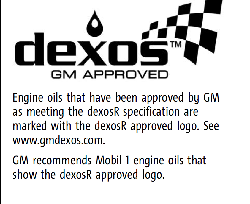

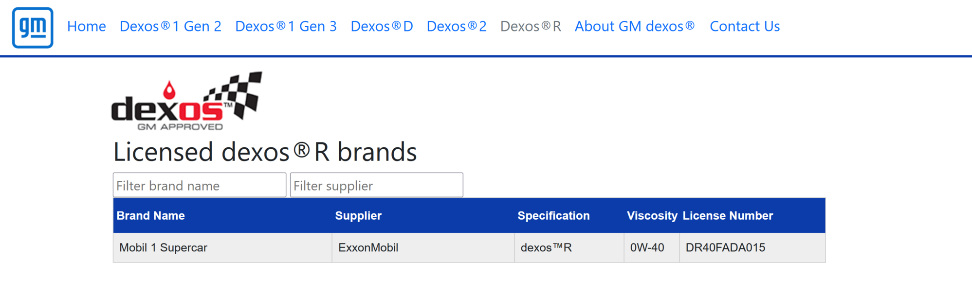

I noticed that the 2020-2022 Owners Manuals list the required oil as dexos2 approved, 0-40. The 2023 Owners Manual lists dexosR approved, 0-40. The manuals mention the www.gmdexos.com website. Looking there, it appear that the dexosR is the so called Supercar formula, and only one oil is licensed to meet that specification. On that same site, under dexos2, there are 4 oils licensed to meet that specification, one of them is Castrol, the others are Mobil 1 formulations.
DEXOS 2
DEXOS R
FROM THE 2023 MANUAL, PAGE 247 WHICH IS THE SECTION FOR THE LT2 ENGINE. THE Z06 SECTION ALSO RECOMMENDS DEXOS R IN A DIFFERENT VISCOSITY

Small point BUT "dexos" is a GM registered trademark for their spec test, that they charge oil companies to use! It's a small "d."
Being the one who managed our many trademarks and wrote to folks using Heliarc etc saying STOP, just thought I'd mention! BTW API and SAE also charge for oil companies to use their oil specs and for putting meets API XYZ etc on their containers.
I conjecture, BUT probably true, in ~2000 when Mobil sued Castrol for using the word "Synthetic" (for just a more highly refined, what folks call "dino oil" and lost (forcing them and others making truly synthetic oil to switch to the half cost to produced more highly refined "dino" oil) BOTH SAE and API supported Castrol. Because they wanted oil companies to use (and pay for) their specs! That occurred ~2000 before GM decided to create their OWN spec and charge oil companies as well! BET API and SAE never saw that coming!
