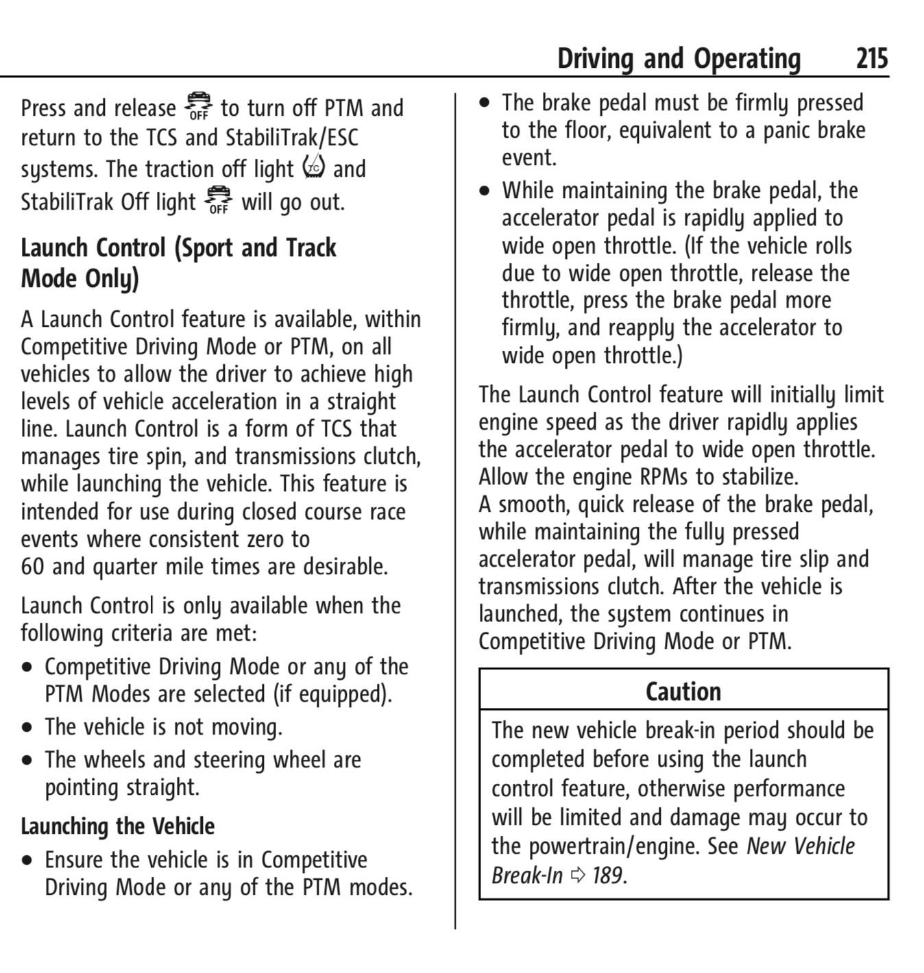

On your steering wheel, right push to Launch Mode. Press brake pedal hard and accelerate at the same time to 3500 rpm and release the brake.

The two button push to disable traction control is a push, wait for display to show TC off, then push again, see Competitive Mode. Then you're set. That's for a non-Z51 in Sport or Track, Z51 in Sport mode or non-MagRide. For Z51 with MagRide/PTM, you do different steps basically the same pushes in Track mode, but that enabled PTM, should be in PTM Sport or higher for launch control. There are plenty of videos on YouTube that show how to do it.
Old Sep 30, 2022 | 12:54 PM
gnt's Avatar
gnt
Junior Member
Joined: Sep 2019
Posts: 203
Likes: 100
From: DFW
USAF

For a Z51 car with Mag Ride out it in track mode. Keeping steering wheel straight you have to depress the brake very hard. Press until it does not go any further. Then fully depress the go peddle. Needs to be on the floor. The computer will limit your revs. Then just let go of the brake and let the car do the rest.
