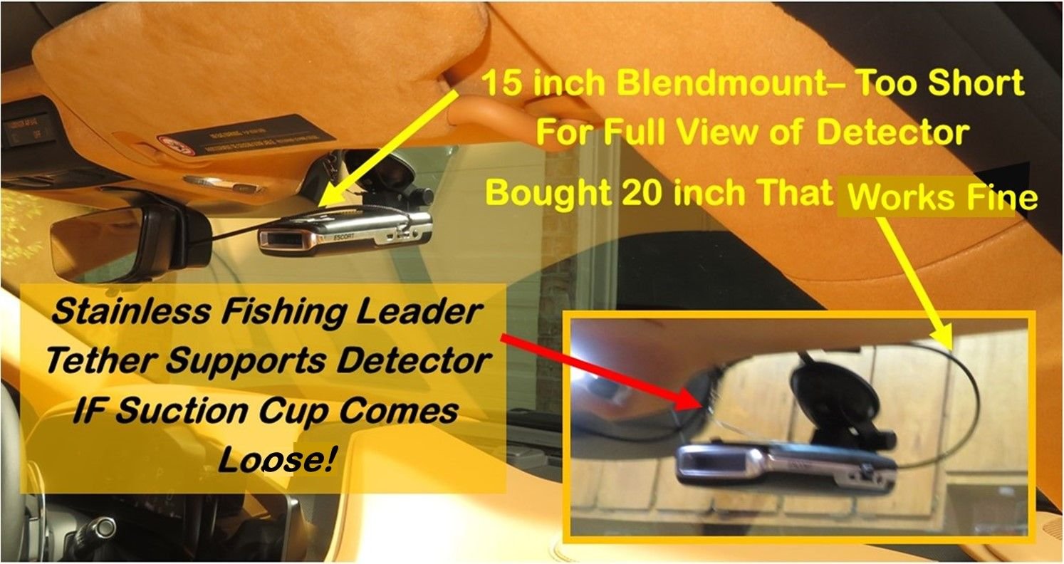

First Method: I tapped the rear-view mirror for power. No issues IF you use the Blendmount instructions. I also use their wiretap kit (better than cheap ones.) BUT like my two C7's don't like the detector hanging under the mirror so I use ESCORT "Sticky Mount" and had mounted high to right of the mirror. See pics and Blendmount wiring instructions.
Second Method: System shown worked fine for 2 years. Then had a TV Center Mirror issue (not related to the mirror tap.) Tech replaced the mirror, periodic failure still exists. So waiting for time to have the camera replaced (which hopefully will solve that issue.)
However, when installing the new mirror, Tech had to remove my wiretap. While waiting for the issue to be fixed I am using what I had before I installed the Bleadmount wiretap. The detector is mounted low on the windshield with the ESCORT supplied "Sticky Mount" and their power receptacle with coiled cord. I like the position!
So I will hard wire as shown schematically in pic below. Already have wired the right-angle plug. Those wires will mount in a 1/4 inch wide "D" molding with 3M tape under the passenger dash than hidden behind the dash molding and to the Detector.
Used this arrangement for 2 years.
Use this wiretap arrangement and all is fine with door mirrors.
BUT I like my temporary connection to the power receptacle under the passenger dash. To keep the permanent wires from interfering with the passenger's feet, bought a right-angle plug. Have already wired the Philmore No 48-785 right angle plug. Detector will now mount low on the windshield.
Will use a 1/4-inch wide rubber "D" molding with 3M tape backing to hold wires under the passenger dash (used it for my 2014 C7 radar detector install.)
