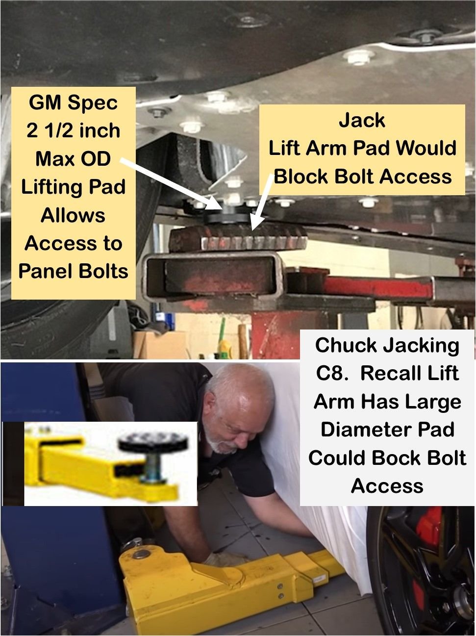

When I had my DCT Filter changed I had seen a video by Chuck the great tech where Rick Conti is a salesman. He said they had to lift a C8 several times using their large pads on their lift arms to get to the 4 outside bolts on the aluminum rear panel that have to be removed. Here are some pics and what my great tech was able to do with my jack pads on his lift arms!
The lower pic shows Chuck installing the pads on his lift arm on the frame. Chuck does many C8s so will do it right. The average Tech may not do many! Just so you can see how hard it is to position the arms try to SEE the oval slots on your C8 rear frame. You have to lay on the garage floor and put your head on the ground and use a flashlight! NOT easy. Note Chuck, from another video is doing it without looking! He's not going to put his head on the floor. Also note his pads are much larger then the GM recommended MAX 2 1/2 inch OD (which my 1 inch high pads .
(Note at the large Chevy/BMW/Mercedes dealer I use for my C6 and C7 I watched as a tech kick the center post lift arm with his foot to place in under a car (not a Vette!) Would you put your head on a shop floor to position the jack arm exactly where it should be placed??) If your jack pads are used in the GM oval slot no need. Tech can feel and place their jack arm pads under your Jack Pads properly positioned in the GM oval slots!
In top pic pic you can see the tech for my car used my Jack Pads and he was able to get the two bolts per side that are very close to the GM oval lift slits using a box wrench!
Bottom pic is Check installing his large lift arm pads on a Vette. In a video on changing the DCT filter he said a C8 had to be lifted several times repositioning the jack arm pads to get all 4 bolts! Assume they had to do the same to install!!
The aluminum panel that must be removed to access the DCT filter has two bolts on each side that are very close to the GM oval slot where the jack pads fit!
