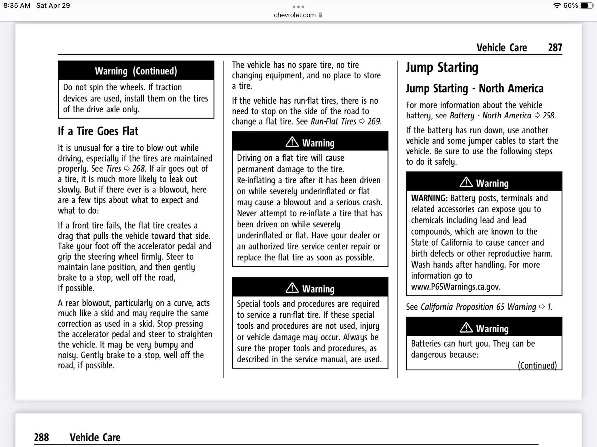

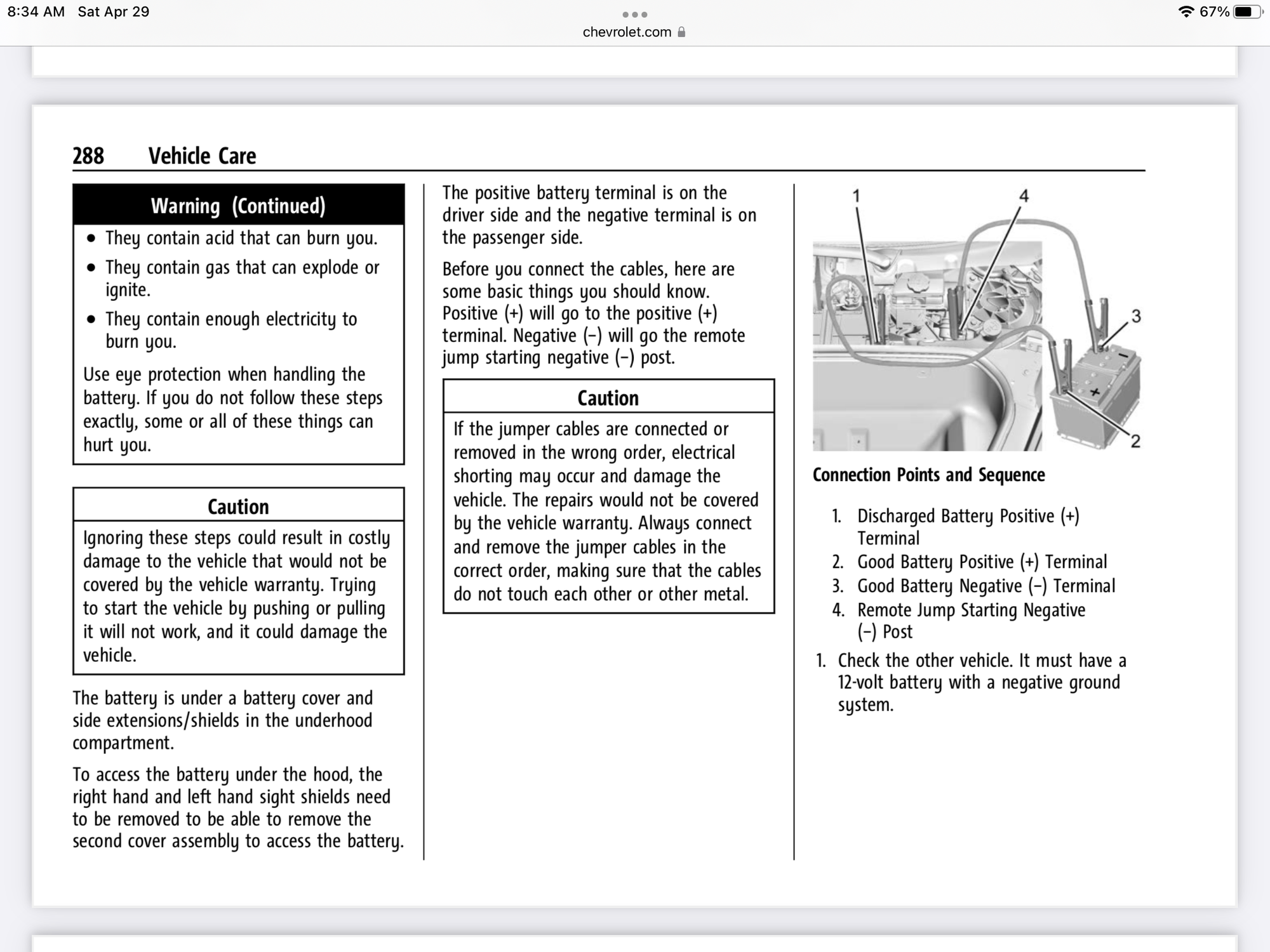

Originally Posted by 2024VETT
I remember seeing that picture and it is misleading. The instructions say to connect the cable to the remote jump starting negative post but I don't remember seeing one there (but perhaps there is). If not read carefully someone might think that the negative battery terminal is on your right when standing in front and jumping the car (which it isn't).
Yes, this picture is very misleading to someone that doesn't look at it correctly.
They could easily get the negative and positive reversed (mainly if they are color blind), there is a red cover on the positive side.
Still, it's a terrible picture.

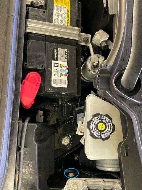

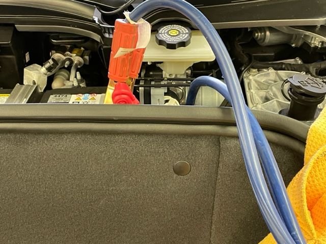

Hmm. The 2021 manual says connect directly to the discharged battery + and - terminals. On my 2021 there is no obvious post, but there are a couple of bolts to which the negative clamp could be connected. Here are some photos of what that looks like if one wants to try to avoid a connection to the negative terminal of the battery. I took these a while back when someone raised this issue before.
And yes, the system will relearn the state of charge after the car has sat off for four hours or so.
