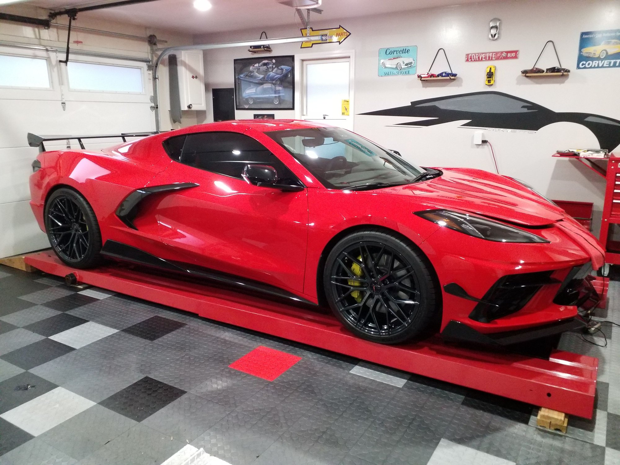

Yes, Anyone running wheels with a 30/40 offset will encounter slight rubbing of the stock size front tires on the splash guards especially if you have front lift. While it is probably the most aggressive offset for the C8, the issue is minor and can be addressed by modifying the front splash guards. They simply need to be trimmed to pull them closer to the liner. You will also need to add spacers to pull them back. While it's easily accomplished, some may find that this offset is NOT for them. The wheels are AG M520R , 19X8.5 @ 30MM and 20X11 @ 40MM. This combo pushes the wheels to their maximum limit, IMO while looking quite aggressive. With the modified, extended, GM splash guards, there is no rubbing. I have first hand knowledge. Here's some pics. Hope this helps! Or go with 35/45 or higher offset.

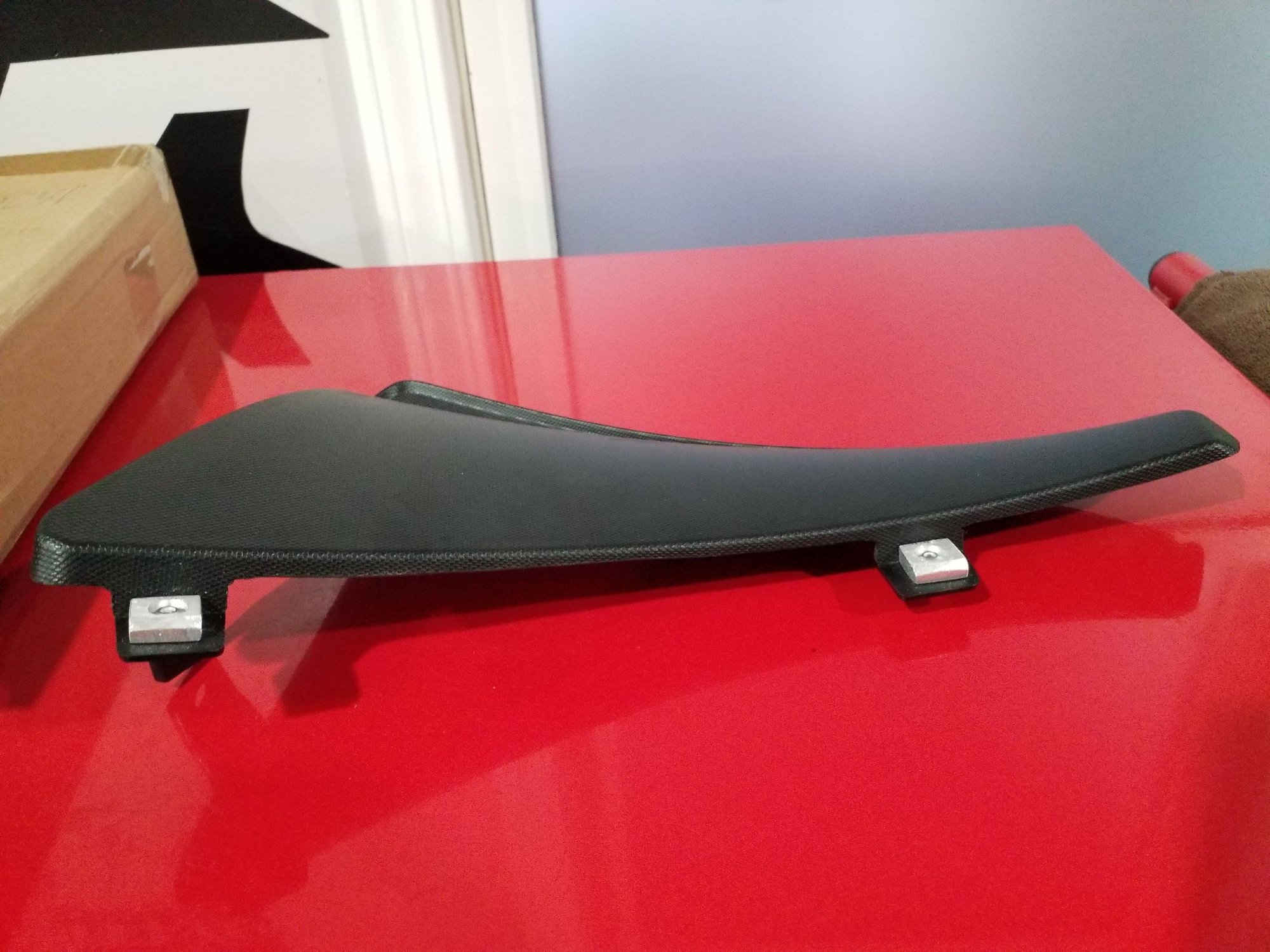

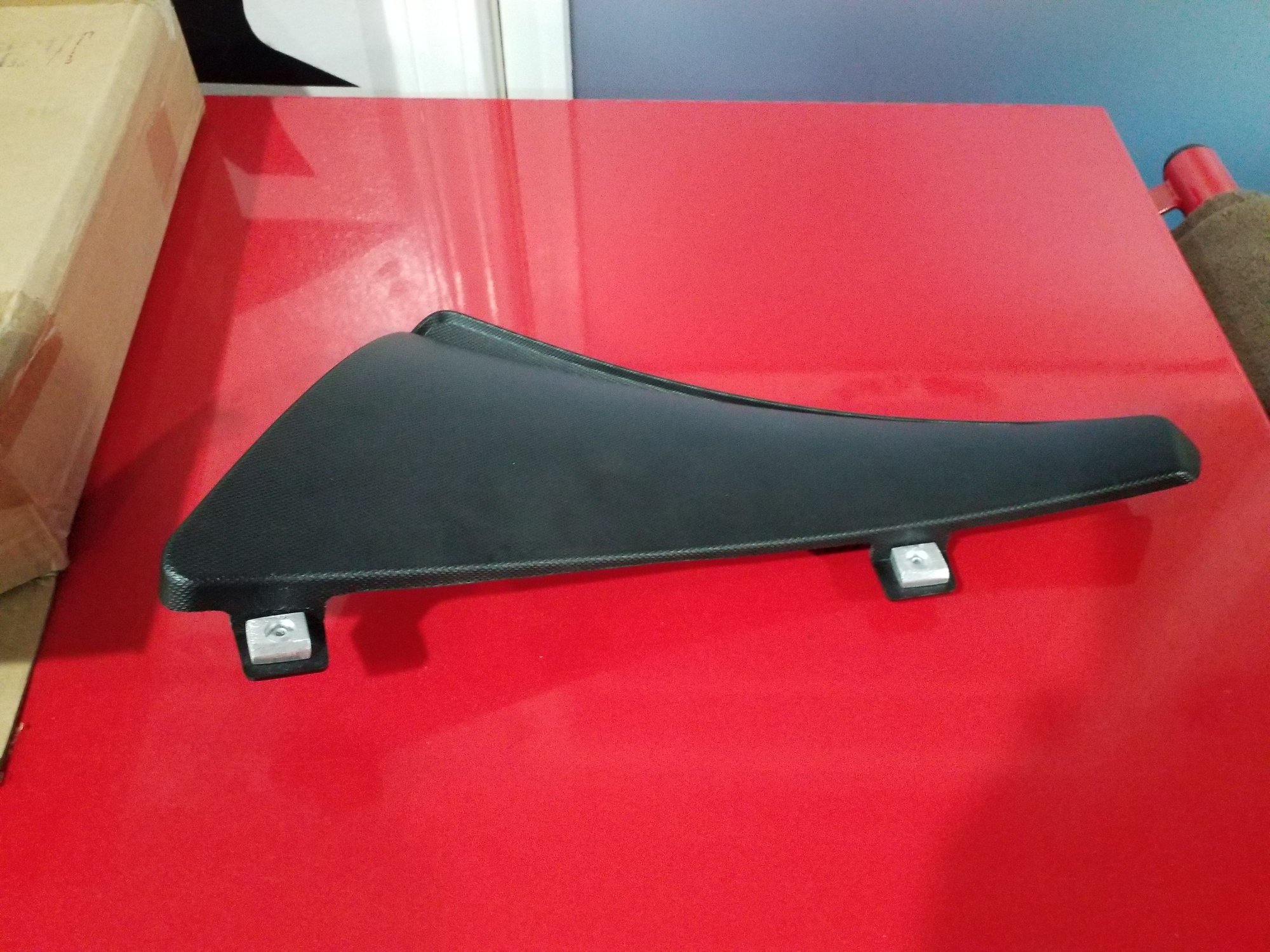

Pic of front splash guard with inner edge trimmed to pull them back. About a half inch is cut off/removed from the inner edge.
I fabricated some small aluminum 1/4" thick blocks and pop riveted them to the tabs. These block pull the guards back into the fender liner and compensate for the removed material. Along with the trimming of the edge, this mod retracts the guards enough to pull them away from the tires to avoid rubbing and provide the necessary clearance.

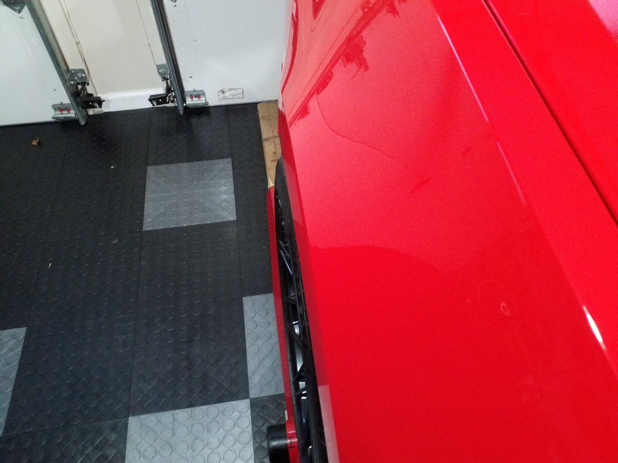

Front: No poke
Rear: No poke
Side view of my C8. Z51, mag ride, front lift, Paragon collars, lowered 3/4"...modded front splash guards, no rubbing issues!

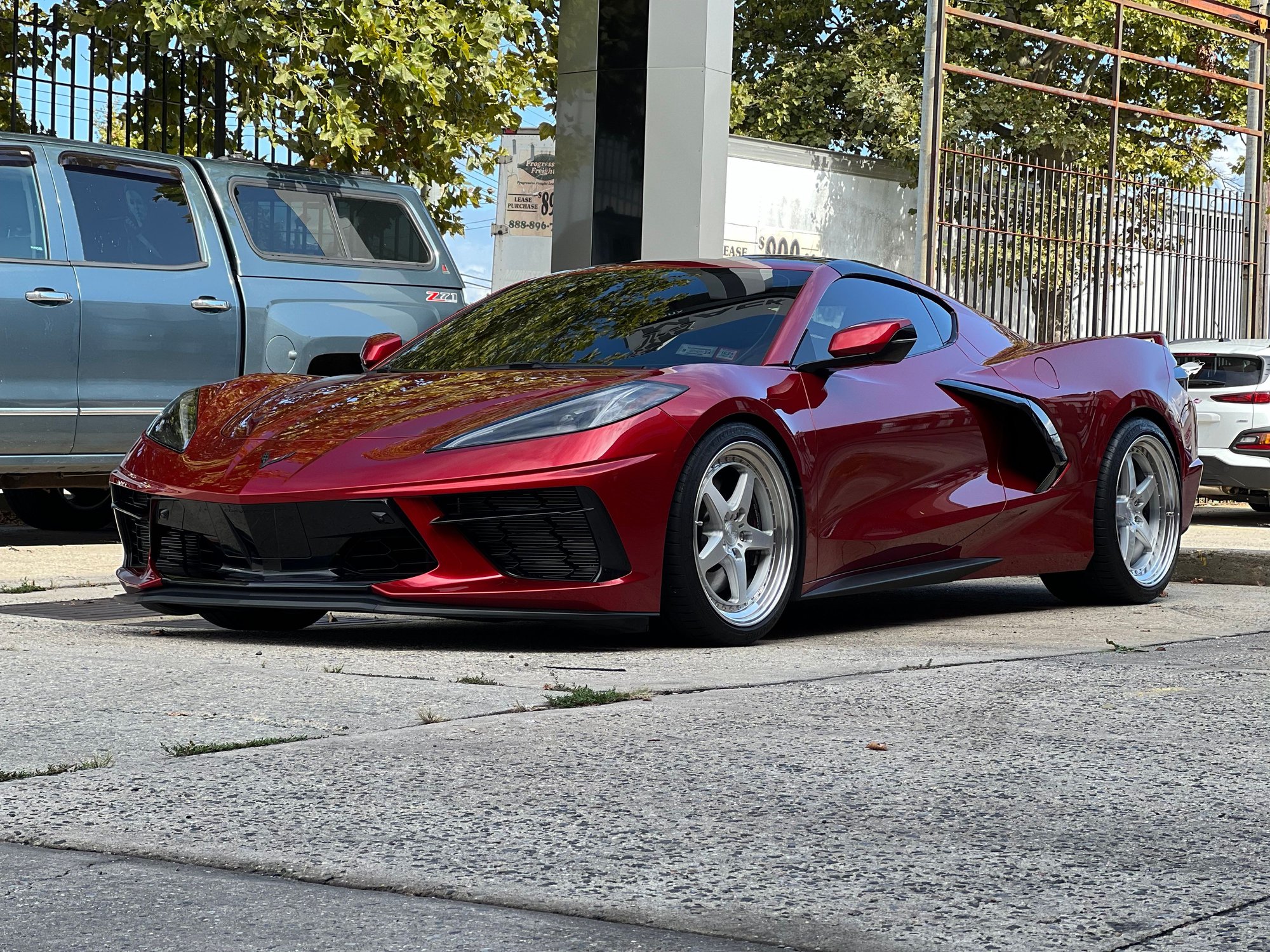

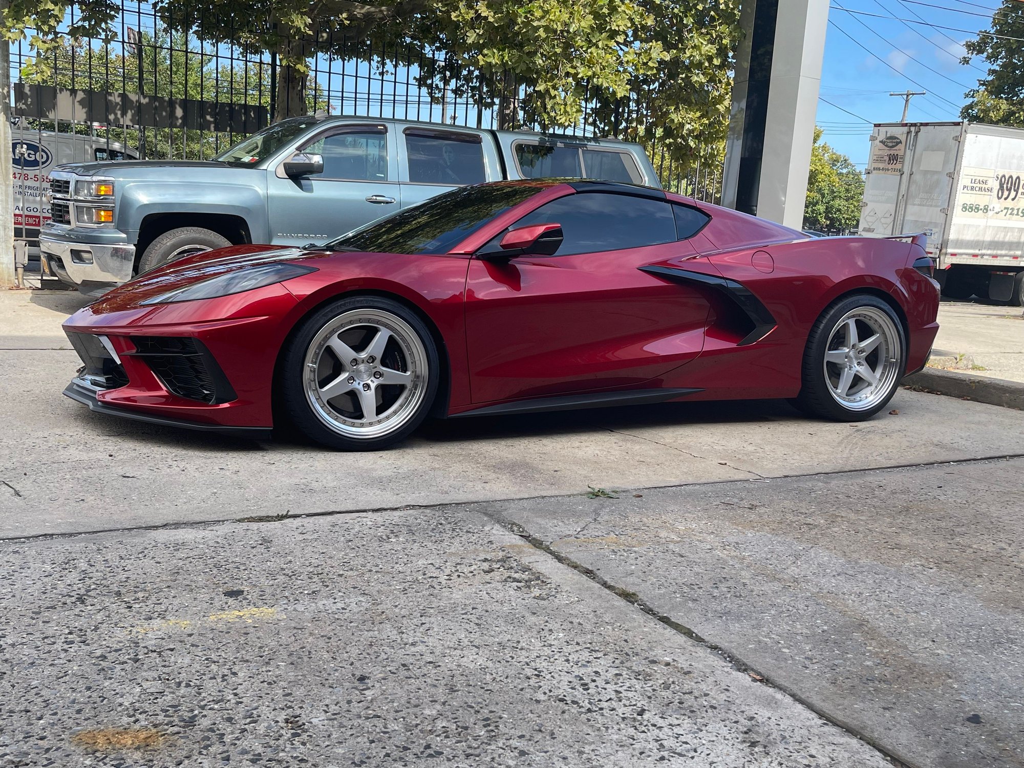

Velgen Wheels's Avatar
0Velgen Wheels
Former Vendor
Joined: Oct 2018
Posts: 137
Likes: 34
We run a 9 +32 | 12 +48 and it's super flush no rubbing at all.
Velgen SL-5
Velgen SL-5
