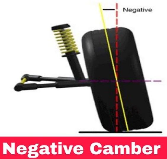

After you lower your car you will get Negative Camber and must get a Wheel Alignment !!

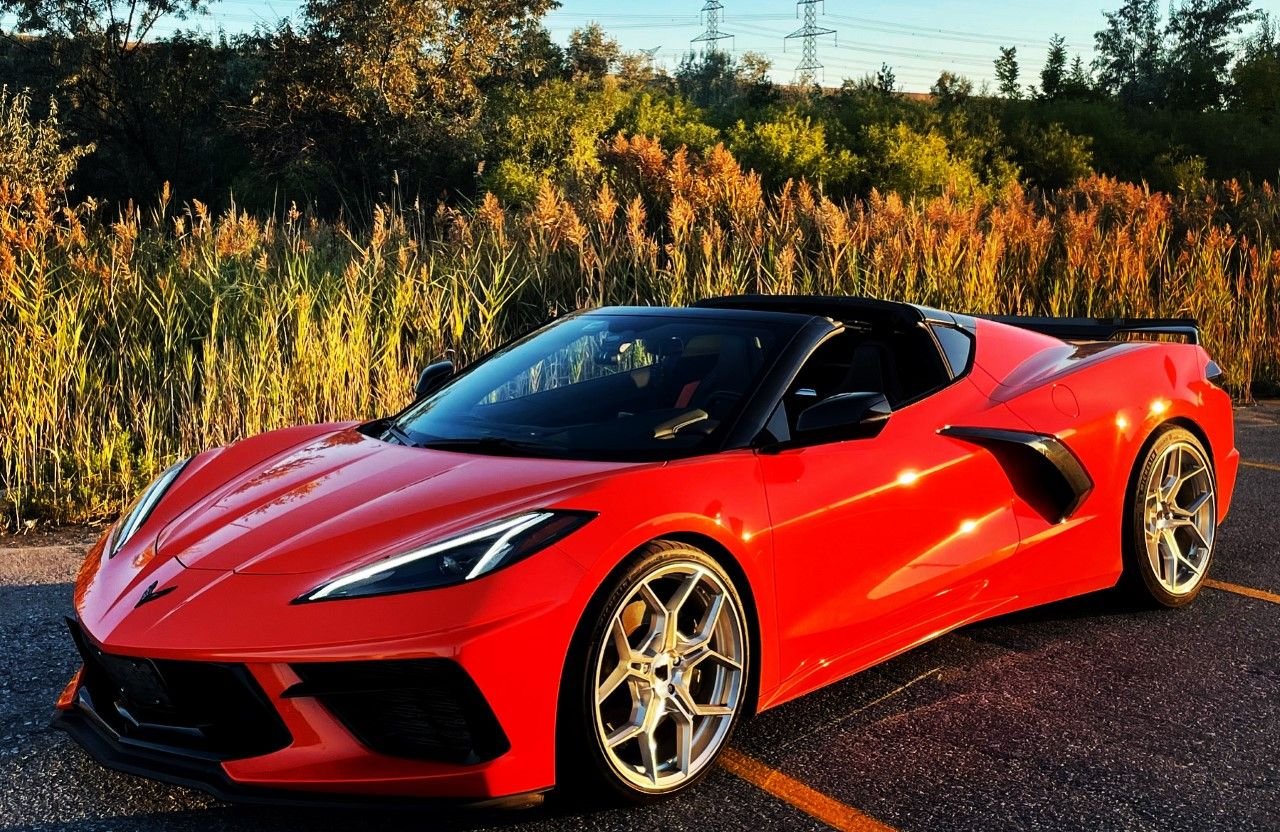

This is how the Z51 looks lowered all the way on factory coil overs. I did an alignment afterwards and the measurements were still within factory spec so It hardly changed.

And here it is on stock wheels with stock sized winter tires.
Thanks for sharing! Great to hear that the specs remained mostly the same. When you upgraded the wheels, did you stay with the stock 19/20 or go up in size?

I went to a 20" set up on all 4 corners. 20x9 fronts and 20x12 rears
Interesting. I'm about to get a 23 soon and have been looking into lowering it. This picture is simply adjusting the factory Z51 suspension with no additional alterations? Perfect drop
Yes sir, the only mod was adjusting the factory coils.
