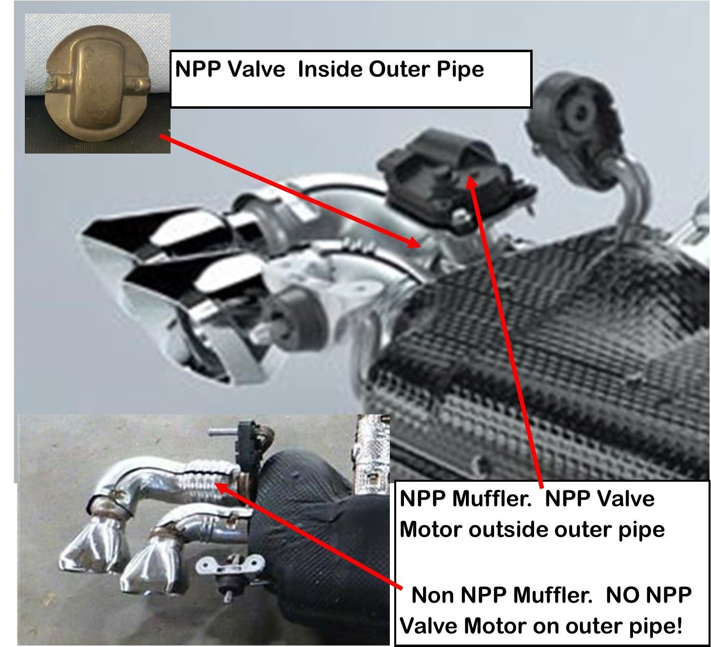

The NPP exhaust has a valve by the muffler on the tube to the outer tip. You'll have to look from underneath to see it.
If you have the VIN you can use a VIN decoder.

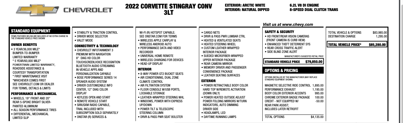

A VIN Decoder will not tell you if a non-Z51 has NPP or not. However, it will be on the window sticker. There are a number of sites on the internet where you can use the VIN to acquire a window sticker. Most require payment of some sort, and some may not be trustworthy. The easiest way is to ask a dealer to look it up for you.
I'm not sure I'd trust the seller, but if you have an opportunity to hear the car running, you can turn the mode selection dial from Tour to Track, and you will hear a noticeable increase in volume even at idle if it has NPP.

For a car on a lot, reach up from under a rear corner and "Feel" if the outer exhaust pipe near the muffler has an NPP valve actuator. Suggest ONLY if the car has not been running!

This worked for me to get the window sticker on our non-Z51 w/NPP. See the "Options & Pricing" section, and you will see "Performance Exhaust."
Copy and paste the last link in quotes in post #1 (minus quotes) into your browser, and type in the VIN to replace the words "your VIN goes here." The hotlink in that post does not work.
