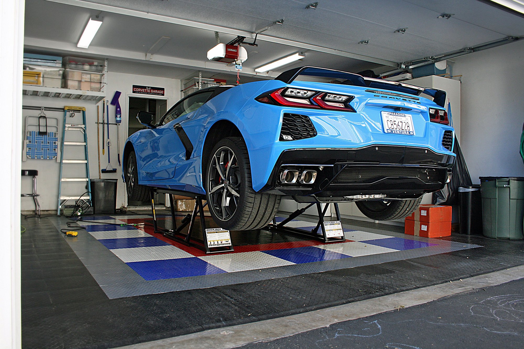

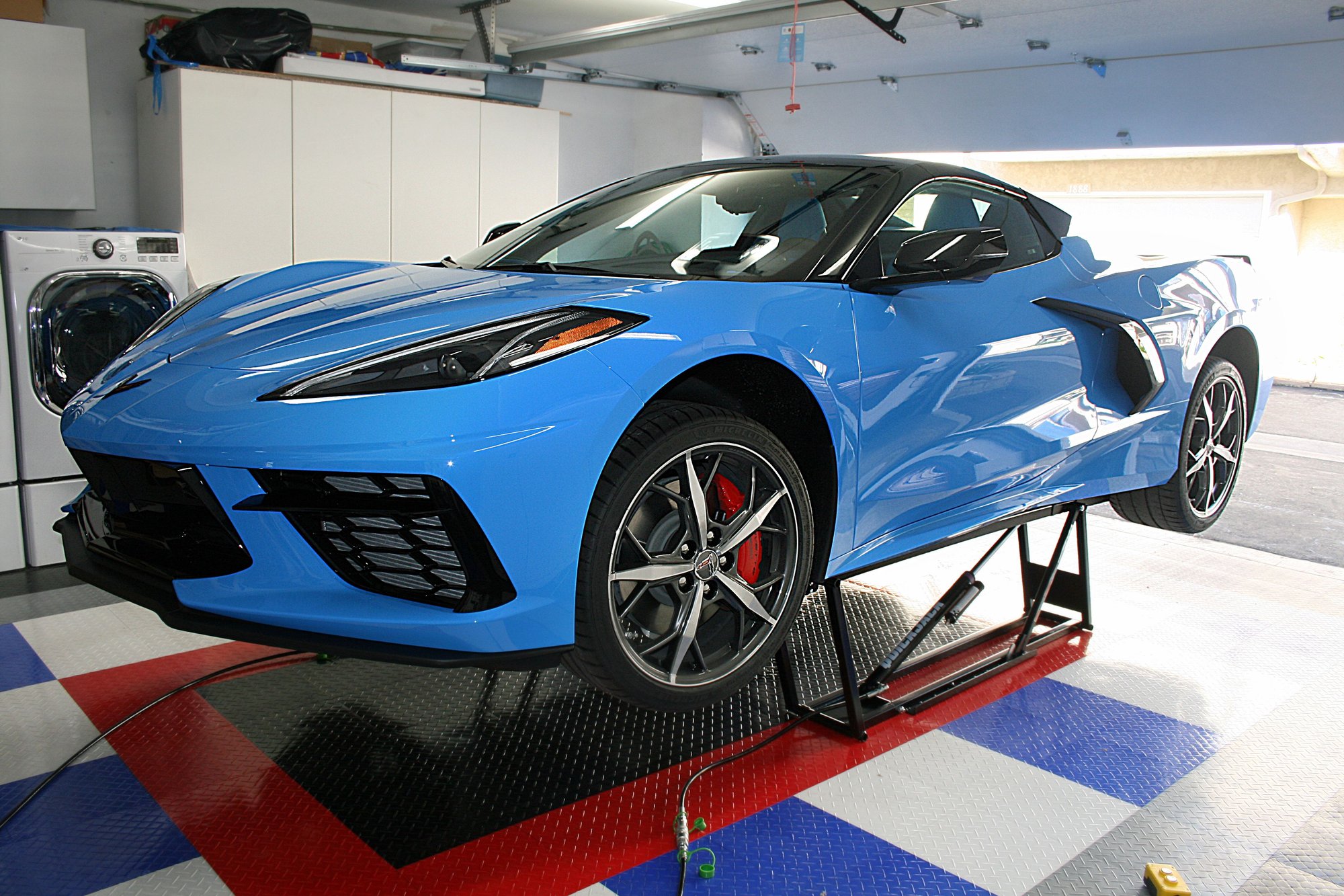

The TLX series (5000 or 7000) are the only ones that will reach the recommended lift points. The QuickJack comes with two sets of rubber pads - short & tall - to put between the jack surface and the jacking puck. My C8 is lowered 3/4" and I use the shorter set with Paragon permanent jack pucks. Works great.
