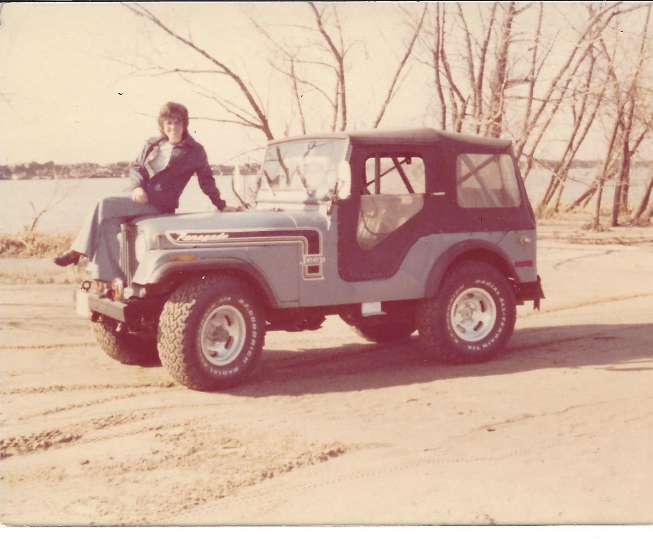

My CJ5 Jeep aluminum wheels were as strong as hell and took a lot of abuse offroading. They were just heavy! Note cast aluminum, unlike cast iron is not brittle.
