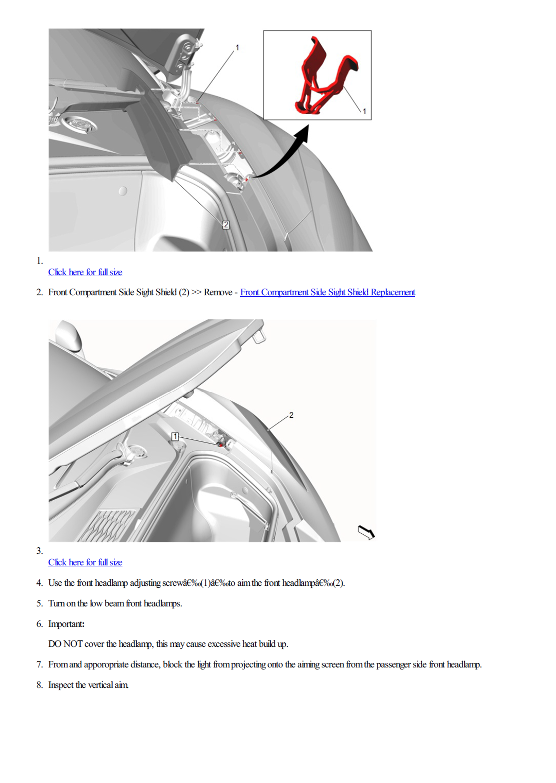

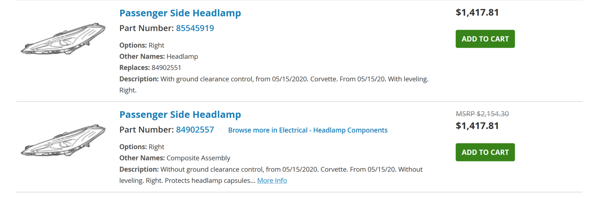

The headlamp assemblies also have internal leveling. The clip below from the bulletin that introduced corvette in 2020 (its in the stickies) mentions it, and it appears in the Service Manual. The parts list info for it seems to indicate that the headlamps with leveling are used on cars with "ground clearance control" which is the front lift system.

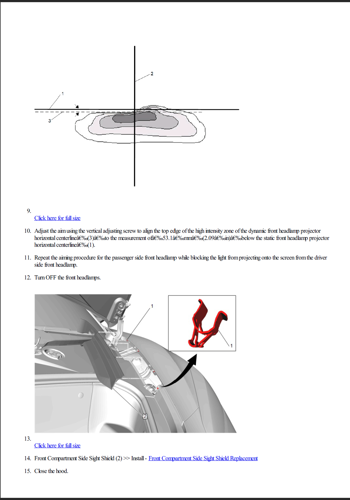

I have never done it but here is the procedure.
