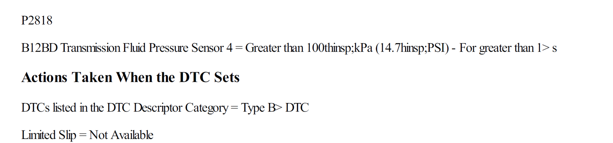

I found this in the 2020 Service Manual.

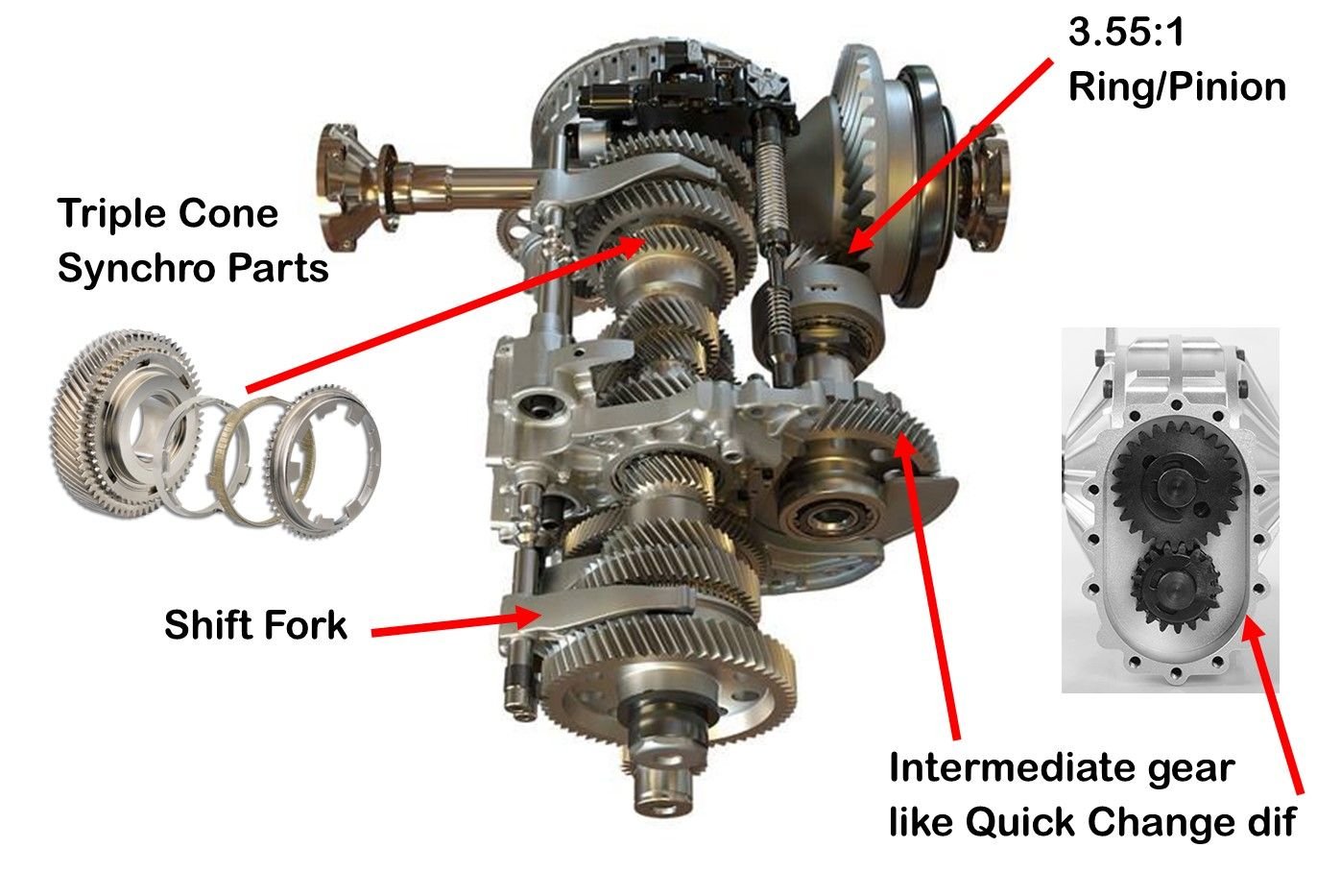

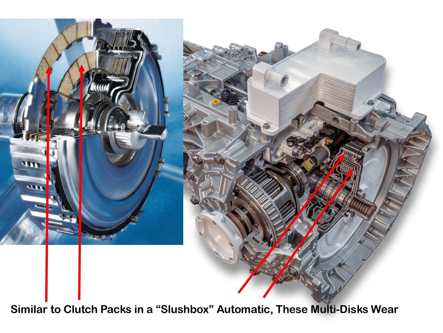

Would not be beneficial, IMO until there was some initial wear on particularly the 1st gear clutch plates. I'll explain:
From my observation that is one reason I changed the DCT filter year one with ~3000 miles with OLM showing 5% oil life left, was a slight jerky motion when going very slow up to about 1000 miles
When I pull into my garage I creep as I watch the driver's mirror tip to door wood molding. I keep it at 1 to 2 inch max. That assurers the harder to judge passenger mirror clears. Below ~5 mph the 1st gear clutch MUST slip. Like my prior 5 standard shift Vettes if I didn't modulate the clutch car would stall! After ~1000 miles that jerkiness stopped and like now at 8,000 miles it's perfectly smooth. I attribute that to a high break-in wear of those multiple clutch disks.
Just a SWAG (Scientific Wild *** Guess) but a reasonable assumption. So you need some time on the DCT to get the clutch plates, shifting forks, Synchro cones, gears etc to wear-in.
The DCT is designed to slip with low pressure even when the car is stopped. It does not go into neutral. So that 1st gear clutch gets lots of initial wear. Would appear to me, waiting a minimum of ~1500 miles before a flush is logical. I waited until my 1st engine oil change at ~3000 miles. BUT GM says even if changing the DCT filter early also change at 7500 miles as wear-in continues. I expect as most wear it's high initially and tapers off with time. BUT I will change the DCT filter again when ALL DCT oil MUST be changed year 3 minimum.
The DCT is basically two 4 sped transmissions that have shift forks, Synchro cones, gears including the dif pinion and ring gear. Instead of rowing a stick, hydraulic actuators move the parts controlled by a computer. Lots of valves controlling the actuators. Wear debris can clog the valves. Probably the biggest benefit of a flush in back flushing those valves. Fortunately the DCT has many seniors that check the position of all those gears and shift folks BEFORE it switches from one clutch that operates one 4 speed to the next.
