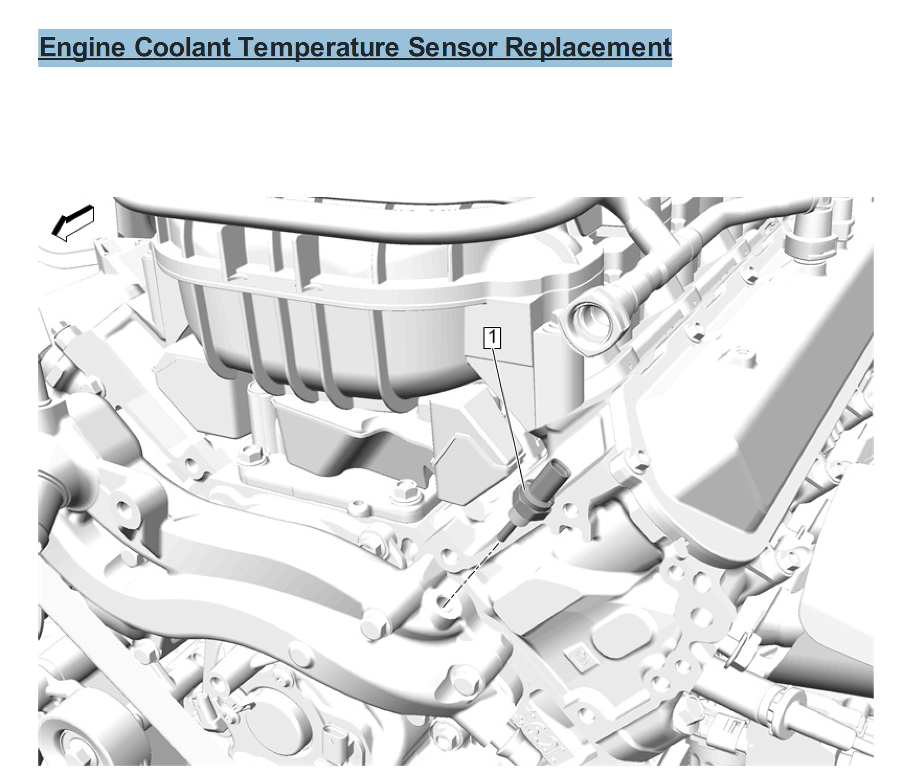

I know. That's why I mentioned I have seen it on other cars. I have not driven my C8 so much in cold weather and have not noticed it. In fact, what I notice, and what other have often reported, is that it does not warm up so much at all. Some have difficulty getting to the temperature that is "recommended" for checking the oil. Anyway, here is the temperature gauge (is that on point since you asked about it?). Its not actually in the block casting. In case that part is not easy to recognize, its on the water pump.

Thanks.
I was planned to look for the sensor location. It makes a little more sense now. It's in the water pump casting so the question is is it reading the coolant temp inflow or outflow from the engine. Must be inflow because the rapid change I am seeing. The old engines had the sensor in the cylinder head, which didn't change as much. I live in central Texas and during the summer, the day time temp is near 100°, so I never noticed the temp swings I see now when the ambient is 40° lower.

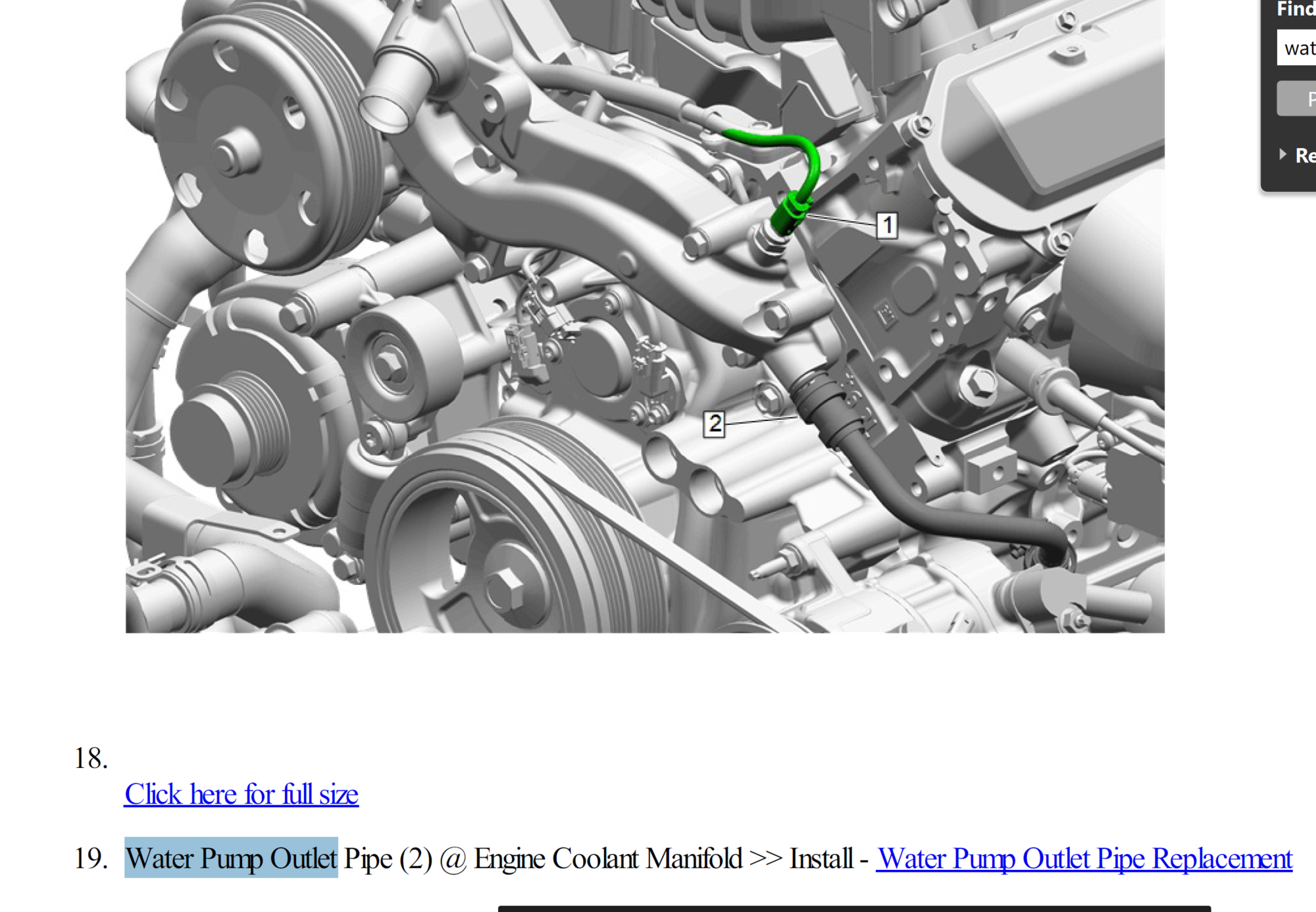

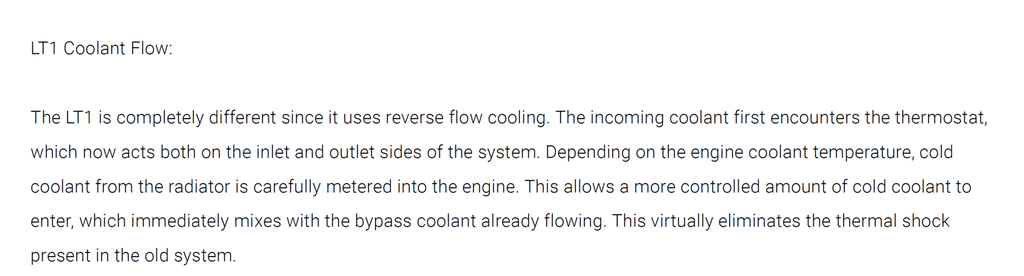

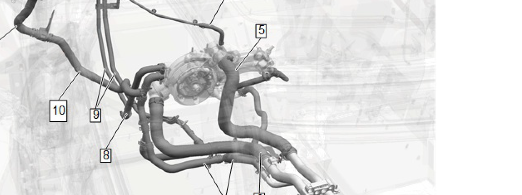

Well, check these images out, that show that the water pump inlet is where thermostat is located. The area where the temperature sensor is located is called and outlet. Seem backward? I found an article (off point I suppose) that the LT1 engine did in fact have what is called reverse flow cooling. I did not find anything about the LT2, that we have, but this info in the Service Manual for 2020 Corvette appears consistent with this design. I also attached a clip about the reverse flow cooling. To me it seem relevant to what you are observing. (I agree on wanting to hear what others are actually seeing, as I have not seen it with my car).
WATER PUMP INLET
WATER PUMP OUTLET AT ENGINE COOLANT MANIFOLD (WHICH LOOKS LIKE PART OF THE WATER PUMP CASTING)

Excellent! I guess I’m just going to have to accept the 20 degree coolant swings.
