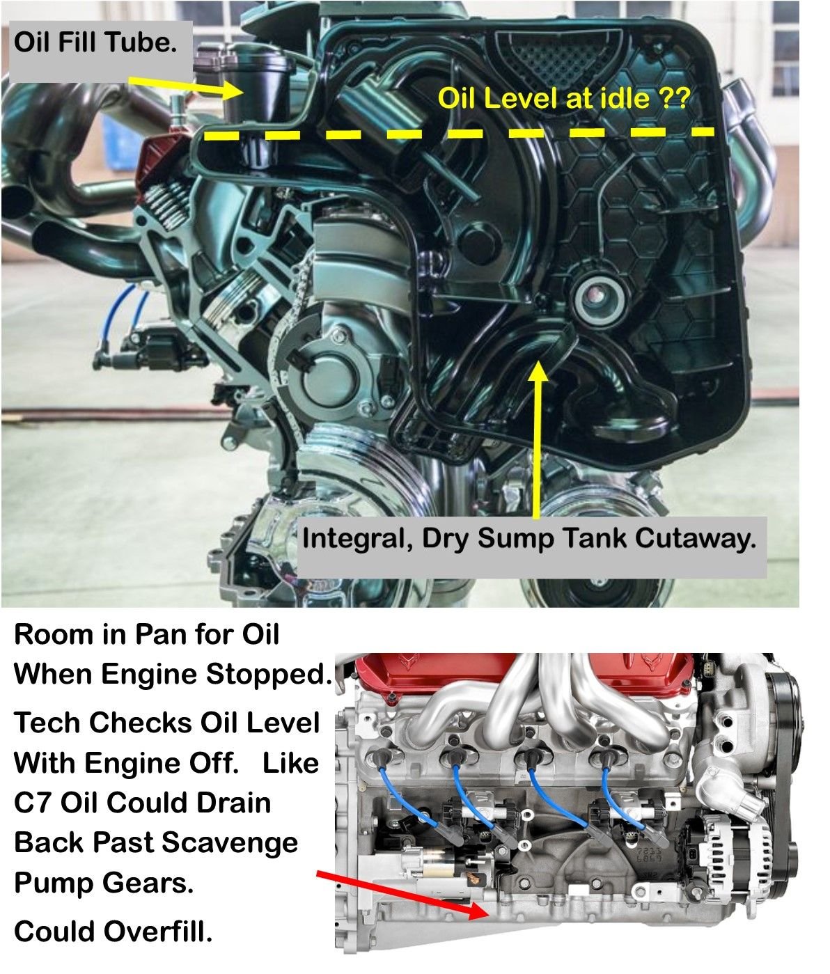

Don't know exactly where the max oil level is BUT it's close to there the fill tube is located. Yep would expect some oil would come "spit" out with the engine running as it's being pumped from the engine sump etc with lots of air from the scavenge pumps.
As has been noted by others, best to wait until it says add (which I suspect is like the C7 dry sump which was when it was one full quart) and add if needed with the engine off! NO reason to try to keep it at the MAX level. And that is the proper word "Max" not "Oil Should be at Level."
