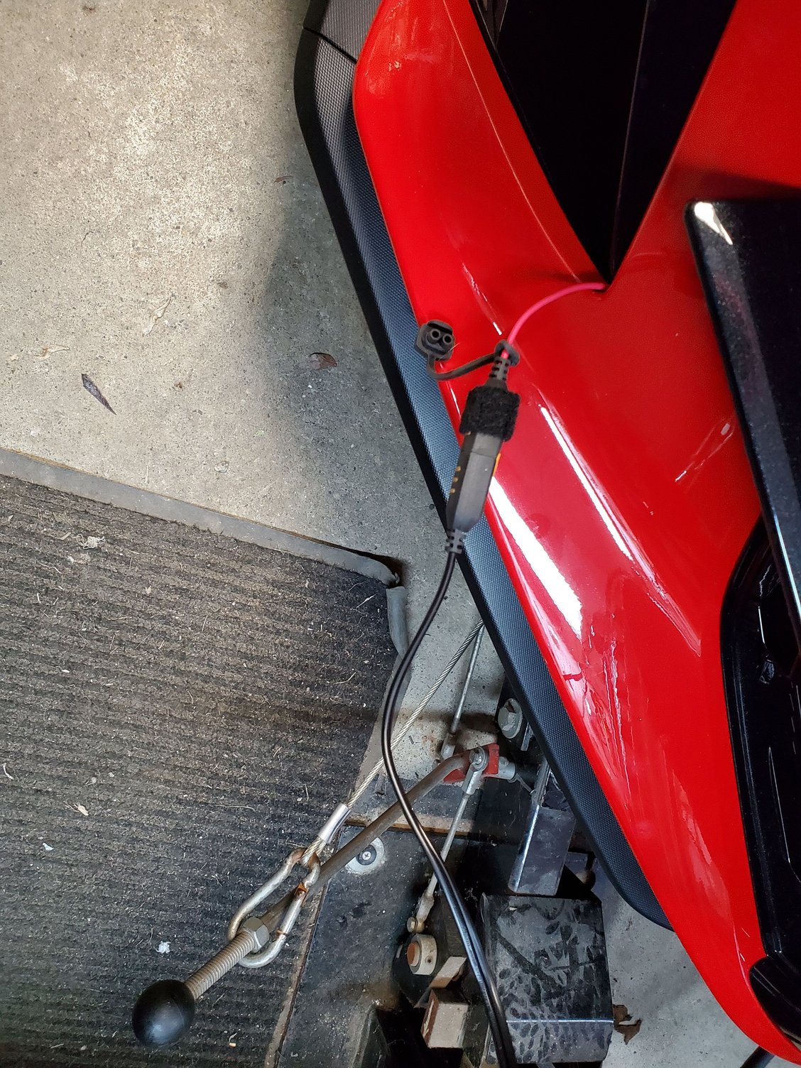

I ran it down to the brake cooler duct in the front. Works for me.
i can see it entering the duct, where does it go after that in order to get to the frunk power port?
I didn't go to the power port. If you remove all of the plastic covers to the battery I ran the Ctek extension directly to the battery. Snap the covers back on and you can't see the wire. Wrapped the plug with velcro and it sticks inside the duct when not in use.
That's what I'm looking for. Nice job and thank you!
