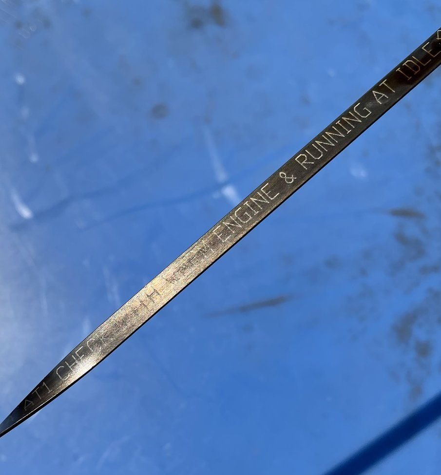

Says right on the dipstick how to check the oil.
CHECK WITH WARM ENGINE & RUNNING AT IDLE

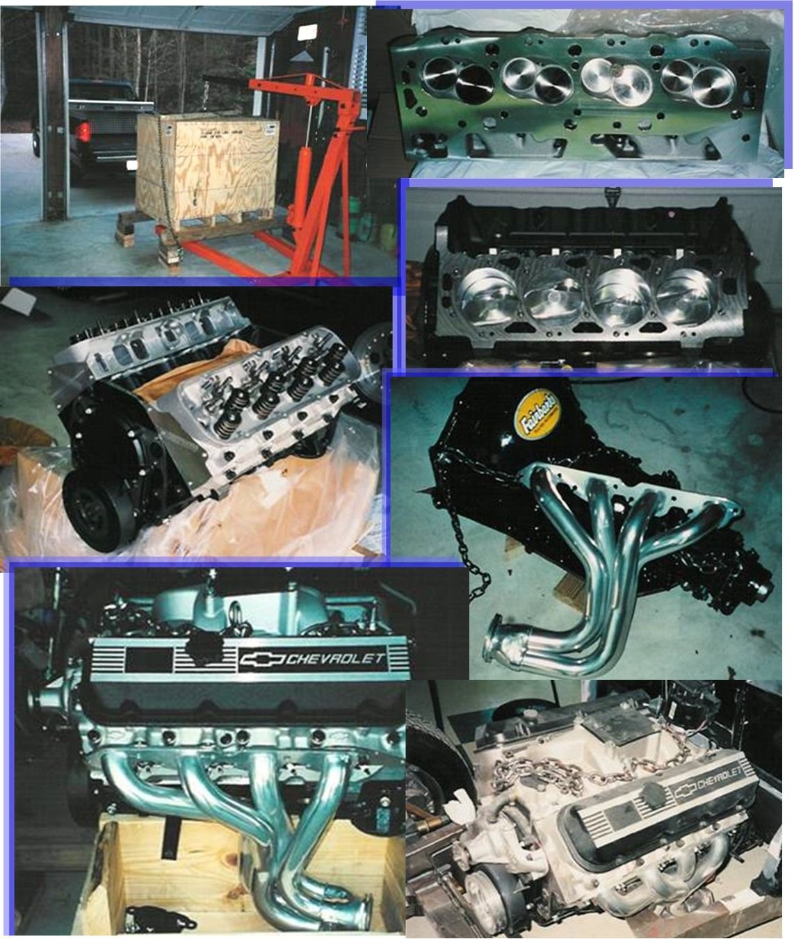

Just to reinforce it's the oil level that is important NOT volume, I had a "Catch 22" with my 8.2 Liter street rod engine.
SIDEBAR
I assembled the engine that came in a large wood crate with some 30 boxes. Not really hard as the bottom end was assembled. That is done in Mercury Marine who use the large cid engines in boats. In fact the ZZ502 I bought comes with aluminum CNC ported heads and matching CNC ported manifold in boxes. Although they is a cast in Chevy they are produced by Edelbrock the hot rod company.
Had not looked at the start-up procedure until the engine was in the car. At that time the long tube headers were installed. Was looking to see how many quarts of oil were needed. All the instructions said was fill to the line on the dip stick. BUT the dip stick and tube had come in a box and I never installed since it did not fit with the headers. I had bought a flush mount billet aluminum system that came with a nylon dip stick, Those instructions said cut the nylon end that is held in the billet aluminum **** with two set screws to the fill mark is located where the oil is at the max line!
Catch 22, hod no volume to fill with and the dip stick I bought said cut the **** end so it's at the max oil fill line! I had to measure how far the dip stick stock out of the long metal supplied tube and cut the Nylon dip stick to match that measurement!
Then considered this engine is used in boats, probably with a different pan and capacity is different. I addition it's a stamped sheet metal pan and volume could vary! It's the oil level that is key in this like other wet sumps. It has an oil baffle louvered tray (called a windage tray) as most high performance engines. That helps keep the spinning crank and rod from hitting the oil causing windage loses.
GM Crate ZZ502 came unassembled in a large wood crate. Metal dip stick tube and di stick did not fit with the long tube headers.
