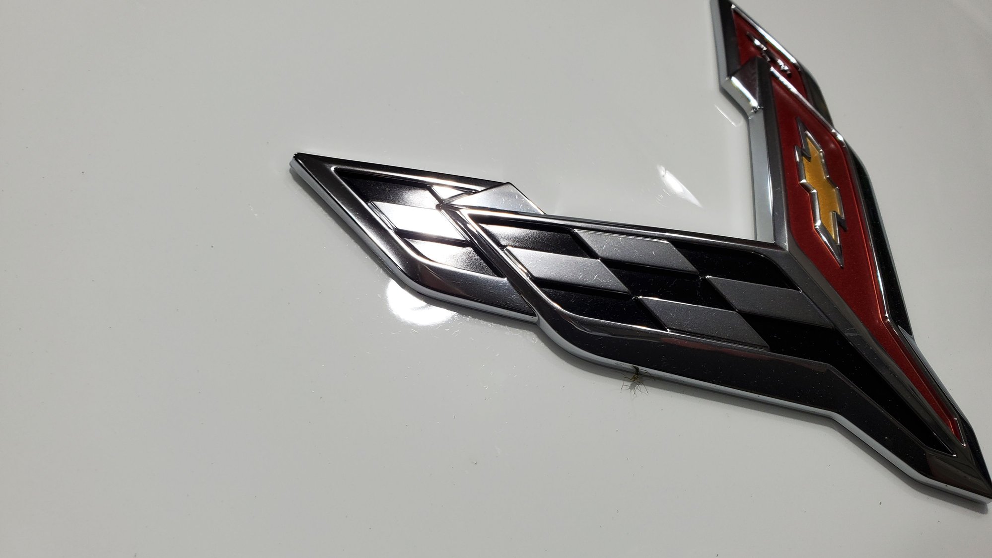

My emblem was removed and replaced on the PPF. Otherwise, every edgeline will attract and show dirt, especially in such a high-profile location. Here's an after picture photo bombed by a mosquito.

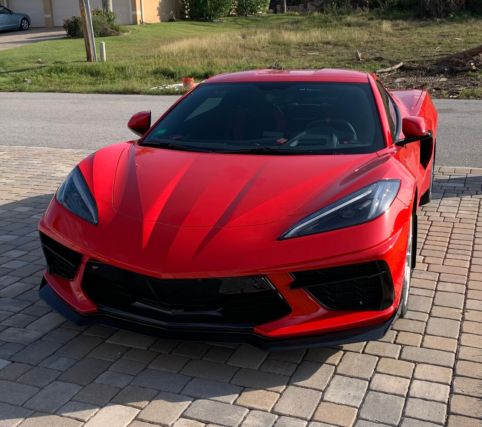

You expressed my thoughts exactly. And without the emblem the lines on the hood stand out much more.
