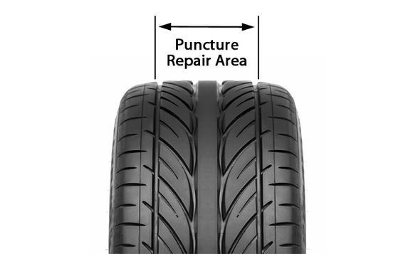

I've had 2 in 10 months, 600 miles. 1 new tire, 1 patch. If screw is outside of the first groove, it is new tire time. Inside toward center, patch. Aside from the cost, no big deal, it is still a Game Changer that looks great even with a flat tire.​​​​​​​

I posted this image previously in another thread of where you may and may not repair tires. Allowable inside first groove, else R&R if outside on outer 1-2".
