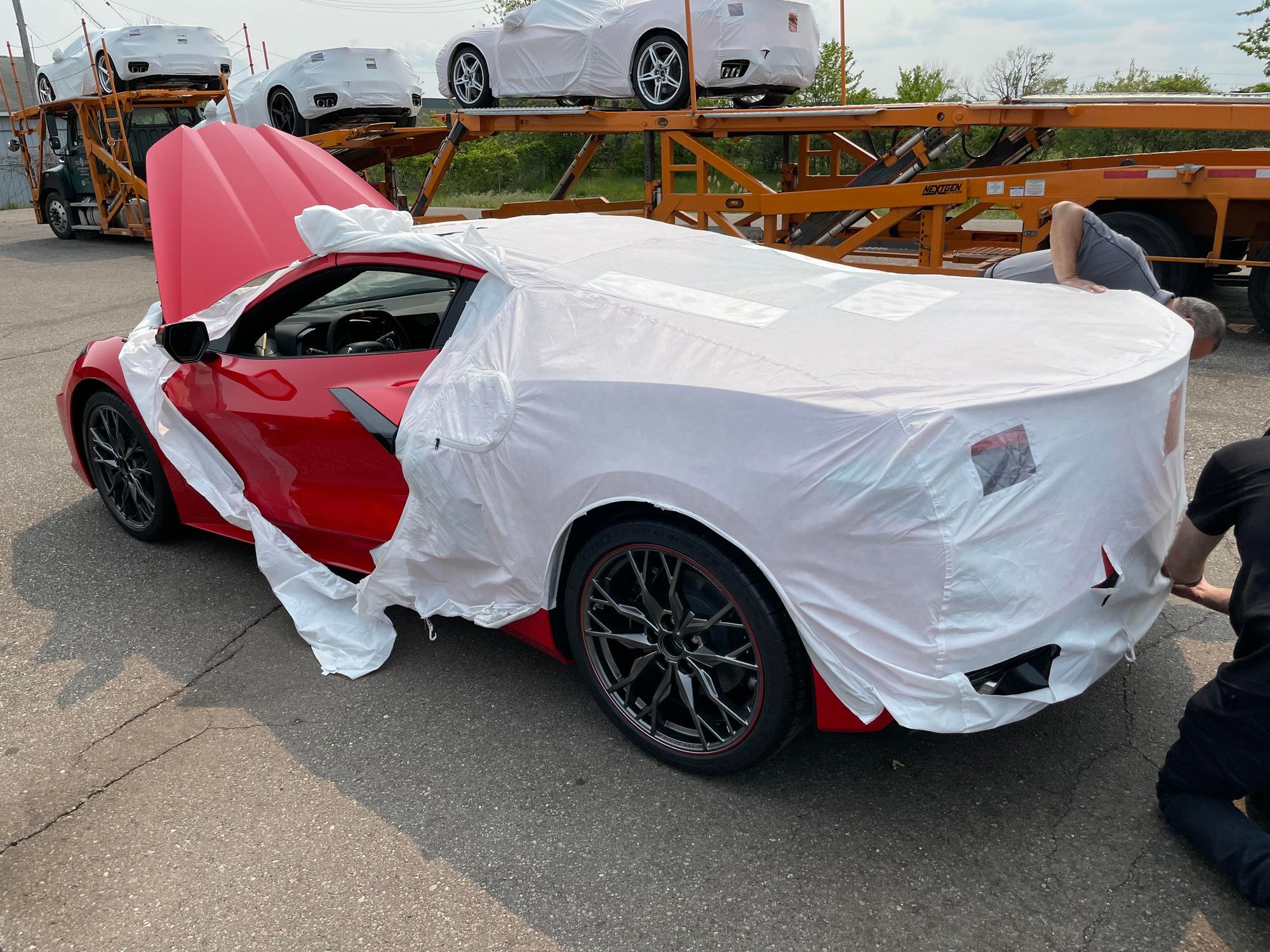

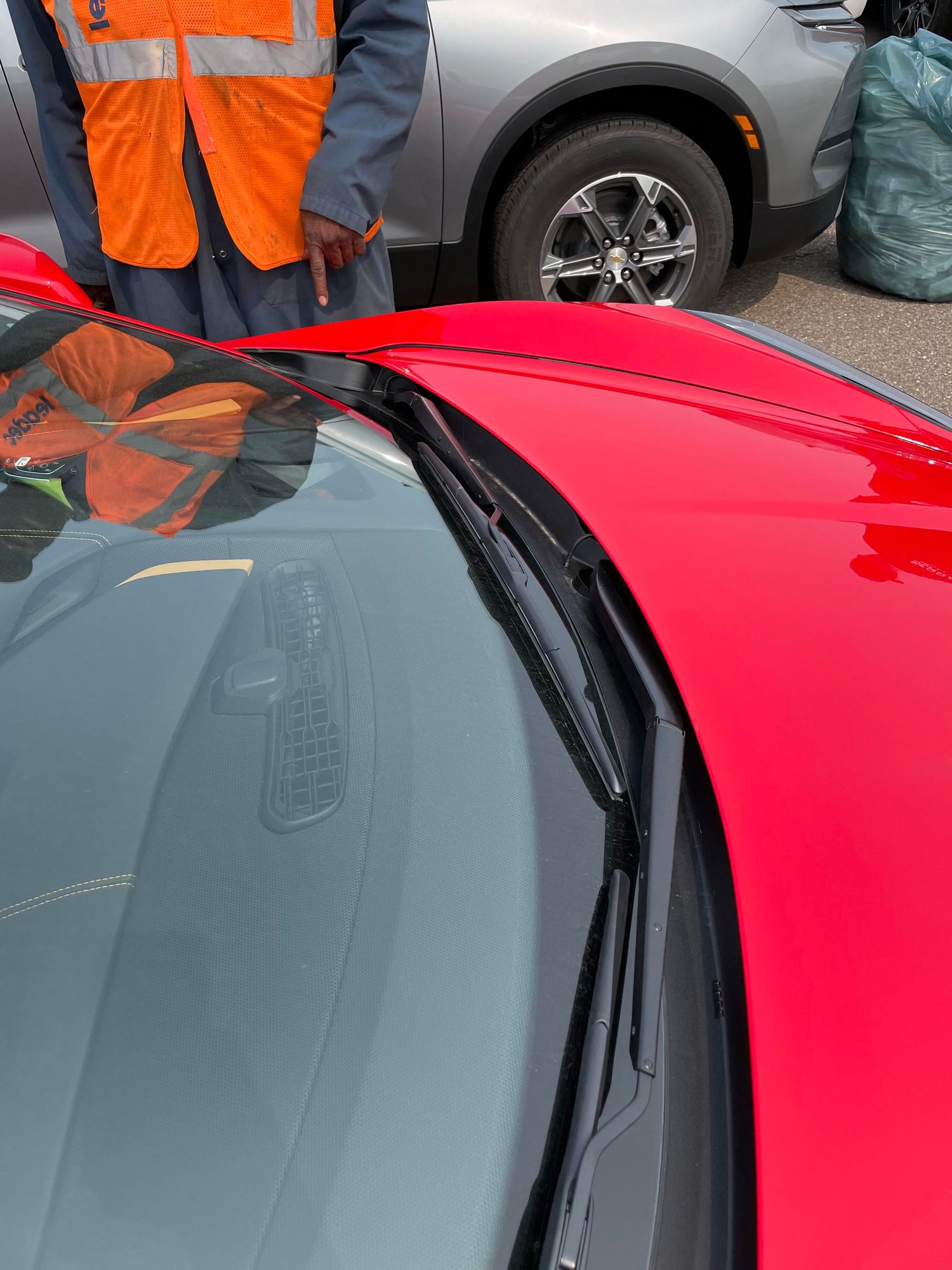

Was supposed to take delivery in the next few days.....the hood flew up during transit creating uneven panels where the hood meets the fenders near winshield.
Other than that waiting on all my dealer-installed items to arrive.
Hopefully delivered tomorrow or Wednesday.

Originally Posted by impalaz
I thought these came wrapped?
It did.
passenger side looking at driver, passenger side is much worse. the hood is sunk 1/4" on one side and 3/4" on the other.

I'm sorry, but that's absolutely NUTS! Apart from whatever other incompetency was involved in your particular situation, GM should know better by now than hinge a "hood" in the back. Sheesh, when was that last the case on a Vette series before the C8?
I am mystified by how the damaged occurred in the first place. they have safety latches to keep if from fully opening? the truck driver pointed it out to us, he's like this is not our fault!!!!!! someone didn't latch the thing.
I can't imagine how this damage occurred. the force of 70 mph on the hinges of the hood bent them? I was so freaking excited I hardly noticed.

Parts on order- delivery Friday if all goes well. The hinges are toast, the hood was popped the entire way from BG to Detroit. It does not appear to have chipped any paint, but they will know when the hood comes off and the hinges are replaced. FML my birthday is Thursday and wanted to pick up the kid from school Wednesday with it. She has no clue about the new car. Oh well, Friday it is. Bummed. The anxiety is killing me.
