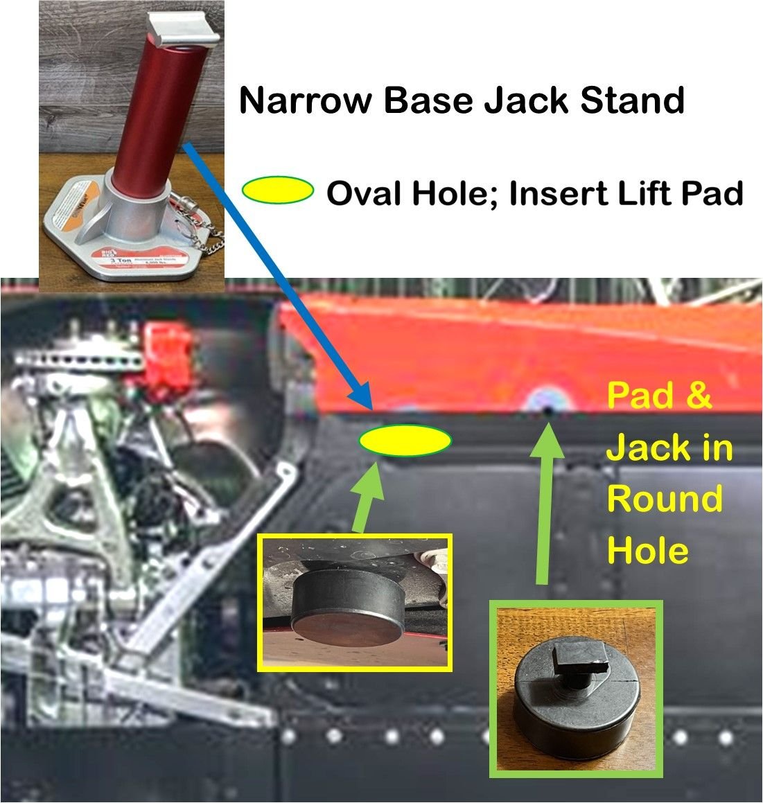

FWIW, Member Strake used those when changing brake pads. I noted his pic and mentioned his name in my PDF on "How To" change C8 Z51 brake pads where most removed the caliper. As I recall he later bought more expensive, electric powered Quick Jack. Might PM him.
More recently Member Big Lebowski showed his simple, far less expensive method. Also detailed with his name referenced in my How To PDF: http://netwelding.com/Ceramic_Pads.pdf
After looking at his approach, realized you could use jacks with jack pads in GM designed oval slots and put a small base jack stand close to the oval slot, even closer than the round hole using a wood etc pad on the frame. Then no need to modify the jack pad to fit a round hole. If careful there will not be a tipping issue. Frankly I use two jacks and jack stands jacking each side alternately several times as I raise the car. Same as I have on my C7s. I keep slight tension on the jacks after lowering on the jack stands for extra safely.
Big Lebowski's small base jack stands are a bit expensive (BUT NOT Nearly as expensive as RENNSTAND.) I bought a small base jack stand from Walmart for ~$10 that could do the job.

Here are some other less expensive ways FWIW.
My two-jack method has worked for me. As mentioned, I always jack each side, alternating from one side and the other. Then lower on my jack stands keeping the jacks with slight tension as a safety and adding stability. The other thing I do when needing back and front in the air is to follow the safety advise mentioned on one of jack stands Warning Label. Never use jack stands rear and front. I made my wheel stanchions (but can buy) and use under one set of wheels. They are light and take little space.

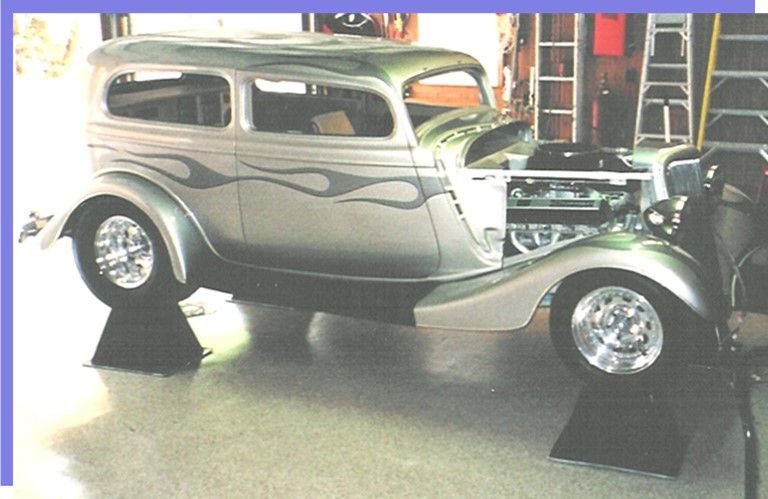

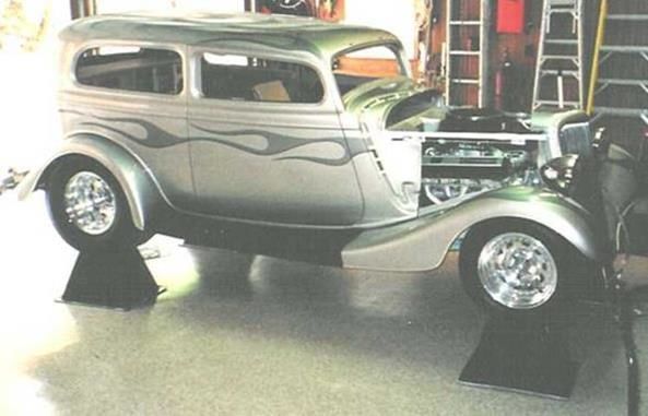

Made my wheel Stanchions from wood.
I always follow the Warning on one pair of my jack stands: ONLY USE ON ONE END. Not stable enough for me to get under may car supported by jack stands front and back!
BTW have commercial wheel stanchions I used when building my street rod. But they are 12 inch high and take a twostep jacking process to get that high. Was fine when I had the rod on all 4s installing wiring, exhaust, trans cooler etc etc. I spent a month on my mechanics creeper and it as very safe. Don't need the C8 that high. Quick Jacks would be in the way.

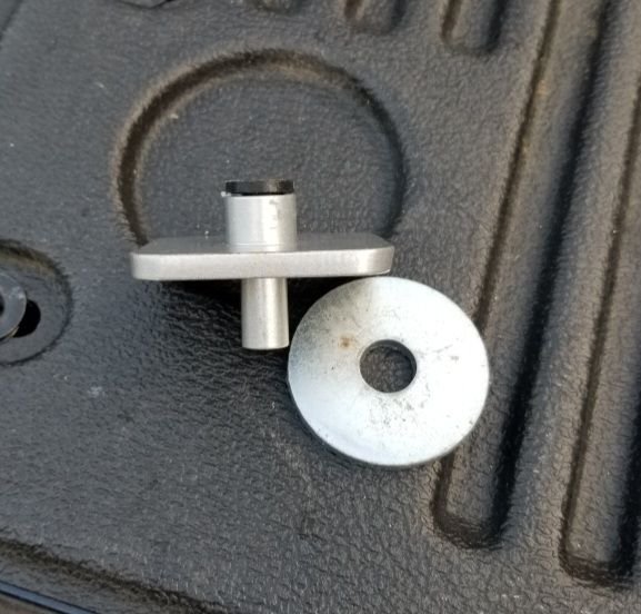

At the time I owned a set of RennStands for my former C7 and then C8........ until I sold them and bought a QuickJack lift, I used an adaptor plate on top that had a round pin welded to it on both sides of a round disc. The one pin went into a hold on the top horizontal bar of the RennStand, and the opposite side pin went into the Jacking Puck Location hole on the frame of the C8.
I'm pretty sure this is what adaptor plate I used....

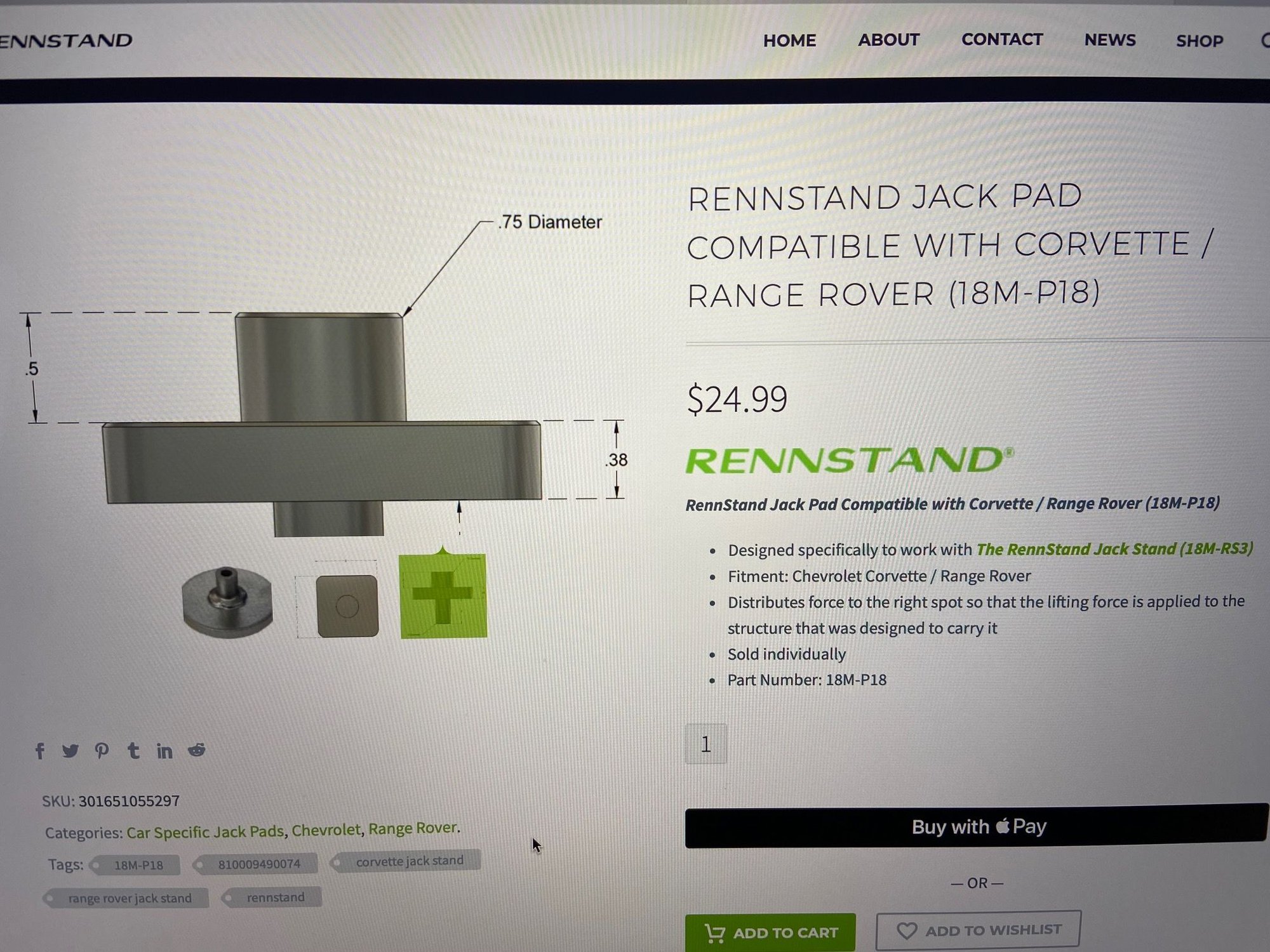

RENNSTAND JACK PAD COMPATIBLE WITH CORVETTE / RANGE ROVER (18M-P18)

^^^ I found these to be very stable and had no concern for the opposite side tipping over or slipping out of the hole in the frame. I did NOT use these against a jacking puck as the adaptor plate on top acts as a puck by itself and has a pin on top that goes into the hole in the chassis. I would NOT feel comfortable if I was trying to use it against an already installed puck with a smooth surface on the bottom.

Yep when doing things like removing and installing exhaust where a lot of force is required, only way I felt safe is using 4 wheel stanchions! Quick Jack may be OK is not in the way.
When building my Street Rod only felt safe installing exhaust etc with all 4 wheels up on my 12 inch high commercial wheel stanchions. However took a two step jacking process and was only worth the effort when car was up for over a month and I was on my mechanics creeper! Still have but now use my two lower homemade wood stanchions.
It was a really nice product, (RennStand), although somewhat pricey..... but you could jack up your car in the correct location and at the same time put your jack stand in place all in one motion.
Received the above part today from Rennstand. The diagram says the part is .75 inch in diameter. Mine measured out at .63 . I measured the car oblong hole as being able to take
up to a .71 inch diameter '"plug"
