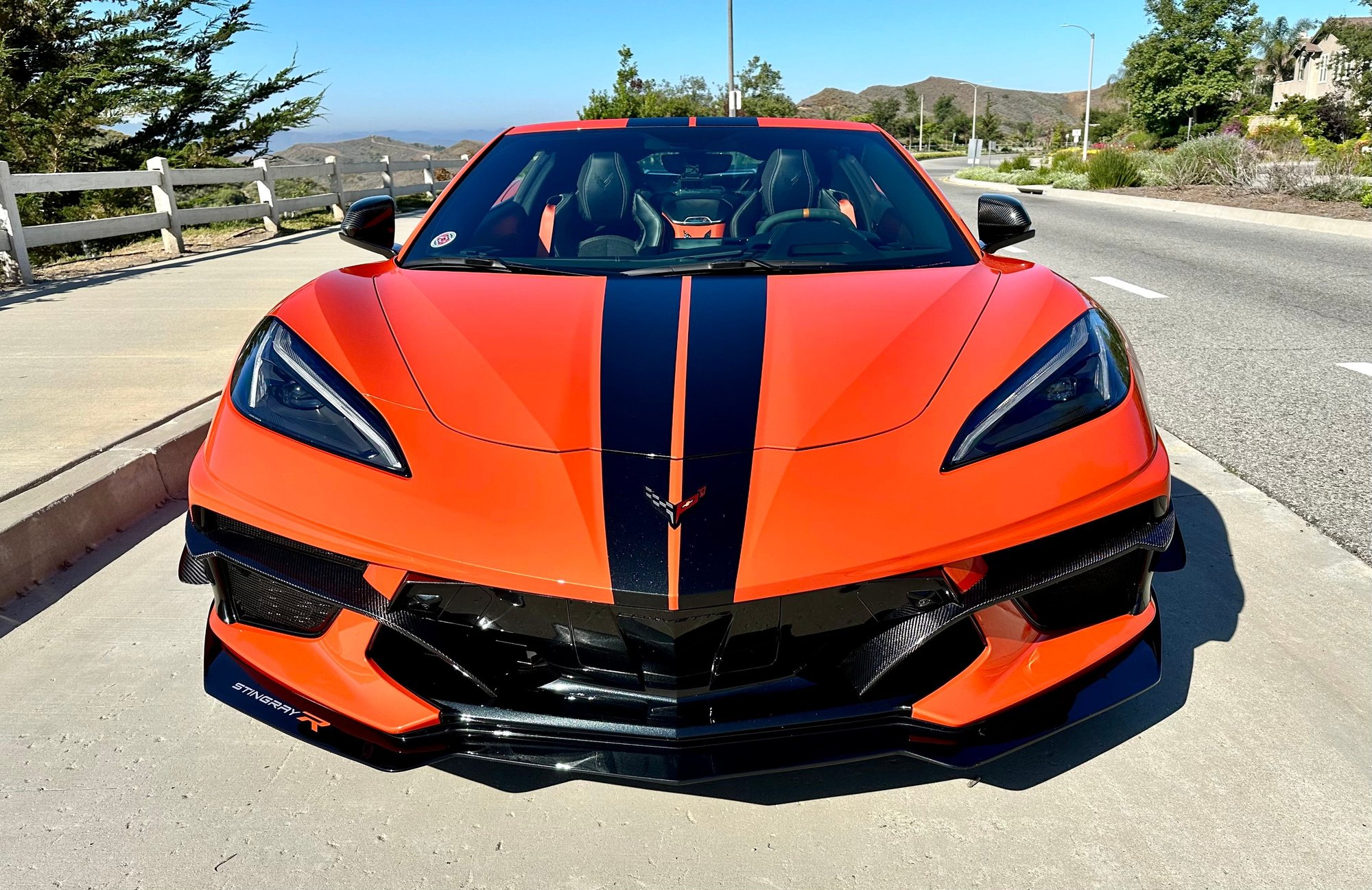

I have SunTek Ultra PPF and GTechniq Ceramic over the stripes (Carbon Flash)…..it didn’t change the sheen at all. BTW, photo is after 2 years from application.

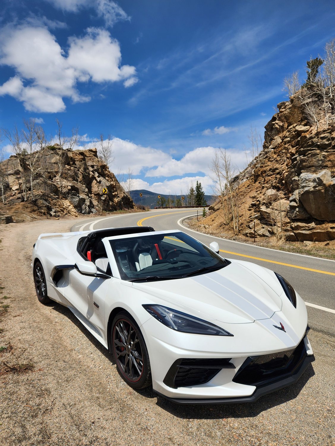

I chose to PPF over the stripes. Very happy with the outcome.

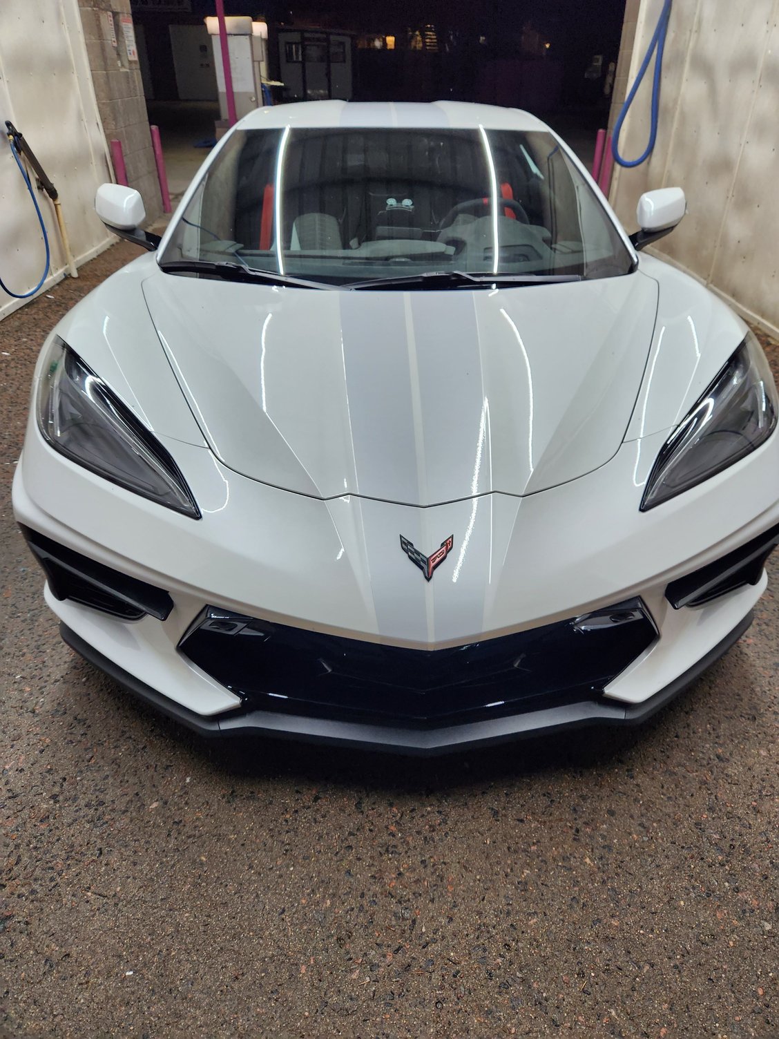

My installer put matte PPF over the stripes and gloss over the rest. Looks good.

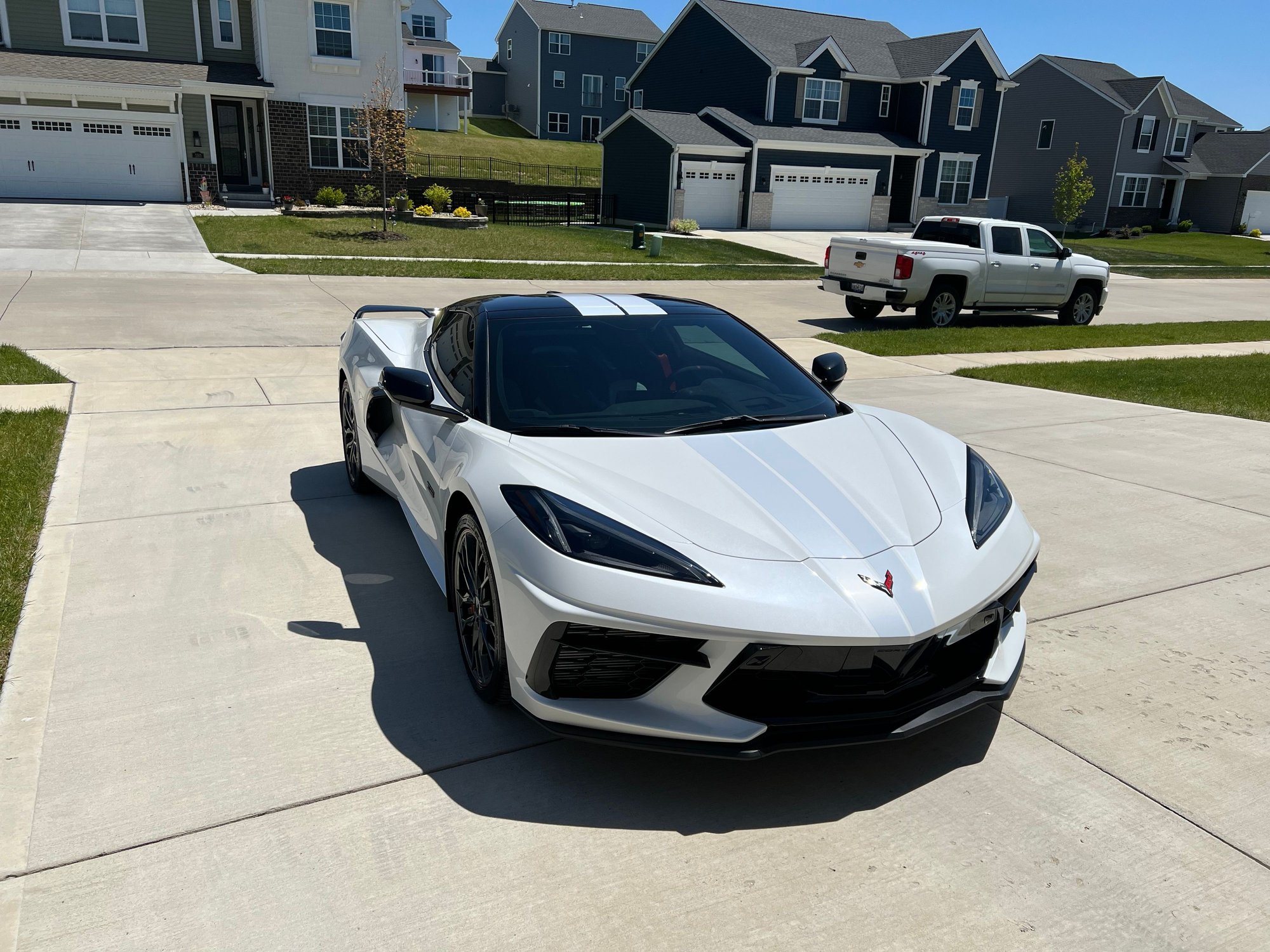

I had the full front end, a pillars, headlights, mirrors, roof and a race package plus ceramic coating. I am very happy with the job.

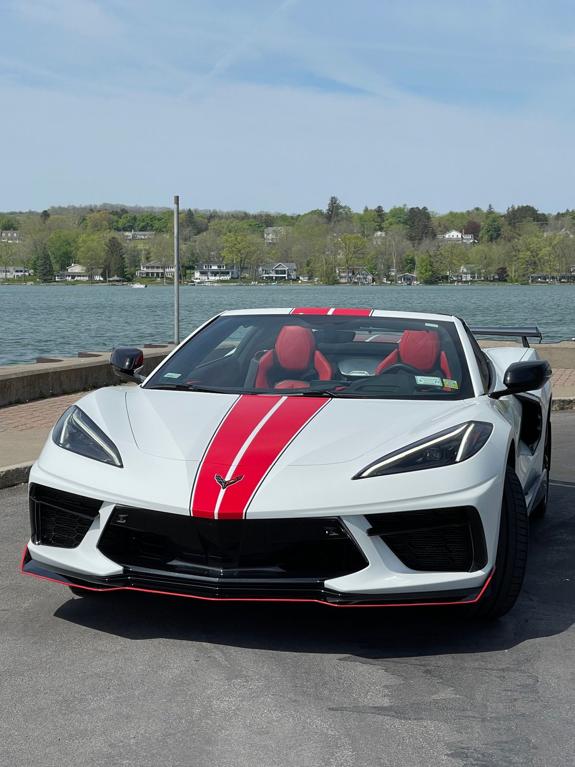

I had PPF put over my stripes. Maybe it's a little different on a White car but I love the way that Red POPS in the sun.

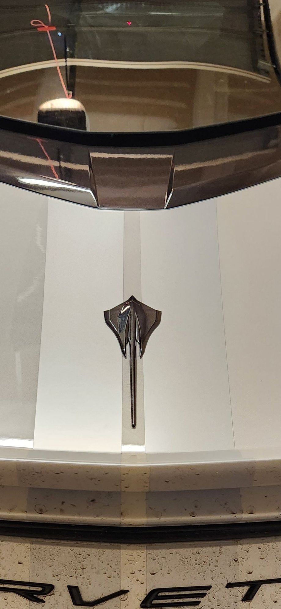

I chose to PPF over the stripes, didn't want to see extra edges collect dirt. Happy I went this route HOWEVER, installer needs to be mindful of the vinyl stripes creating a separation if not installed properly at the edges (edges should wrap far over the ends, don't let your installer stop short on edges or will start peeling/delaminating, ask me how I know). As other's noted, you absolutely will notice air pockets/lines around the stripe edges, but, personally I don't mind them, again, prefer that over dirt collecting there. As for the sheen/matt finish, I did the front bumper, hood and roof, barely notice the difference from PPF over stripes to no PPF on trunk, doesn't bother me.
Do PPF over stripes....
In comparison, picture of rear stripes with no PPF, honestly can't tell at quick glance in terms of sheen/finish.
