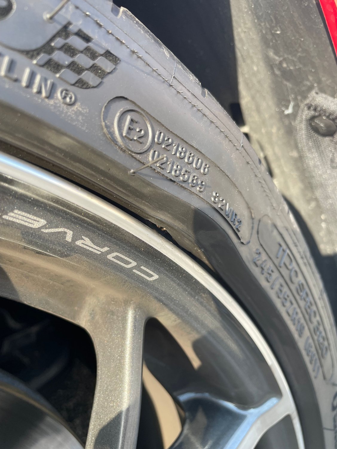

Same here driving from Florida to North Carolina. Hit a small pot hole, but didn’t expect the tire to be damaged. Fortunately, Discount Tire had a tire available and was able to replace it the next day. Payed $400 for the whole thing and continued my trip. Next time I will be extra careful, because the pot hole wasn’t that bad.
In these pictures, unless it's an optical illusion, it appears the rim has also been slightly distorted.
I would advise to have it checked to be sure its still perfectly round.

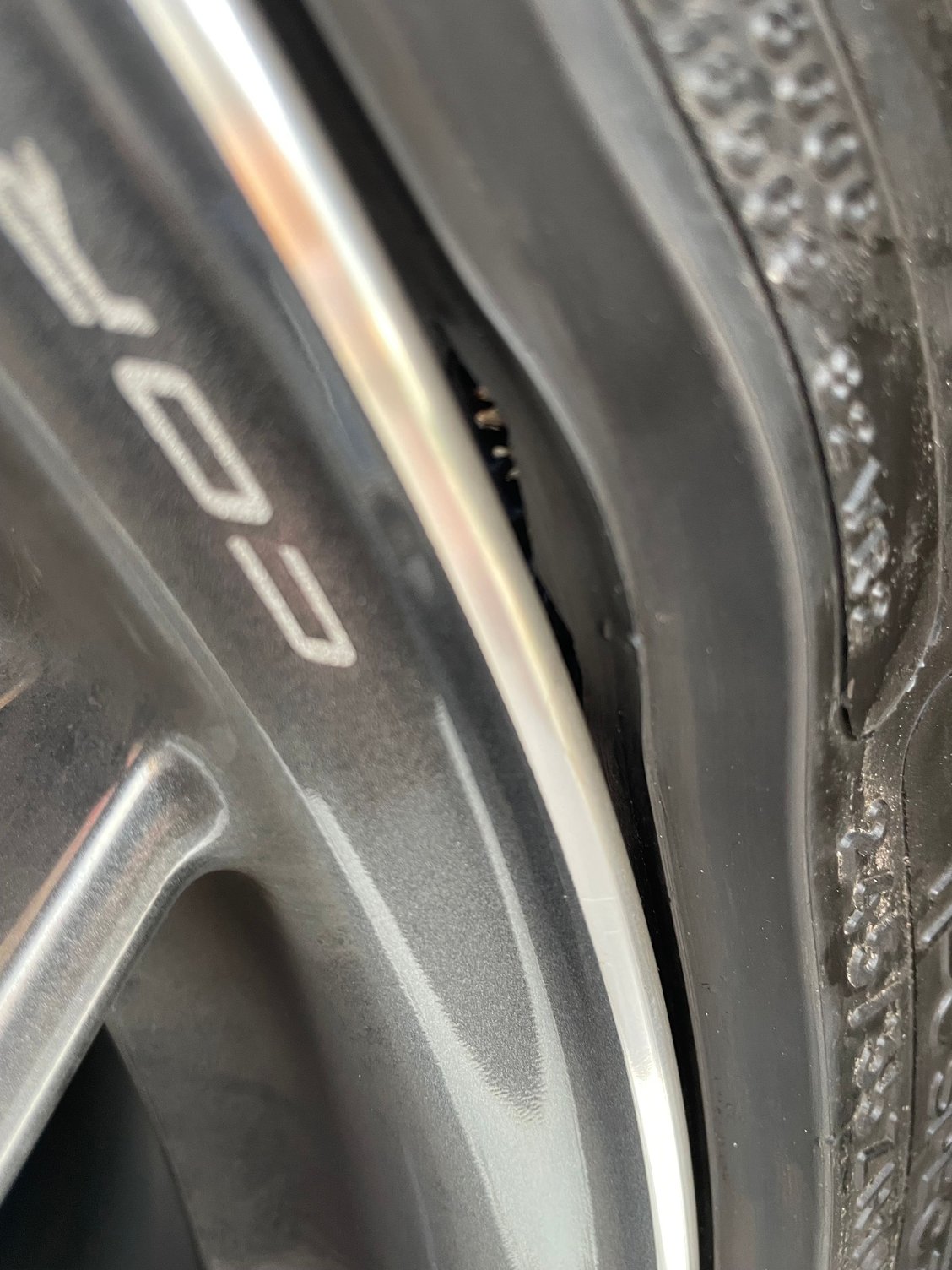

Just spent my entire day back and forth with a dealership getting the one tire replaced. $470 for one tire. I could have saved about $50 but refuse to use that slightly less expensive dealership. Of course the savings was on the cost of the tire, so their mount/balance cost might have made up some of the diffrerence.
I was prepared for the cost, but not for the extra bit of fun.
They now tell me that I need a TPM in that tire. Part cost is $44. Install is at least an hour of labor - total cost >$200. It's also a part they need to order, so it would be another day wasted at the dealership. It is possible that the TPM was damaged at the same time the tire damage occurred (which they claim). However, it was working perfectly prior to them removing the tire. According to the mechanic, that should not be the case if it was already damaged.
Without the $200 replacement, NONE of the TPMs will show a reading and my "flat tire" alert is permanently on.

based on your photos, no it should not have been damaged as the tpm module is part of the valve stem, so the part of your tire that is damaged would need to be close to where the valve stem is. I would say they wrecked it removing the tire, especially since it was working when you brought the car in. Here is what it looks like https://cdn3.volusion.com/vfpzc.jmvk...96SET-C8-2.jpg

I guess I am joining the club. Noticed this belt failure yesterday. Took it to the dealer. I have 9000 miles on this car and now this.
I have Tirer protection and I hope it is covered

I had the same thing happen to my passenger side front tire. Took it to Discount Tire and told it was called impact damage=pot hole and MIchelin will not cover it.
