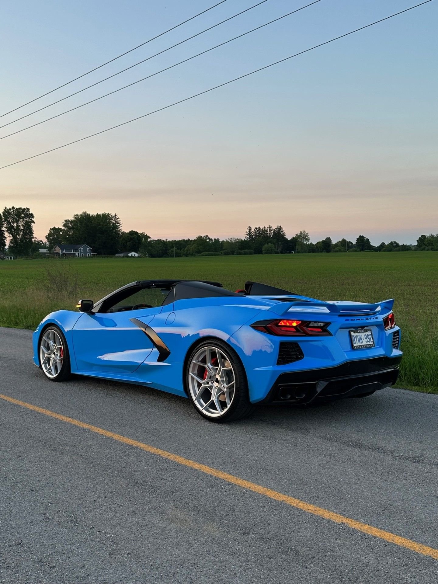

Because it looks so much better without the huge wheel gap. That's why every concept sports car and most show cars have little to no wheel gap.

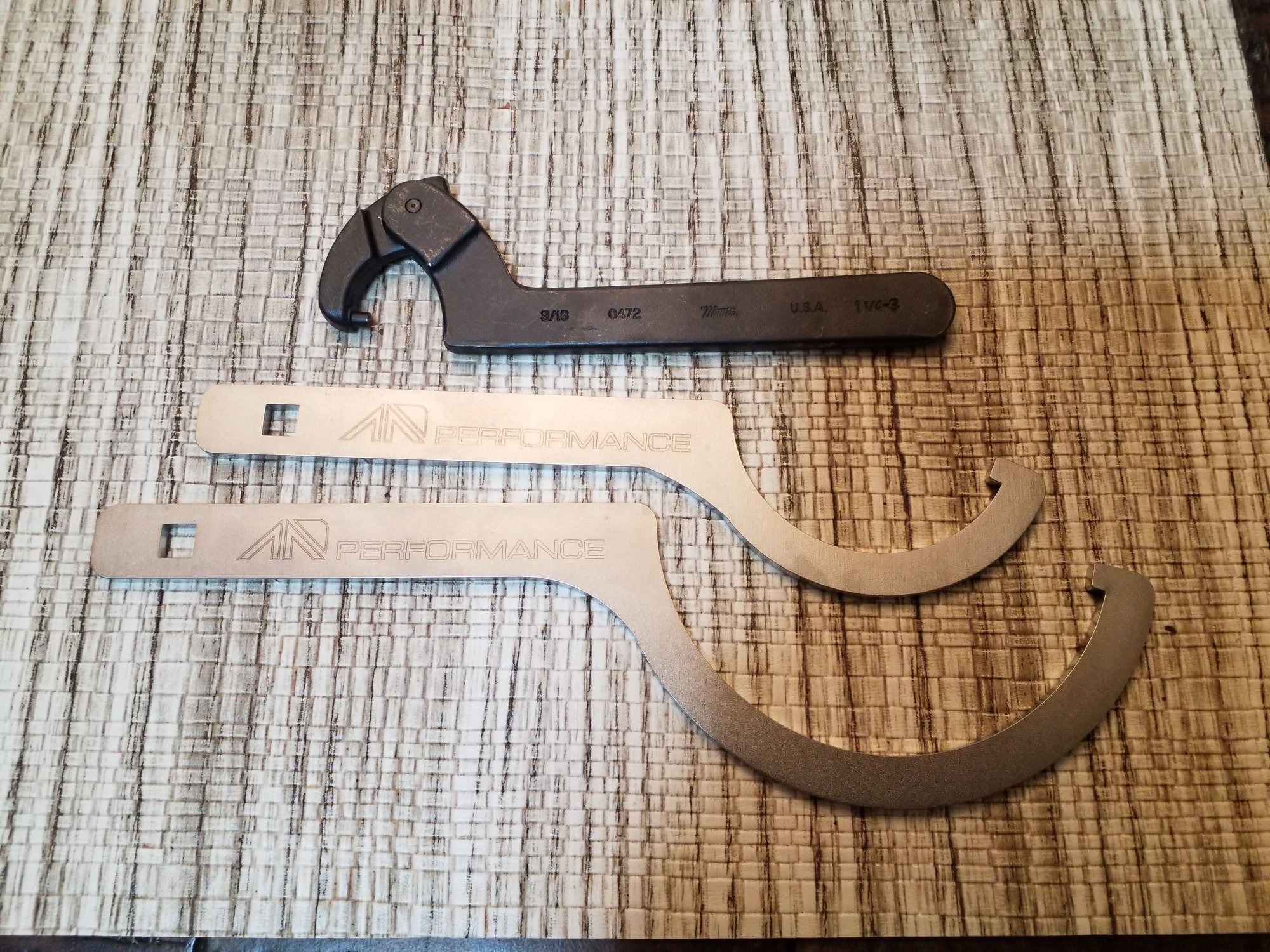

The C8 does not use "lowering bolts" as the previous year models required. Simply get the correct spanner wrenches and adjust the spring perches to suit.
