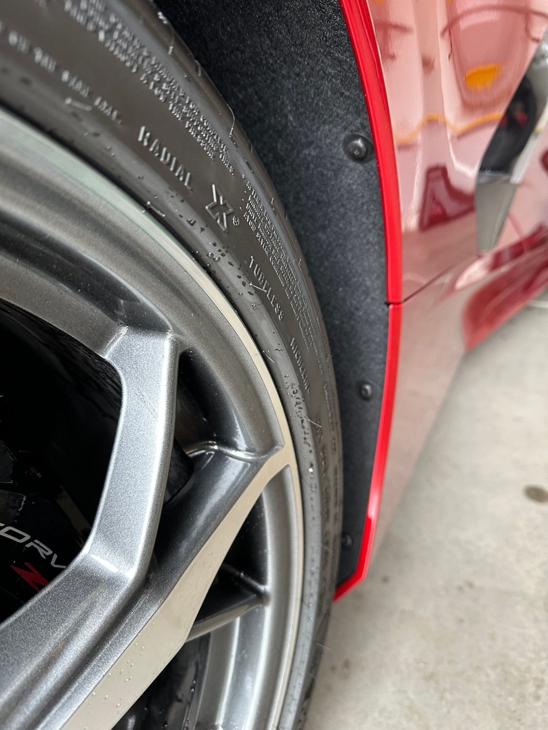

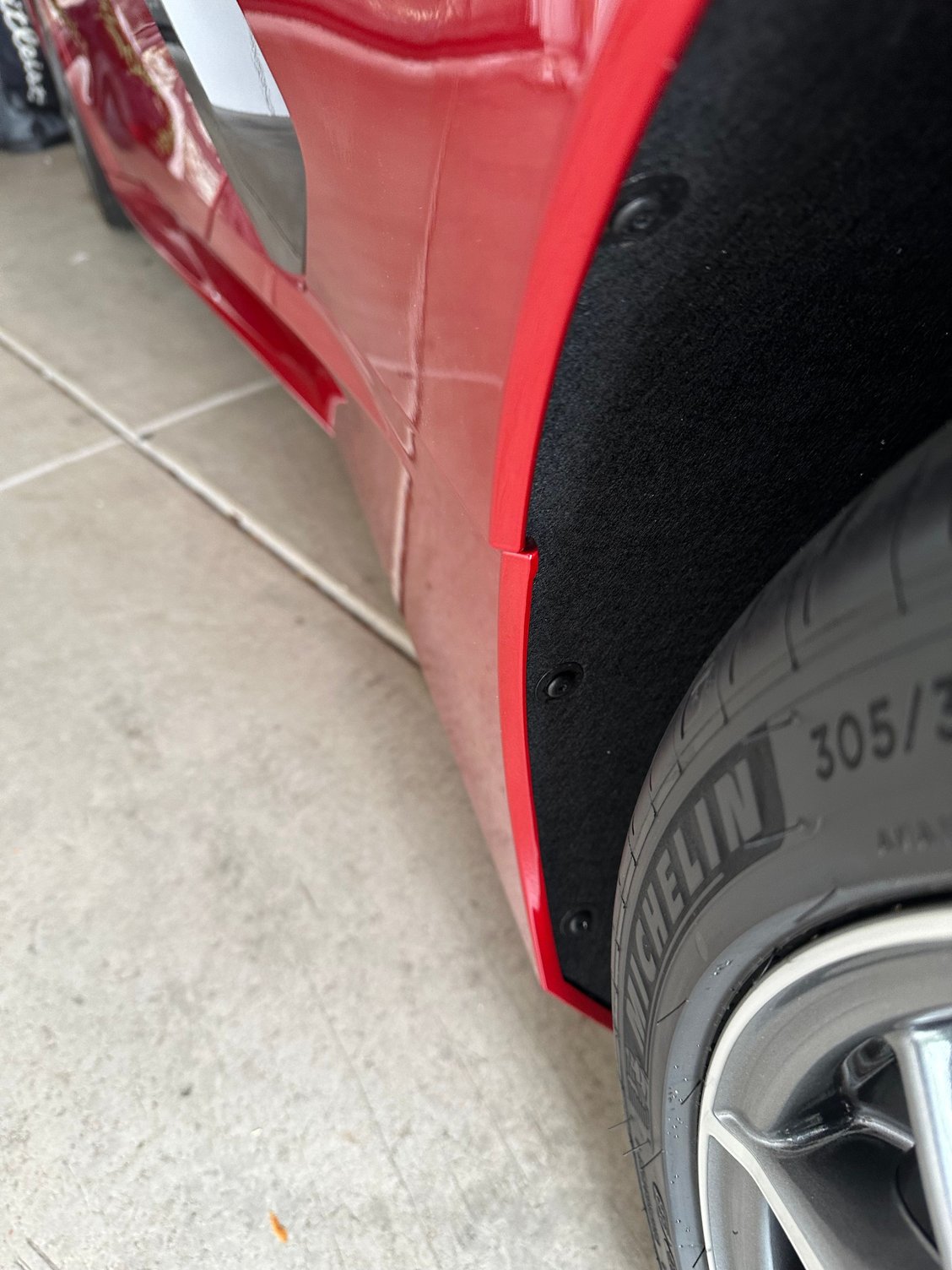

Hi forum. My new C8 now sits at 300 miles and did my first wash. As I was drying it and inspecting the car with a fine tooth comb I noticed the driver’s quarter panel off alignment by a few mm. Compared to the passenger side it’s a big eye sore. Is this something the dealer can adjust or do I have to just live with it?

Take the rear tire off and remove the wheel house liner, look to see what fasteners can be loosened up to get the panel alignment you want.

They should be able to fix that, something isn't fastened or aligned like it should be, either the upper panel or lower panel

Yep, that will not be difficult to fix. Actually C8 body panel alignment is really good in general, especially compared to the C7.

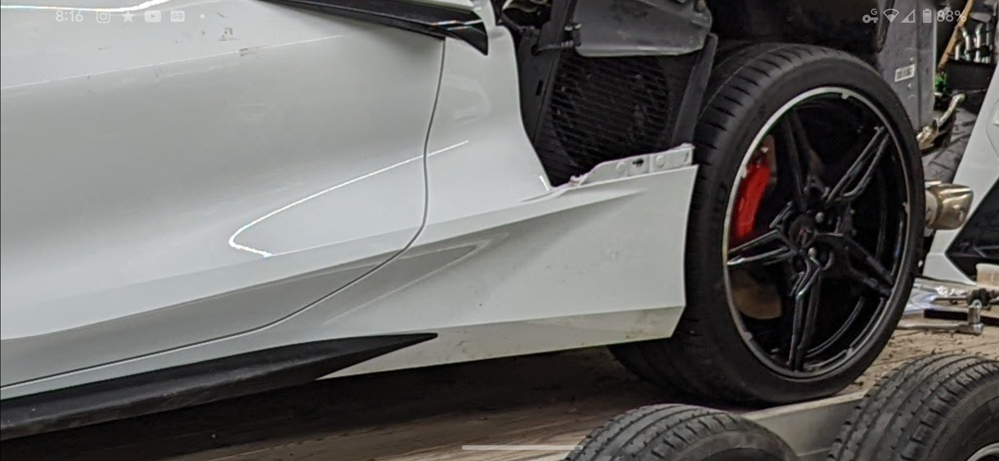

There is a screw in the front and rear of the aperture panel and a snap in clip similar to how most of the interior is held in place. It looks like the clip just came unsnapped. Not a great pic but the only one I had. You can see the slot in the middle where the clip is.

Thanks all for the help. I’ll take the liner off to see if it is something simple. Will need to wait until I get a new torque wrench. 140 lb-ft. for the lug nuts 😳. if I can’t fix it in 5, I’ll take it in.
