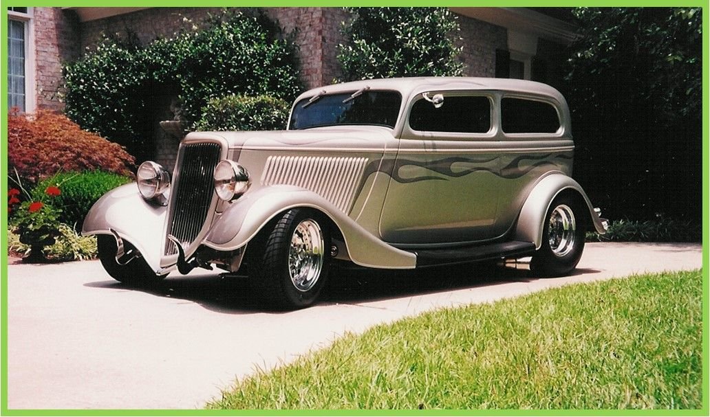

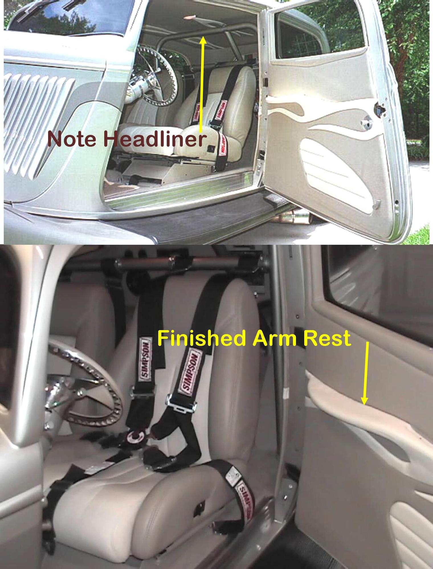

I get out with the car running to get the mail. BUT sure has to be in Park! Do you want the car to drive away from you in Drive??
The OP may be having the typical new C8 owner, "my door button doesn't work "issue. The button does NOT open the door it just releases the latch and only for a short time. Have to push **** AND push the door open or it just latches!
I never had the issue. In my Street Rod with only electric doors, I'm fortunate as the '34 Ford has suicide doors. They are hinged in a way that they open when the latch is activated with a remote (in my case by a solenoid.) Some street rods have to use what are called Door Poppers that are spring loaded to PUSH the door open.
My street rod latch is operated with a remote. If it did not swing open by itself I would use door poppers.
My suicide doors swing open by gravity, no door poppers needed
