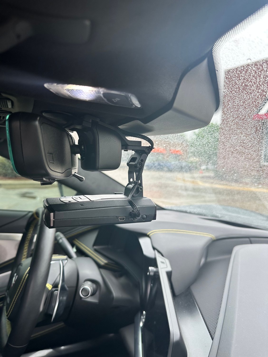

Have used Blend Mount on a number of my Vettes and never have had a vibration issue,
C8 is running with an Escort 360c without issue. Have uploaded 2 pics. Did u get the new mounting bracket for the C8? I did.
