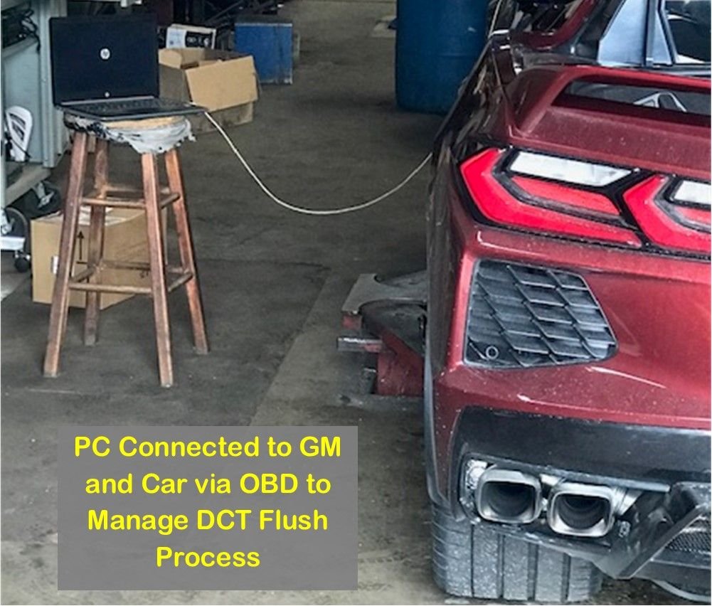

Originally Posted by JerryU
If you'll have 7500 miles before end year 2 that may work BUT GM says perform a FLUSH prior to all DCT filter changes. I had my first DCT filer changed at ~3000 miles as that is when my engine oil required changing as in was 12 months from when I got the car. Engine oil is changed as it was for my C7 when the OLM says, which it says in the C8 Owner's Manual (look at the forum 'Sticky Threads as you can download a PDF. Heck of a lot better you can search! Don't think I have opened my paper manual but a few times for my C7's or C8.) Engine oil change requirements are based on the OLM NOT miles. Been that way for my C6, two C7s and now C8. Frankly back in the day when all we had was miles and time miles were a poor indicator. Where they good highway miles with few starts and stops OR poor City miles with many starts, and worse cold starts. Good example was my 1993 Vette where the owner's Manual said IF MOST DRIVES were less than 4 miles change oil every 3000 miles OR 3 months whichever occurs 1st. See Pic.
I looked at the Dealer Tech GM Servcie Computer when he did my flush. It said the flush is designed to take any debris and put it in the the filter housing and filer BEFORE it is changed. It's a procedure done by the GM Service Computer removes no DCT fluid other than the ~8 oz that are in the filer and housing when the new one is inserted.)
Just had my DCT filter changed again year 3 with a flush done before.
Just Sayn!
I agree the OP's plan is mostly sound. I changed my oil at 3.5k miles myself (super easy BTW).
But this post brings up a good point about the DCT flush. AFAIK, the dealer is the only one with that ability to flush the DCT. I don't know if simply changing the filter and refilling will be as beneficial if there is no flush. Not sure if it's known at all. Will it hurt? Nope. But I would assume the flush is done for a reason...
Old Aug 26, 2023 | 06:46 PM
JerryU's Avatar
JerryU
E-Ray, 3LZ, ZER, LIFT
Joined: Sep 2007
Posts: 34,981
Likes: 12,383
From: NE South Carolina
Yep, been changing all my own oil for 63 years. Changed all my own in 5 prior Vettes up to the C8. Even the GM 4 FREE for my two C7s was not worth the risk of having it done wrong!
I fortunately found a great C8 Tech who changes oil the way did! First uses my 4 jack pads to lift on his center post with arms lift. With the C8 he underfills based on an estimate of volume in a table (an estimate is all it is) and gets the oil to 175F. Then checks the level and fills just below NOT above the MAX level on the dip stick. It says MAX for a reason.
Also a couple of reasons I took advantage of the GM Free DCT filter and engine oil year one when the OLM said change engine oil with ~3000 miles:
  • Knew I would not have 7500 miles in year 2. This is my 6th Vette, all DD's BUT been retired now 23 years and don't have to drive every day. Only use the Vette locally.
  • There were a number of posts where folks reported DCT CELs with few miles. The dealer was told by GM Service after discussing the codes to perform a FLUSH, no filter change or fluid change JUST a FLUSH. Most times the CEL was gone.
  • When crawling into my garage to keep the driver's door mirror tip at ~1" max from the wood door molding (to assure the passenger mirror tip clears) for the 1st ~1000 miles it was a bit jerky. After that, as now it was very smooth.
  • Knew that 1st gear clutch was slipping at the 2 to 3 mph speed I was driving. Had to or the engine would stall. The initial wear of the high spots on the multiplate clutch after ~1000 miles made it smooth. That wear and other initial, synchromesh cones (three per gear), and gear wear is usually highest that first 1000 miles and certainly by 3000 the majority was in the filter.
  • Also read the Owner's Manual and KNEW year 3 all DCT fluid required changing (even with low miles.)
  • Understood GM says if changing the DCT filter early (as I did) MUST also change again at 7500 miles. By year 3 would have that many miles. So my plan was to have the DCT filter changed again year 3, with the fluid change, which I just had done with a FLUSH as GM requires.
Pic of my 1st year FLUSH before the DCT filter was changed. It's all done by the GM Service Computer connected to your car via OBD port. Watched a few weeks ago and it was the same. GM service computer sets the rpm to ~2000. It said testing and after 10 minutes stated flush completed. Took ~10 minutes,
