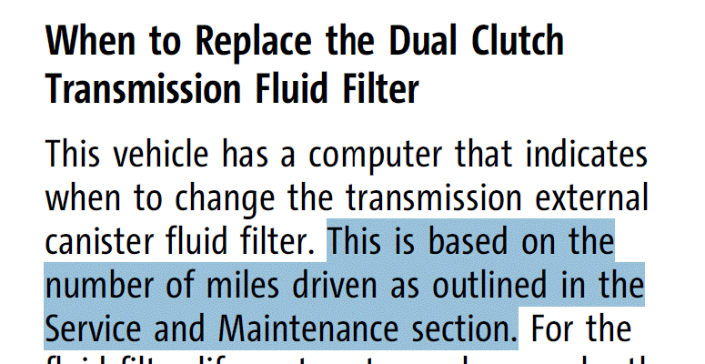

From the description the filter life monitor is strictly based on mileage. If you divide 5800 by (1-0.27) you get 7945. The first filter change interval is 7500 +/-500 miles so you are on track.

Your number does seem a little off, but not in the direction you thought. I agree with the math others posted above. The Owner's Manual says that the life monitor is "based on the number of miles driven as outlined in the Service and Maintenance section." Reading that, I would have expected it to be based on going to 0% at 7500 miles, which is the number in the maintenance section. And so at 5800 miles I would have expected it to read 23% rather then 27%. However, suppose it had the 500 mile grace period built in (which is what @RKCRLR is getting at above) , so it was designed to go to 0 at 8000. Based on that, you would read...wait for it....27.5, or probably display 27, exactly what you have. And if it is based on going to 0 at 8000 miles, then at the other end of the grace period (7000 miles) it would read 12.5%, probably displaying 12%. If it was linear and had a built in grace period of +/- 500 miles. Of course it could be designed differently.
