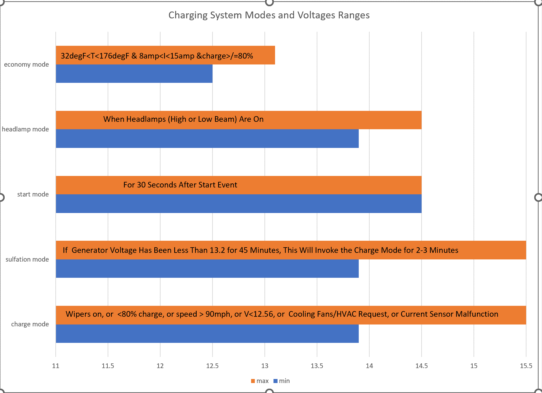

The voltage you are reading is charging system not battery voltage!

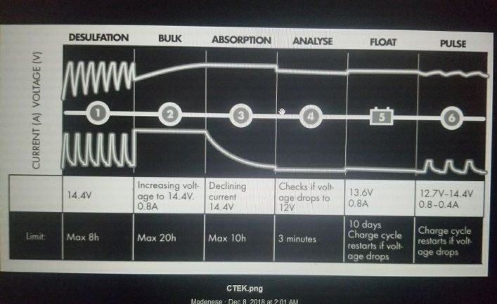

THE GM Logo'd CTEK made charger, like most CTEK chargers has a "Desulfation Mode." It might. Most trickle changers do not. But frankly even if it did it's life was shortened. After 3 months a new battery is best.
This is a great chart to show what is going on with the charging system and battery maintainer. If you watch the voltage display on the dash, you should notice the voltage cycles between 12.x volts to 14.x volts. I am not totally positive, but I think this is what's going on with the factory charging algorithm.

.... I am not totally positive, but I think this is what's going on with the factory charging algorithm.
The factory charging system is being controlled by a computer to reduce energy use (like most modern cars.) It will only charge the battery to 80% and no more!
I have watched my voltage and it does just what the GM algorithm says it will do after the car has sat for a few days. On the 25/30 mile drive to town the dash Volt meter reads about 14 to 14.5 volts. That indicates it is powering all the cars needs, i.e radio etc AND charging the battery.
On the way home, usually early into the drive, there is a step drop to 13 to 13.5 volts. That indicates the battery is at 80% charge and the computer lowers the output to power the car accessories BUT not sufficient to charge the battery.
Correct. It is system voltage, which, if the engine is running will be higher than the battery voltage if the battery were not being actively charged or discharged. You can activate the car in the Service Mode by holding down the start button while NOT putting your foot on the brake. When it wakes up you can read that voltage. However, even that would not be exactly right - because with the system fired up but engine not running - the draw is already 10 amps or so even after the exterior lights are out. I know - I have measured it with clamp meter on the battery cable.
Here is a graphic representation of how the charging system works that I made from data in the Service Manual:
