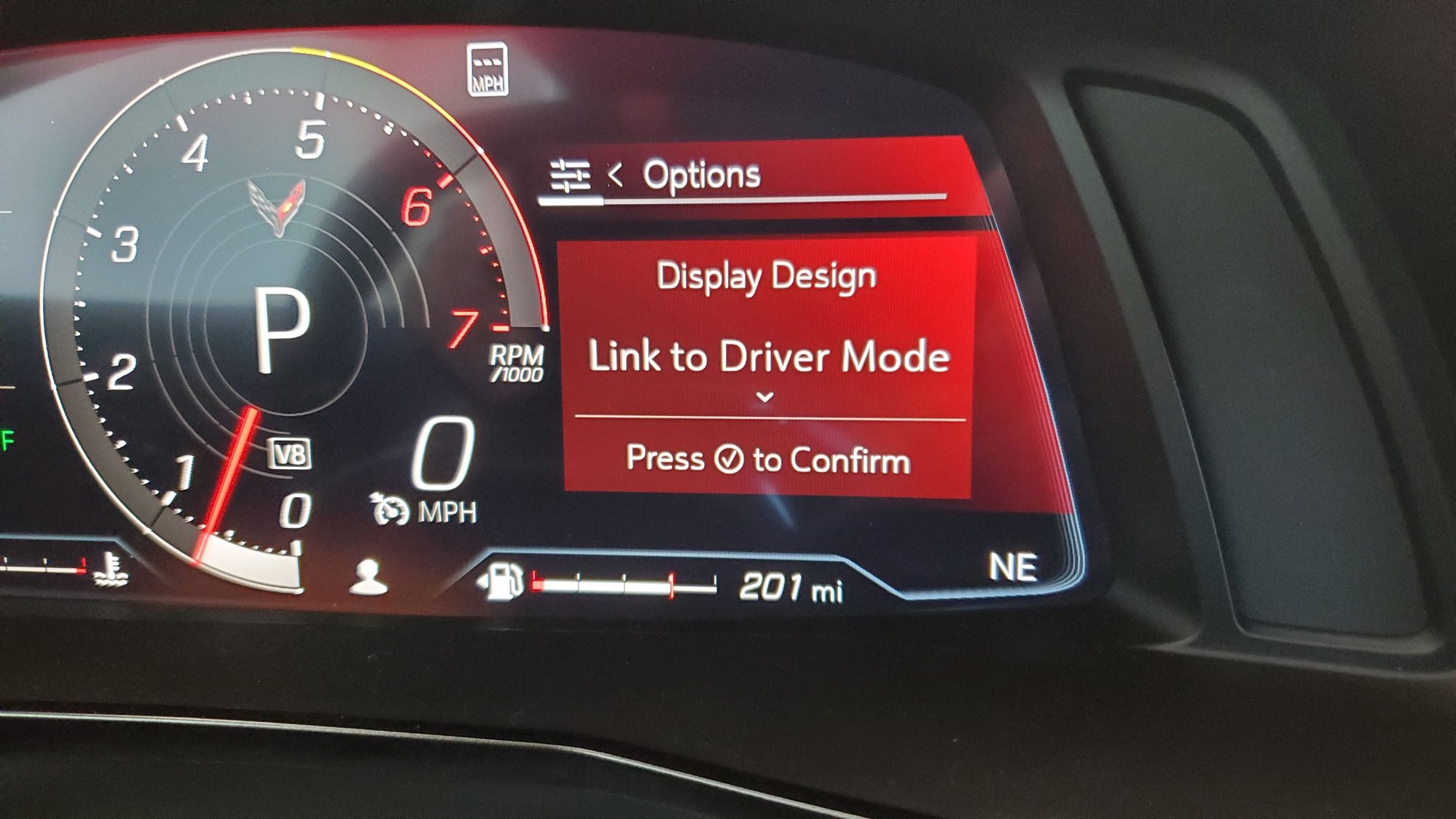

I had a similar experience after this last update (N23-2418150) where all my customized DIC settings and info blocks had changed and I had to go back and change them...
To setup customized drive mode screen settings you need to go to options and make sure you are "linked to driver modes"...
Once "linked to driver mode" you can set My Mode, Z Mode, and Track to either "Touring", "Sport", or "Track" Display...
**Note that when "linked to driver mode" Weather, Touring, and Sport Mode displays will always stay at their respective displays...
You can also do the same to HUD settings as well for My Mode, Z Mode, and Track Mode

[QUOTE=tadda;1607093796]I had a similar experience after this last update (N23-2418150) where all my customized DIC settings and info blocks had changed and I had to go back and change them...
To setup customized drive mode screen setting you need to go to options and make sure you are "linked to driver modes"...
That worked! Back to where I was before the upgrade. Thank you so much!

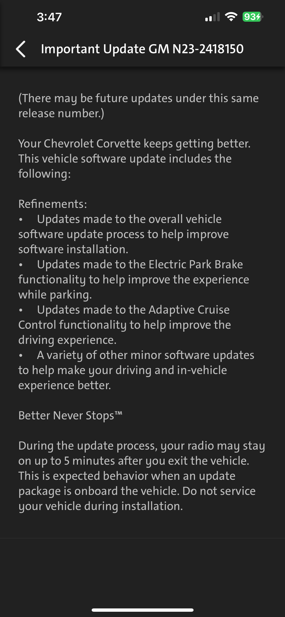

I just attempted to install this latest update (GM N23-2418150) BUT it would not install. It was stuck at the 10 minute mark for several minutes and then I received a message that the update was not successful.
I tried the update again but the update was not there and it disappeared. Weird. Their OTA process needs improvement.

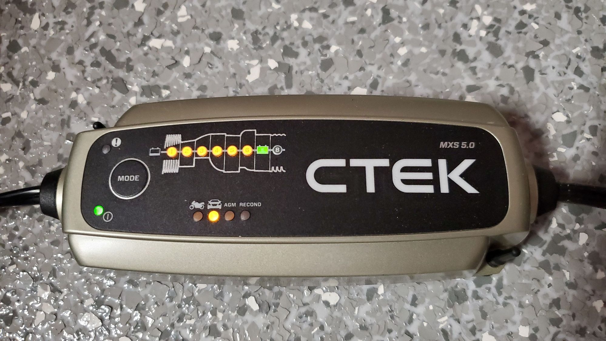

I always make sure that before I install any updates, I hook up my CTEK battery charger and make sure it's completely charged before installing the update and then keep it connected for a while after the update until I'm ready to go driving again....With this last wonky update, I made sure I kept it on overnight just to be safe!
