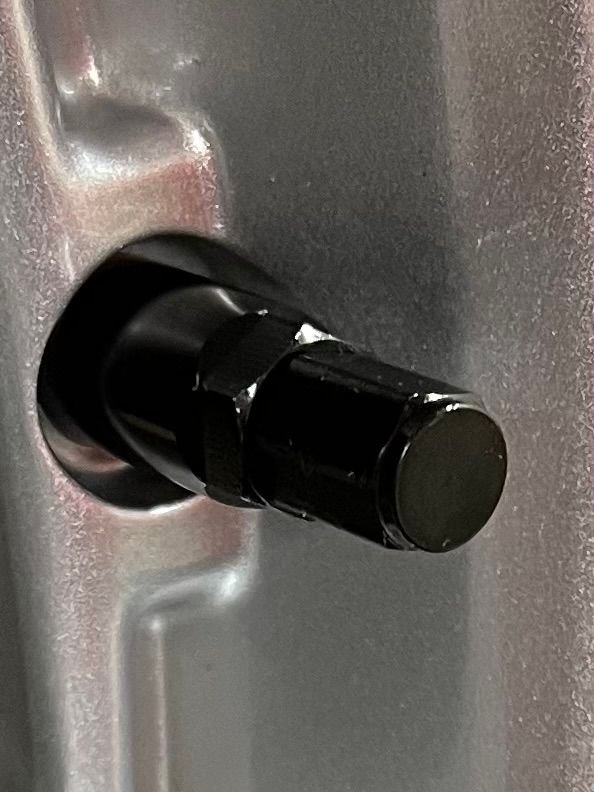

Originally Posted by Foosh
Tire Rack also offers TPMS valve nuts in choices of silver or black. I'd be wary about ordering something like this from Amazon, but TR does a good job of ensuring that whatever they ship is compatible with particular makes and models.
Pretty sure these are all universal size just like the valve stem caps.
There are however 2 different lengths (long or short) available.
I ordered the short version first, but ended up ordering and using the long ones to fill the gap between the valve cap and the nut/sleeve.
OEM (Note the gap between the valve stem cap and tpms nut/sleeve)
Aftermarket longer tpms nut/sleeve that fills the gap.
Final tpms nut/sleeve and valve stem cap installed on gloss black MRR F23 wheels
