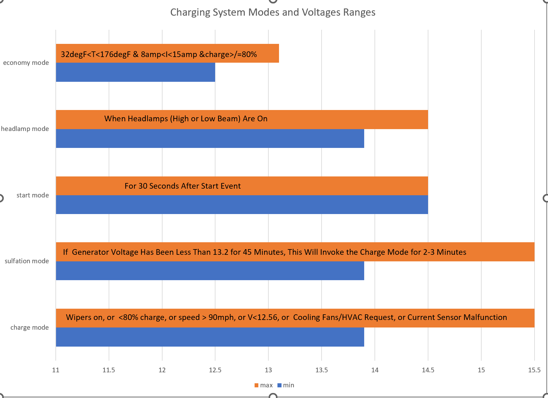

It is normal. Your battery is not discharging any more right? Now you are just concerned about the voltage. The charging system estimates the state of charge of the battery by measuring resting voltage when the car has been off for 4 or more hours, and then when it is running it keeps a continuous estimate of the state of charge by measuring current into and out of the battery. Then based on that SOC and other factors it selects a charging mode. Each charging mode has a different voltage range. This info is explained in the Service Manual that your technician uses. Here is a summary from the manual: "As the charging systems works to maintain the battery charge and manage vehicle electrical loads, it is normal for the voltmeter gauge on the instrument cluster or the system voltage displayed in the DIC to fluctuate or change. This does not indicate a malfunction. Depending on the battery state of charge and the vehicle electrical load, these values may be anywhere from 12.5V to 15.5V."
Honestly, I don't know why GM includes a voltage info tile. The manual give no information about how to interpret it. It seems to create mostly confusion. I never look at mine except when it comes up in threads. When the engine is running, the voltage you see is the system voltage or charging voltage. You cannot see (ever) the battery resting voltage using the DIC display. This is because even if you turn the engine off, you must put the car in the service mode to read the voltage. And, when in service mode, the car is drawing on the order of 10 amps (I measured that).
I made a graphic depiction of the charging modes using data from the Service Manual. Here it is.

Based on the description of the charging system for the Stingray in the manual, and the summary of it that I posted in post 32, the system targets an 80% state of charge for the battery. Most of the time, when it estimates the battery SOC at 80% it will switch to the fuel economy mode. It is described like this:
"Its targeted generator output voltage is the open circuit voltage of the battery and can be between 12.5-13.1V. When fuel economy mode is active, the generator is not charging, only maintaining open circuit battery voltage."
You could drive it a 1000 miles and the battery SOC will still only be 80%. That's fine if the car is going to sit unused for just a few weeks. In the "Getting to Know Your Corvette Guide" that used to come with car, but does not anymore, GM says "If the vehicle is not driven weekly, or the battery is disconnected or drained, use the optional battery maintainer to charge the battery." But experience reported on the forum indicates you can go longer than that.
But if storing the car longer, I think its best to put it on the maintainer if you can. If not, at least use the maintainer or charger to fully charge the battery to 100% SOC before storing it. Optionally remove the battery and store it on a maintainer.
