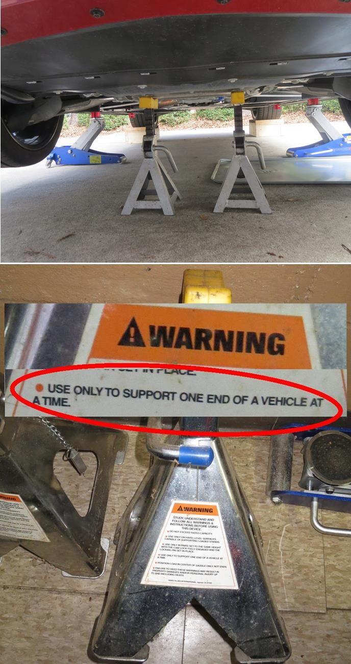

Did a lot of DIY in my day. With Pop he insisted after a car frame (all had frames in the day) was on Jack Stands or Concrete (NOT Cinder) blocks I had to hit it hard with my shoulder. As he would say: "Best if it falls, you're not under."
I do follow what one of my pair of Jack Stands warns, only under one end. Used wheel stanchions on the other.

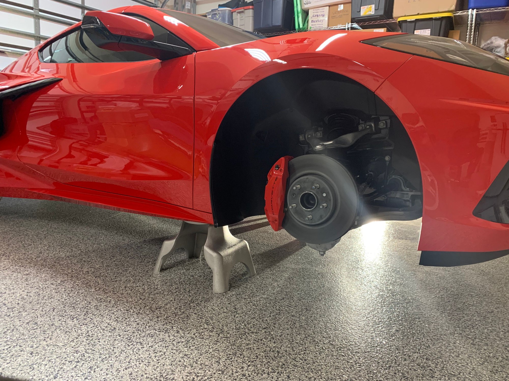

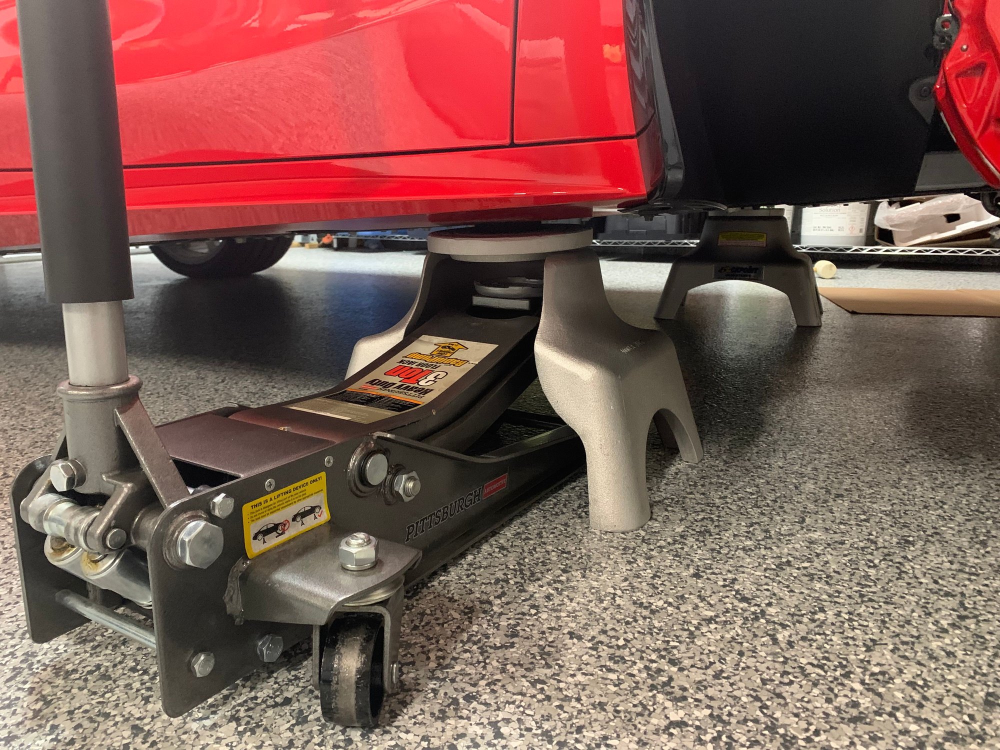

And why I prefer Jackpoint Jackstands when working on mine. Depending on what needs to be done I’ll use my QuickJack.
Yes, I work on my cars even my C8.
Note: Individual Jackpoint stands have been physically tested to loads up to 15,000 pounds without damage and exceed these standard and far exceed ANSI, PALD and European CE 4000 pound (per stand)standards.

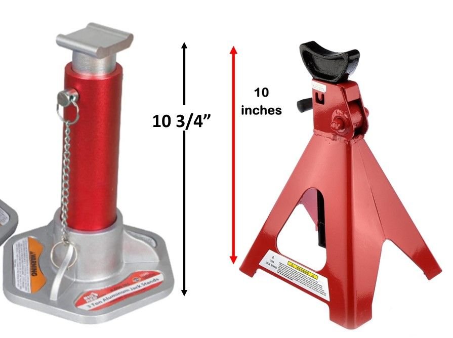

I used a simple safe method Big Lebowski did when he was removing the calipers from his C8 to change to low dust pads. Here are some pics of what he did, and I put in my How To Charge Brake Pads PDF, along with your Pic with Jackpoint.
I bought a small jack stand with small base I could put close to jack with Jack Pad in oval lift slot.

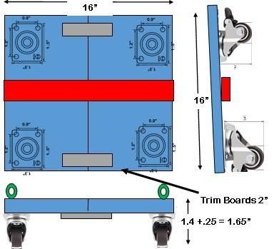

So after replacing the front wheel built what I call a "Tire Slide." Had some scrape 1/4-inch plywood 10" wide. Cut two pieces 8" wide X 16" long and put together to make 16" square. Bought 4 casters with ball bearing swivel having a load capacity of 100lbs from Amazon for ~$10. How they can be made in China, shipped to the US and then shipped free to me in 2 days is hard to understand!
Installed the foam pad protectors that come with the E-Ray to protect the CCB Rotors. Installed my three 8" long lug extenders and jacked the car just high enough to clear the 1.65-inch Tire Slide + 1/4 inch. Pulled the tire onto the "Tire Slide". Went on just as easy, no legs or lifting!
