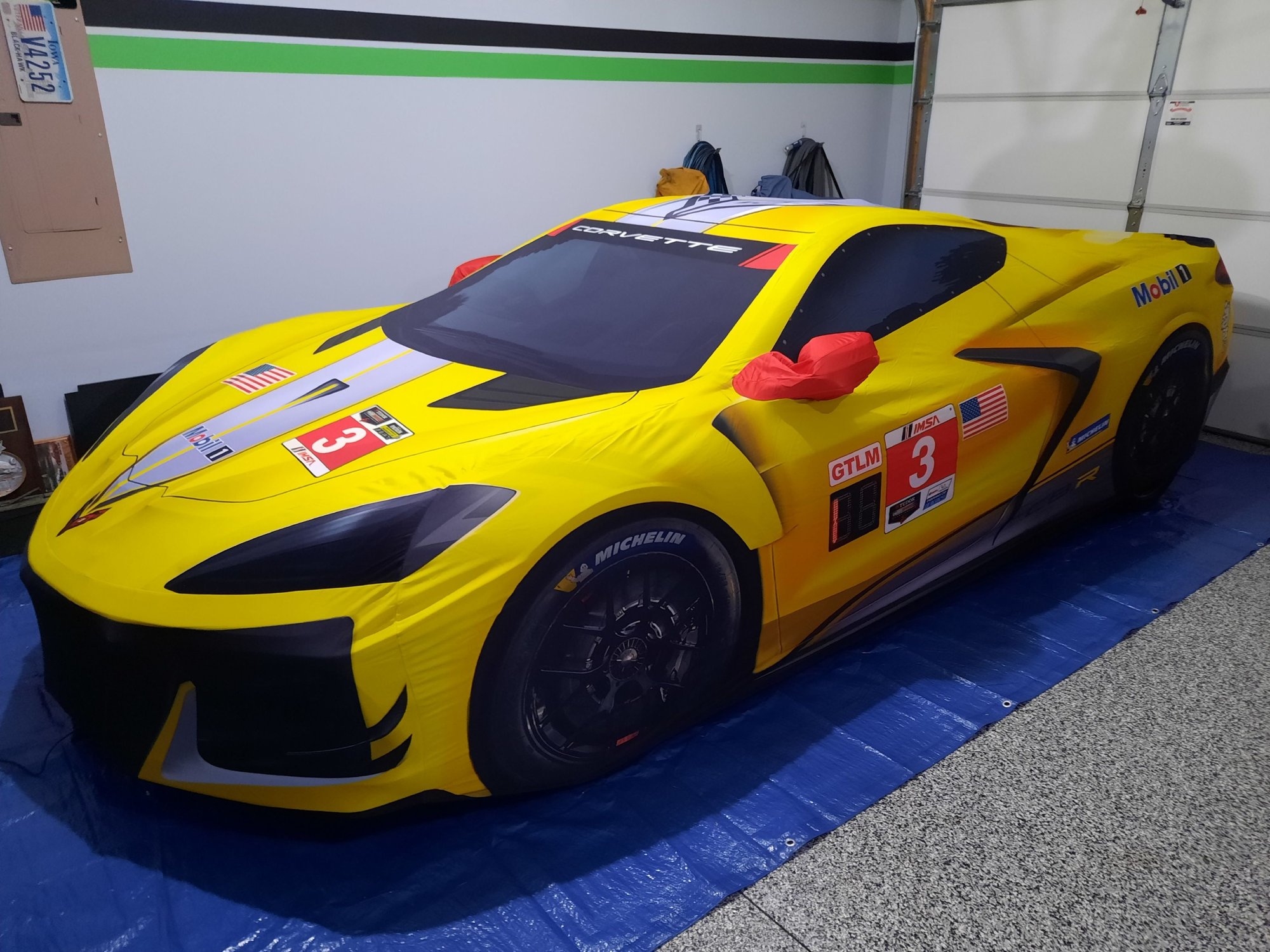

This is a car cover I just bought for my C8. Have one for the C6. It's an in-door/out-door cover. What I like is that the cover is made of several panels meaning that the cover fits snuggly around the body with no loose fabric to move when windy. https://coverking.com/products/2024-...autobody-armor
