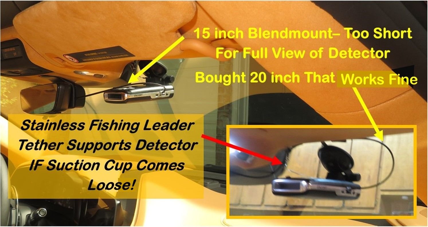

I don't like the detector hanging down and blocking any vision.
These are my two methods. First used on my two C7s for 7 years and C8 for two years. Used the Blendmout wire kit.
The second used about a year on my C8. Removed when I sold it a week ago and will install on my E-Ray at 3000. Will take just a few minutes
Removed from my C8 just sold and will install on my E-Ray. Wires hidden until they come out close to windshield. 3M Dual Lock much stronger than Velcro.
