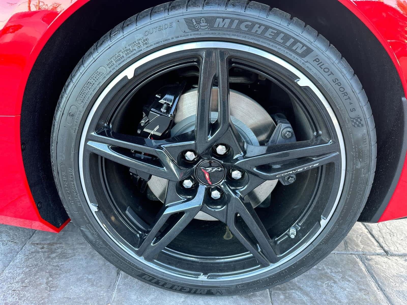

On the photo below of a '23 Stingray driver's side rear wheel, the caliper is located at 10 o'clock, what is the function of the part mounted on the rotor on the right side at 3 o'clock? I am curious since it appears non-Z51.C8s don't have those parts on the rotors. Excuse my ignorance. Thanks

Parking brake

^ Correct, it’s your parking brake caliper.

Base car: Front: 321mm x 30mm steel rotor clamped by 4-piston, 2-piece caliper. Rear: 339mm x 26mm steel rotor clamped by 4-piston monobloc caliper.
Z51 car: F: 337.82mm x 29.97mm steel rotor clamped by 4-piston monobloc caliper. R: 350mm x 27mm steel rotor clamped by 4-piston monobloc calipers.
Both cars' setups are made by Brembo with the rear calipers being common to both cars. Both share the same electronic parking brake on the rear. Pad compound differs.

You're confused. Both cars have the exact same rear parking brake caliper. There are no additional parts on the fronts of a Z51 car, slightly larger rotor and caliper, but no extra parts.

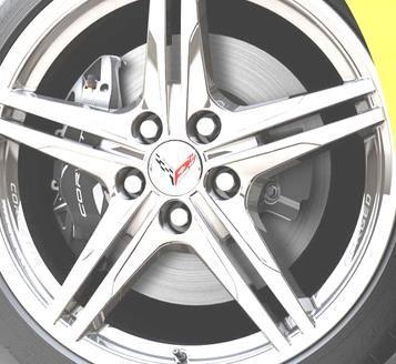

Here's an actual photo (taken from the Post pictures (here) of your new C8 when you take delivery sticky thread):
