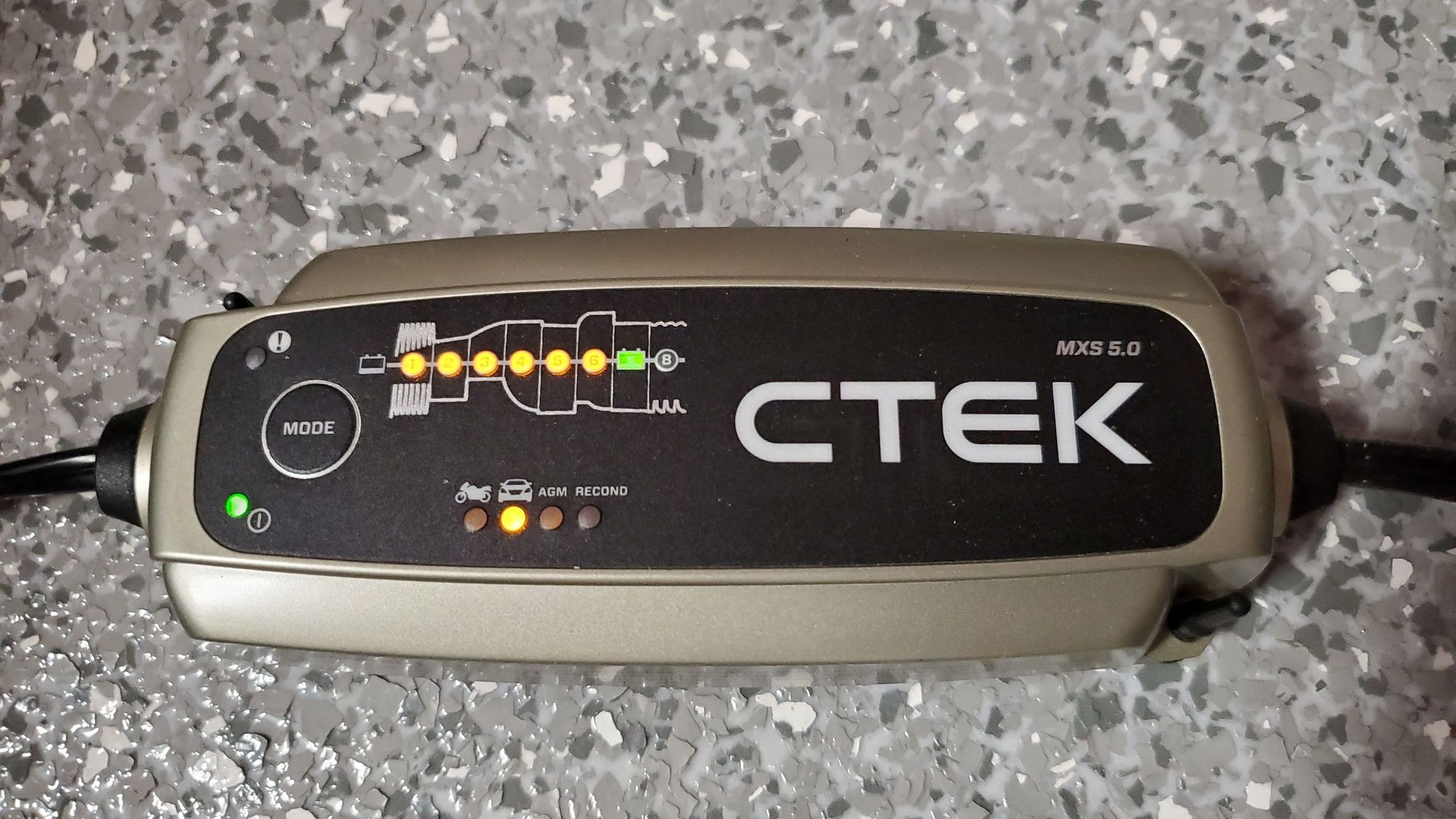

It doesn't have a Li-ion battery, just a regular battery. I plug mine into a CTEK MUS 4.3 every time I park the park the car in my garage (where it lives every day year round). It will extend the life of your battery.

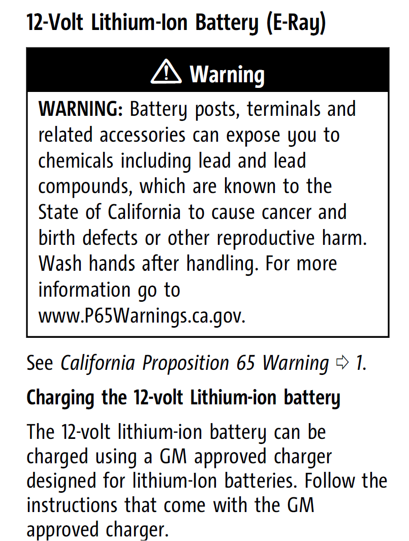

I would use a battery maintainer in your situation. In fact, I use mine all the time, even though I drive maybe once or twice a week. But, definitely if being not driven for a few months.
As for the battery type - the E-Ray uses a lithium ion starting battery. But, as I read the 2024 manual, it gives the impression that the standard Stingray still has a flooded led acid battey.
The 2023 manual does say to use a "GM approved charger designed for lithium-Ion batteries" for the E-ray LI battery. However, @JerryU has noted that the part number for the eray charger is the same as the part number for the Stingray charger. I do not know if this "mystery" was ever resolved. I beleive that the issue with some flooded lead acid battery chargers is that the have a sulfation mode that some LI batteries do not like. Perhaps (speculation) the corvette battery charger (which is the absolute cheapest version of the Ctek charger) lacks that feature - and so can be used for both. But that is complete speculation.
