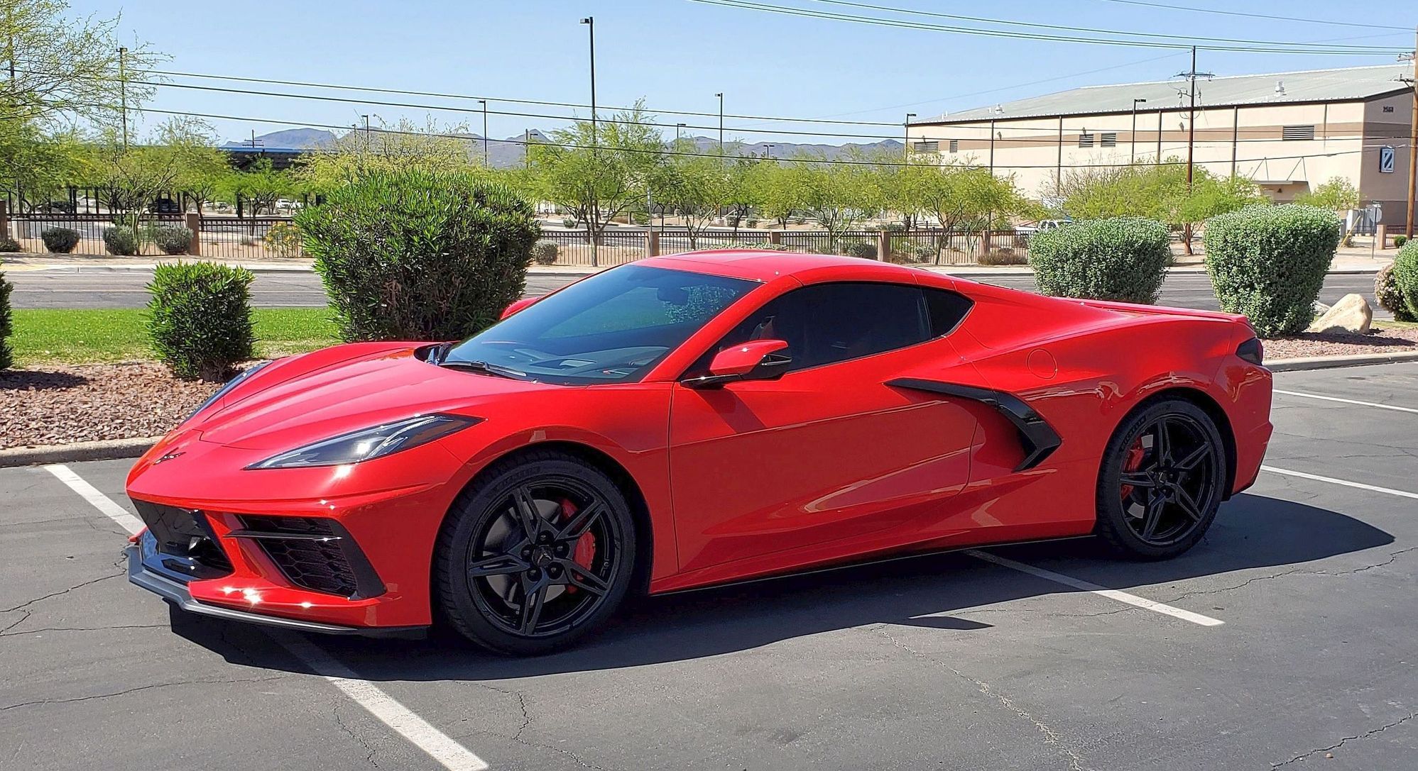

I took delivery on my 24 stingray last week.
It looks like the side windows are tinted.
Is there any tint on the factory glass?

I fairly sure the side window glass from factory has ~70% tint...
Example:
If you put 35% aftermarket tint over the factory 70% tint you would end up with roughly 25% tint. The formula for this is: 35% x 70% = 0.245 x 100 = 24.5%
Reply 5
Dec 14, 2023 | 10:40 PM
70% tinted is correct. As is the above math!

Windshield cuts UV down to 4%, side and rear windows down to 35%:
https://static.nhtsa.gov/odi/tsbs/20...00149-9999.pdf

There is a tint within the factory windows. I don't remember the % of tint I had done to my car, but it was a tint that was legal for my state. However, after the tint was added, it was no longer legal.
I intentionally didn't go too dark because I need to actually see out of my windows at night. My BMW has windows with a darker tint, and I have to roll my windows down to see better, particularly when backing up or parking at night.

Jun 21, 2024 | 09:56 PM
100%. Definity tinted.
How do I know?
I put legal tint on my car, (measured by a device at the shop) but after it was installed on my windows, it was measured again and it was technically illegal in my state.
So the stock windows on the stock C8 have a fair amount of "tint" built into them.
