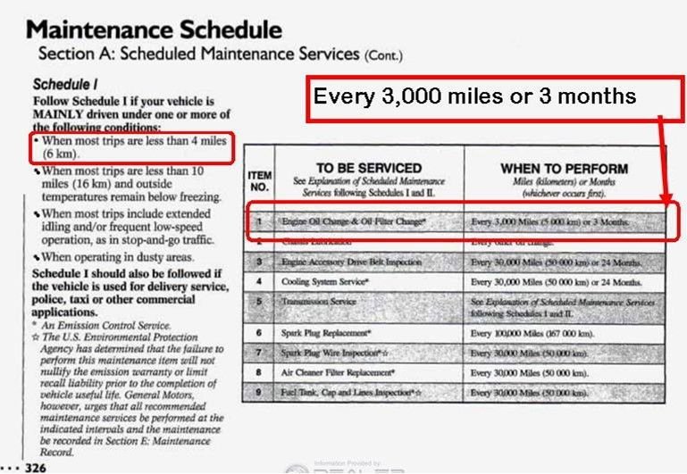

FWIW, the worse thing for a car and engine oil is cold starts. Particularly an issues for "garage queens" that mostly get used by driving less than ~4 miles. For the C8 the OLM will take into consideration your driving and may reduce the oil change requirement from minimum ever 12 months. It monitors the oil temp after cold starts along with other inputs, like total engine revolutions to define when you must change engine oil.
In fact may be interested in my '93 Vette Owner's Manual requirement for oil change if most drives are short trips. That was before the OLM.
Yep if engine oil does not get hot enough, long enough after a cold start to evaporate much of the water of combustion that passes the cold pistons, it will form things like sulfuric acid in he oil. That eats metal when the car is parked! Pic from my 1993 Vette Owner's Manual before the OLM.
