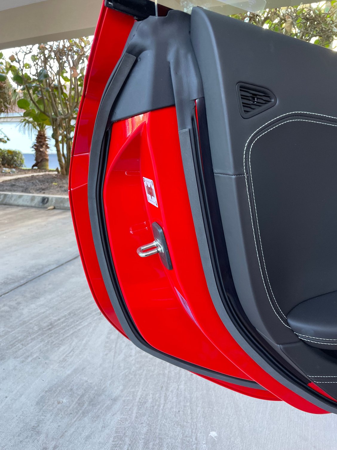

There are many things I like about my Corvette but road noise is not one of them. It got to the point that I was thinking of selling the car because the noise was so loud and annoying. Making telephone calls was difficult because you had to ask people to repeat what they were saying since the background noise was loud. In any event, I realized that the door gasket was improperly sealed so I added a strip of insulation gasket to the gasket on the door and what a difference it made! It improved to the point that I now can have a normal conversation with my wife and am also able to make telephone calls. This modification made a world of difference and I’m now satisfied with the ride and can truly enjoy my car.

What size gasket did you use?
Old Jan 1, 2024 | 10:03 PM
redcor21's Avatar
redcor21
Joined: Mar 2021
Posts: 34
Likes: 76
1/2” x 1/8”

So you added it to both door weatherstrips?

I agree the road noise is extreme especially on some road surfaces most of the noise is a result of the Michelin run flats that resonate from the wheel wells so I don’t understand how adding an additional gasket layer can stop the road noise resonating from the wheel wells.
