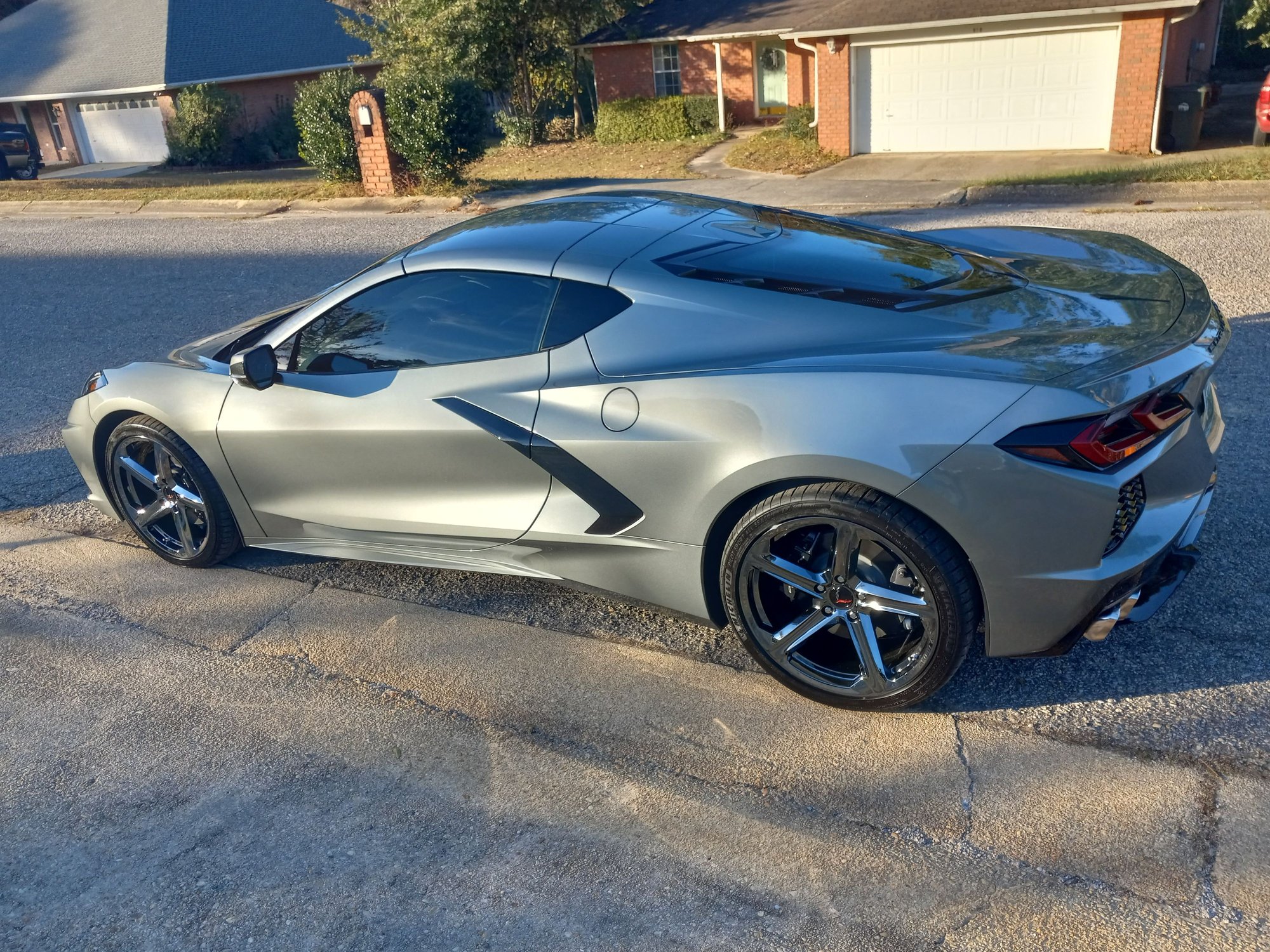

These are aftermarket wheels. Rear offset is +52 and the front offset is +35, but I'm also wearing a 3MM slip on spacer on front wheels only. Factory offsets are so inept it's pathetic.

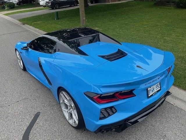

I went 35 front and 50 rear. Previously went 45 rear and I didn't like how much it "poked out" so went 50 rear this time since I knew I was going to lower it about 2".

[QUOTE=progtp;1607989733]I went 35 front and 50 rear. Previously went 45 rear and I didn't like how much it "poked out" so went 50 rear this time since I knew I was going to lower it about 2".
I'm looking at some Gem Motorsports wheels. The rears are 11" with a plus 45. I'm assuming the pics of the white C8 were the plus 45. Looks like they were pretty flush with the fender. Thanks for taking the time to reply. Those pics told me what I needed to know. Thanks again!

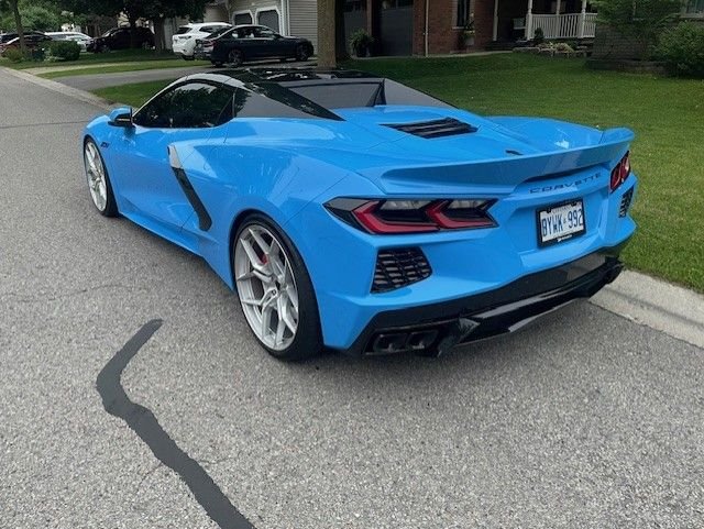

Here are a few pics of my old car when I had 45 offset on the rear. The rim was 20x11 with a 305/30/20 tire. Hope this helps you out.

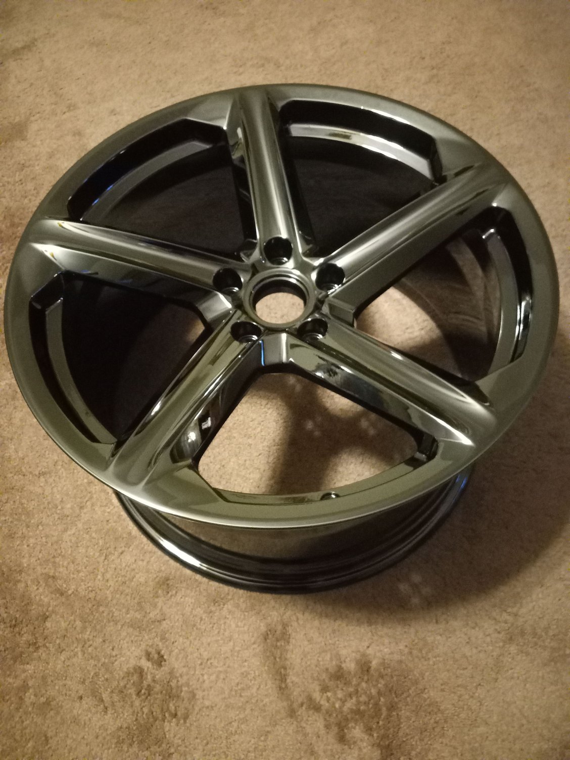

That is the look I'm after!! Thanks for sharing!! I'm going with the Gem Motorsports G8Z in chrome. Yeah, I like a little blingg. It'll look good with that Hypersonic Grey. Again, thanks!
