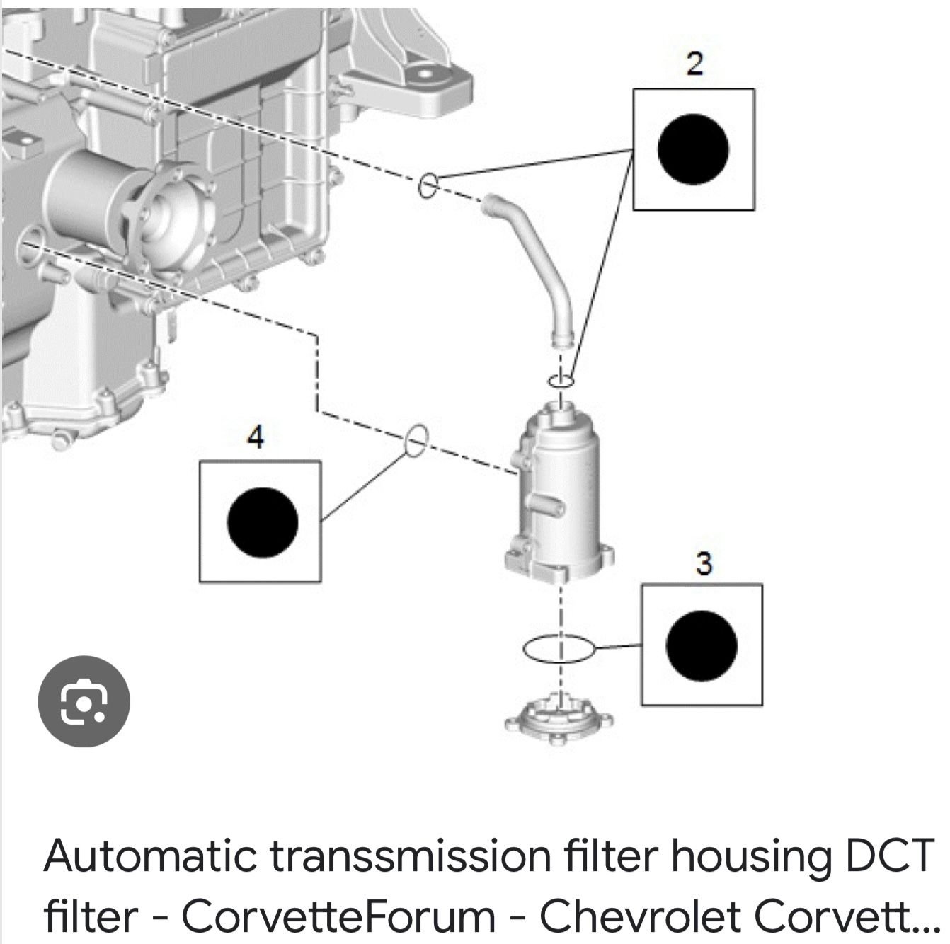

I have a 2023 c8 ,I had the trasmision filter changed and the tech broke the bolt off when taking the cover off . Now they have to change the tranmission fluid filter housing part Number 24048638 has anyone run into this problem and how difficult is to change that part Thanks for any information

They didn't clean out the threads in the housing with the correct thread chaser. The factory bolts and the replacement bolts have thread locker on them. It's surprising how many techs and owners forget this step when replacing the transmission filter.

Originally Posted by Ron_Attleboro_MA
I never read about cleaning\chasing the threads. Is it documented? What size tap?
5mm x 0.8 thread chaser.
Chasing the threads is part of the DCT filter change procedure in the service manual.
