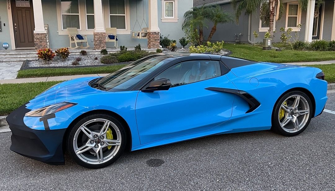

I did this when I picked up my car at NCM, I would definitely do it again. But I wouldn't go so crazy with it like I did. Removal was a pain!
First off, get the Novistretch bra. It really works well, and I use my all the time. The museum will install it for you and everything. It is not like a regular bra, it will not cause damage from things getting "under" the bra. Its a soft mesh, works well for bug guts and small stones. I put track wrap under it and the bra held it on well. I also covered the hood (easy) and the fenders (less easy). Just make sure you overlap it properly and it will last well for the drive up. I only put painters tape on the mirrors and around the windshield. I do not think painters tape works well, it just doesn't stick well to a freshly waxed car, especially if it rains. But if you get black painters tape it doesn't look so junky.
If this sounds like too much work, honestly you are probably fine with just the Novistretch and painters tape on the mirrors. Maybe a little track wrap under the headlights where the Novistretch doesnt cover. Its pretty unlikely that a rock will hit the hood or even the windshield frame, and these cars are not too susceptible to chips anyway. Then just don't follow too close behind semis or trucks.

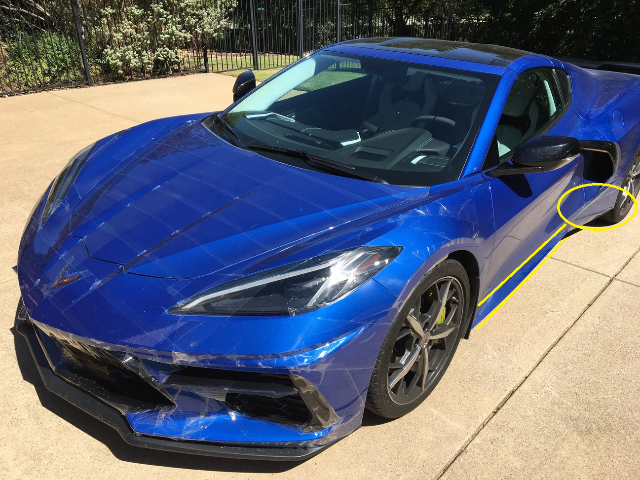

I applied XPEL Tracwrap at the NCM (they let me park under the overhang in front. I started applying it myself and then another R8C buyer (with a next day delivery) came over and help me. All you need is a pair of scissors and the plastic tool that comes with it. Yes, it looks like crap but does the job. We took a 1500 mile road trip home and then took it to the local XPEL installer to have permanent XPEL installed. They removed the Tracwrap and cleaned up the car as part of their install.
