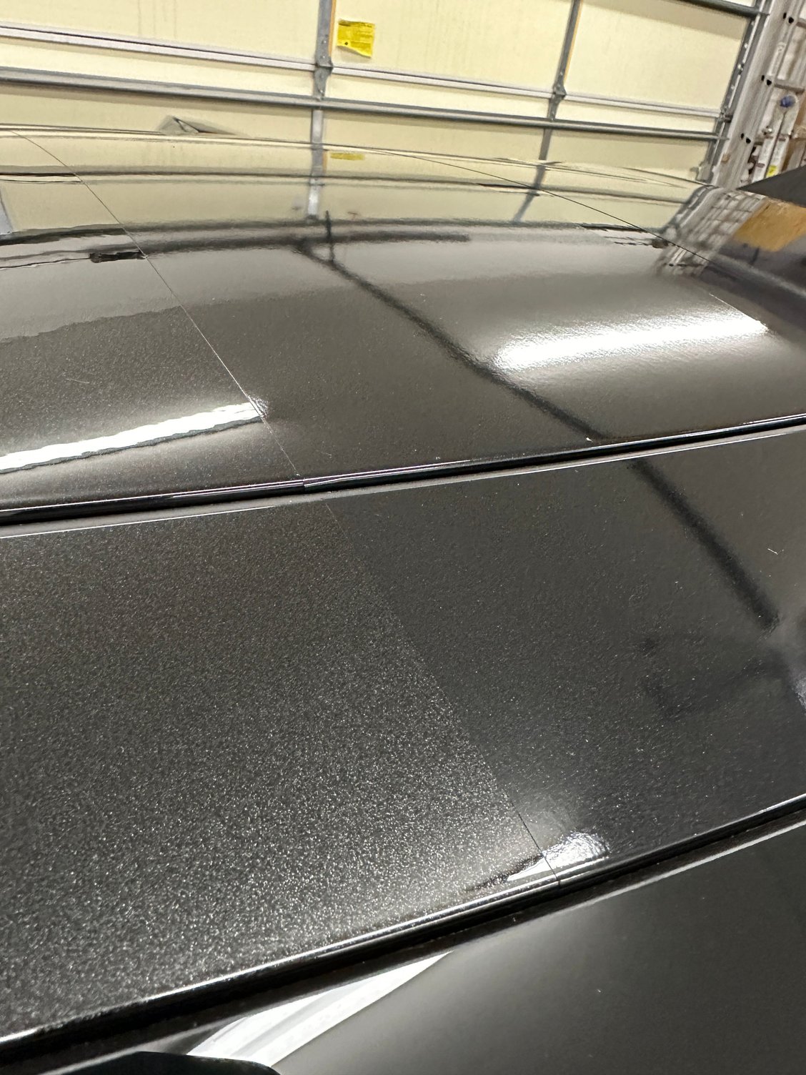

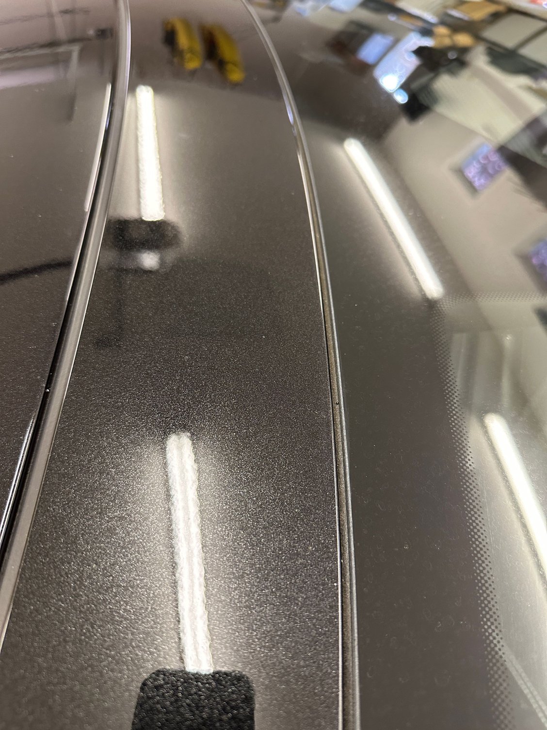

Originally Posted by 1 STING
Not to be inquisitive, I fail to grasp the logic of removing black stripes from black surfaces. You know they are there, not as if they are hardly visible, they are not visible at all. At least not on the photos and I assume not noticeable unless it is nearby. I had a black Mach 1 with black stripes and I thought it was the coolest thing because of it being stealth.
Up close, you see this. I prefer not to see the lines.

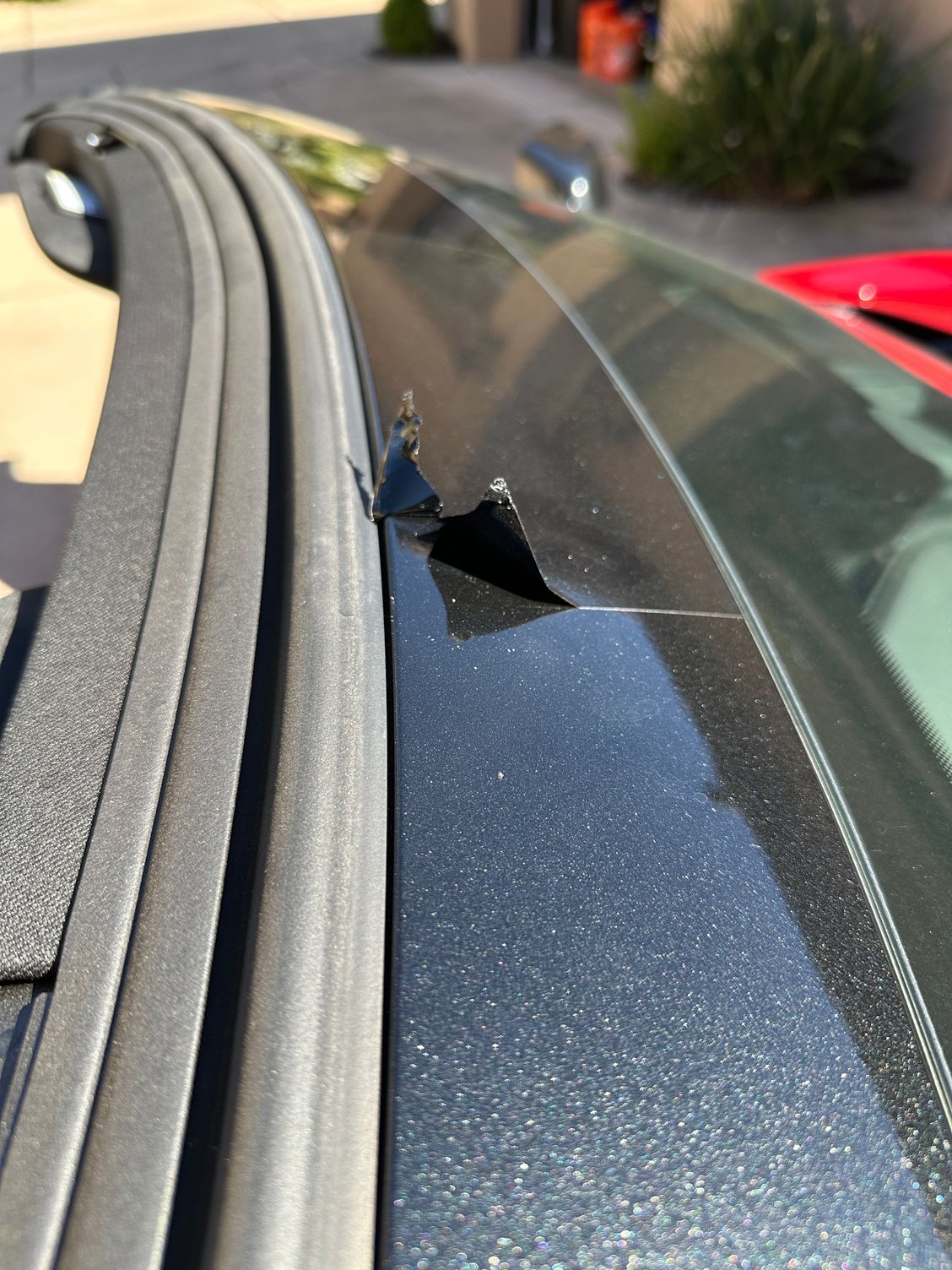

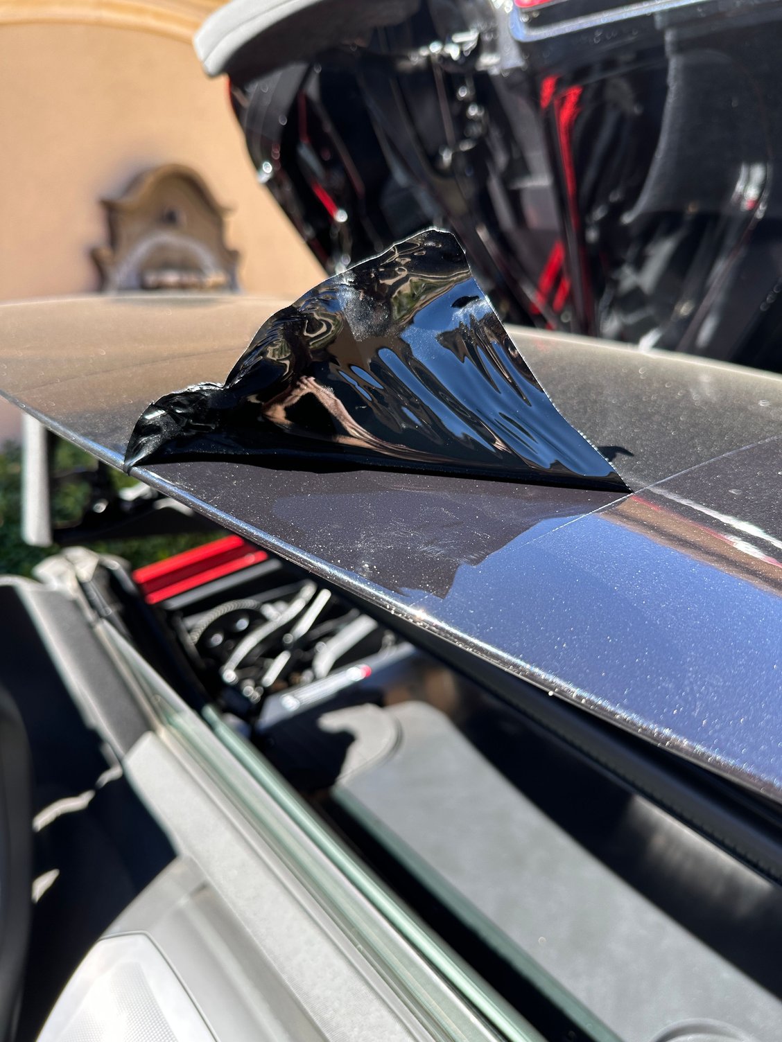

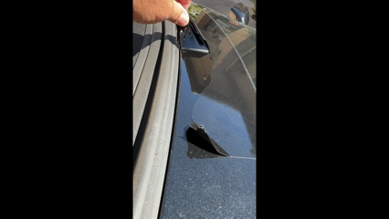

UPDATE:
Well I finally got the nerve to try to remove the black stripes off the black (Carbon Flash) roof and rear spoiler. I was ready to use a heat gun and adhesive remover.
After parking the car in the sun on a relatively warm day for maybe 10 minutes. To my surprise, I was able to very easily remove the stripes by first lifting a corner with my finger nail, then pulled it off with very little effort. No need for adhesive remover. Took 10-15 minutes.
Once stripes removed, I washed the car, clay barred and waxed the roof. Results, perfect and no fading! (One note, my C8 is 1-year, 7-months old, been garaged with only ~7,500 miles.)
