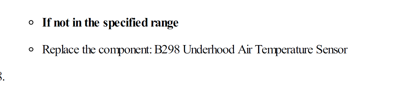

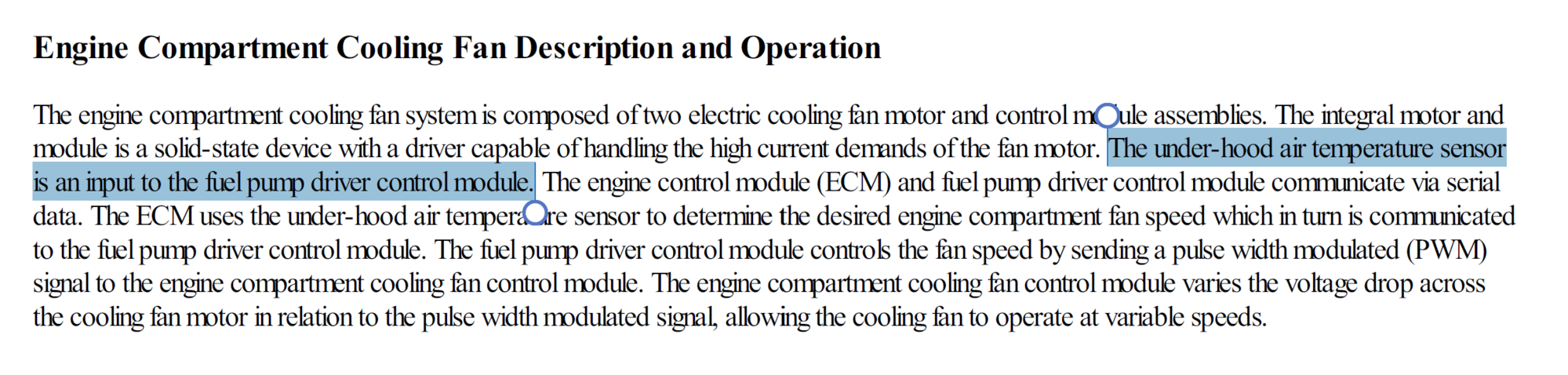

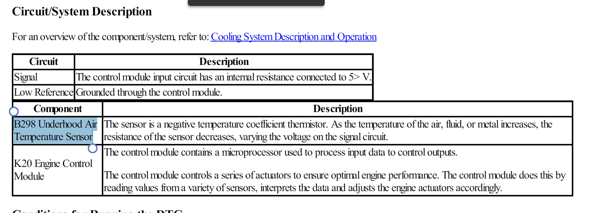

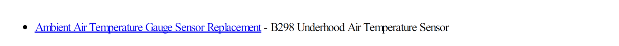

Ok. I'm using a 2020 version of the C8 Service Manual obtained from ebay. I can't find a reference to that code. But the description of the Engine Compartment Cooling Fan says it is controlled by an under-hood temperature sensor. It does not say it is integrated with the fan unit, and in fact there is a diagnostic procedure that calls for replacement of the Underhood Air Temperature Sensor. Unfortunately, I could not find the actual replacement procedure for B298 Underhood Air Temperature Sensor. What I did find was a statement that seems to imply that the B298 Underhood Air Temperature Sensor is the same as the Ambient Air Temperature Gauge Sensor Replacement. It may be a mistake, because this seems to be the sensor for the ambient air temperature gauge, and its not deep in the engine compartment, but it is the only one I could find. So, attached is the relevant information. It may be an error. You might ask the dealer why they think the temperature sensor is integrated with the fan. Perhaps someone with a later version of the official manual can look this up.
Appreciate you looking it up! I have a strong feeling one of these sensors is the actual issue. The sensor isn't that expensive either, so if it's not fixed I could just do it myself.

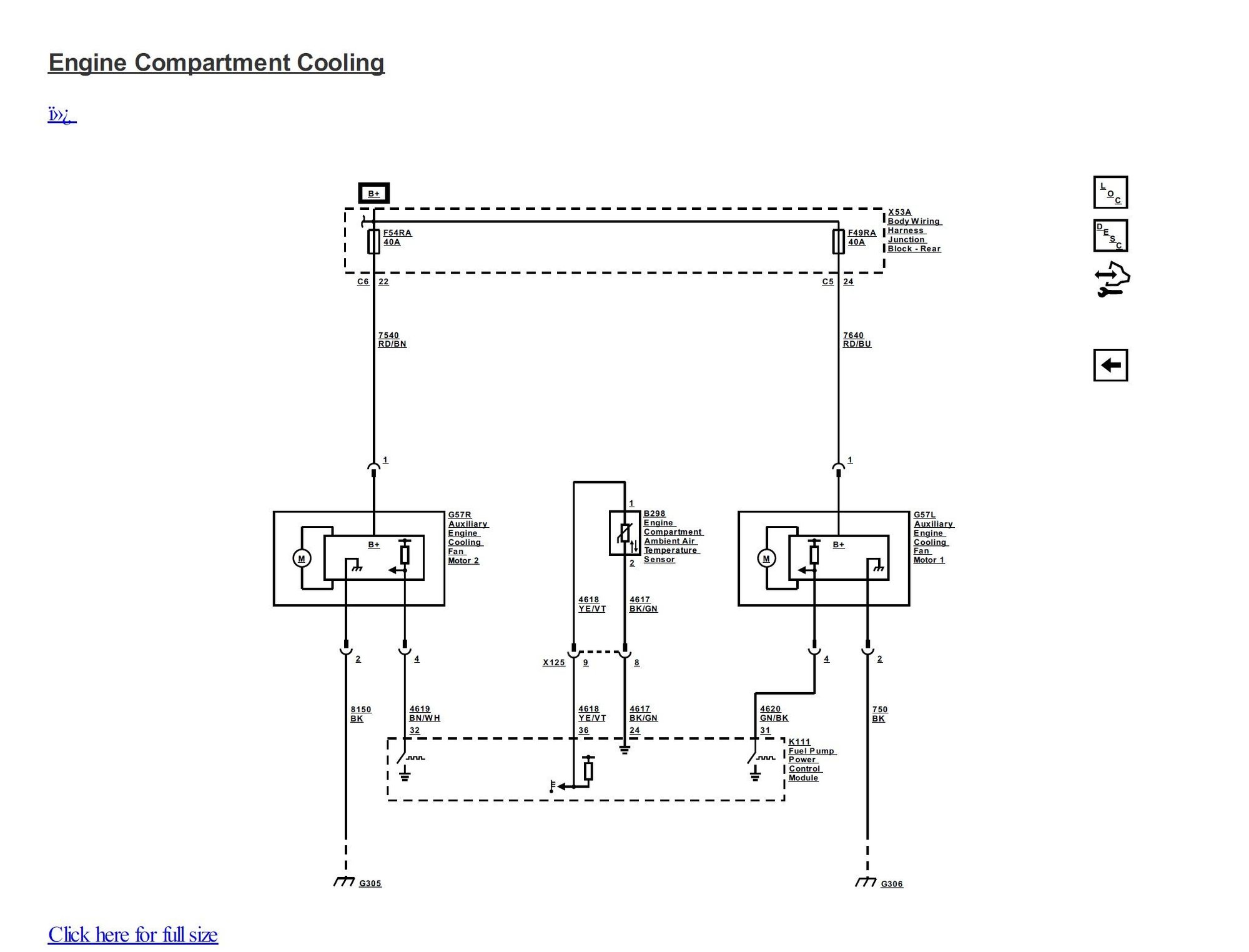

Attached is the schematic for the engine compartment cooling fans. It does not show any sort temperature sensor integrated with the fan units. Instead, it show two separate fan units that are controlled by Fuel Pump Power Control Module. The little symbols (square wave looking symbol) indicates the control is via pulsewidth modulation. That is how it regulates fan speed. You can also see it gets engine compartment temperature data from a single engine compartment temperature sensor. That sensor, I think, is what I mentioned in posts 6 and 8. Now, this doesn't show everything. The Fuel Pump Power Control Module is in communication with the rest of the car systems via the internal network, and we know as fact from another thread that these fans can run continuously if the engine coolant temperature sensor in the engine block fails. So, I'm not saying that engine compartment temperature sensor is the only thing that affects fan action - I'm just saying there is no evidence of a sensor integrated with the fan motors.
