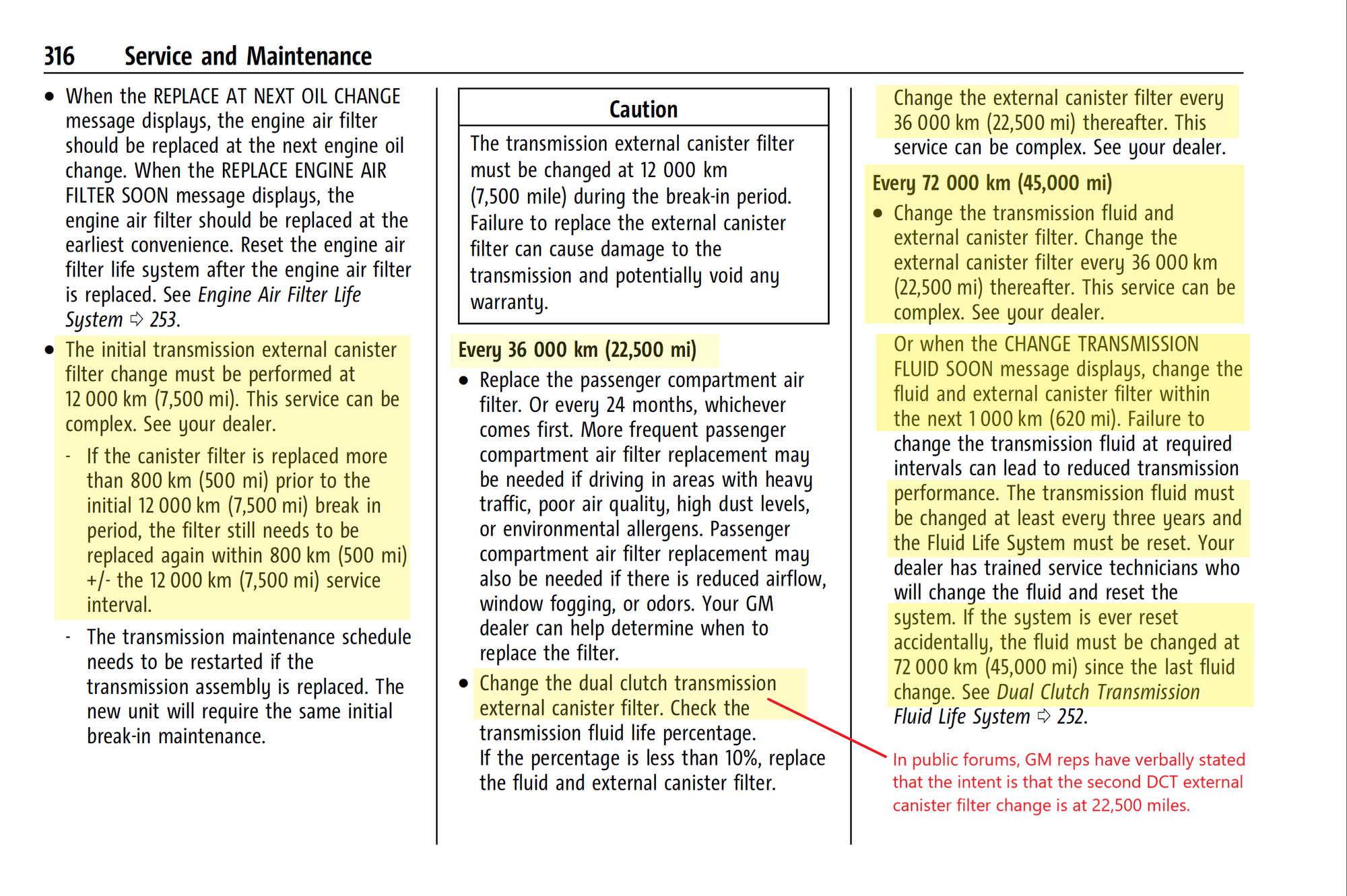

To clarify - the two years is the expiration time of the first free service and there is no expiration mileage for claiming the free service. It includes an oil change and DCT external canister filter change.
But the timing of expiration of the first free service has nothing at all to do with the required maintenance. Specifically, there is no "2 year service requirement" for the engine oil, DCT external canister filter replacement, or fluid change.
The requirements are as follows:
Engine Oil - When the OLM says so, or at least once a year.
DCT external canister filter - Between 7000-8000 miles regardless if done earlier. Then at 22,500. Then every 22,500 miles after. At 45,000 miles. Every 24 hours of track use. Or when the Filter life monitor says to. Other than track use, there is no time requirement.
Transmission Fluid - When the FLM says so. At 45,000 miles. At least every three years. Every 24 hours of track use.

Just be aware that, according to the manual (whether it makes sense or not), if you change that DCT filter before 7000 miles you need to change it again between 7000 and 8000 miles. According to the manual. Which includes some strong language about impact on the warranty if you dont do that. I can see arguments about tolerance - is 6999 to soon? All I can say is that the 7000-8000 miles already is a +/- 500 mile tolerance around the nominal 7,500. So we could go on and on with tolerances on the tolerances.
