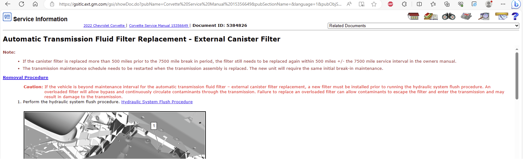

Sure that was the introduction of the features of the new C8 to the techs in 2020. Are you asking about the term flush? The statement about no required flush is referring to the idea that when a transmission is drained then there is a flushing of the fluid in the case. And there is no procedure for that and it should not be attempted. This has absolutely nothing to do with, and should not be confused with, the hydraulic system flush procedure. It is the reason though, that I frequently point out the need to use correct nomenclature for service procedures. Many folks will refer to the transmission fluid change, which is a simple drain and fill, as a "flush". It is not a flush, it is a simple drain and refill. The hydraulic system flush is a procedure in the Service Manual, it has been mentioned in several techlink articles, and it is, among other things, a step in the DCT external canister filter replacement procedure. It does not involve draining fluid or flushing the case. It is a computer controlled manipulation of the valves in the transmission, with the engine running, that has a goal of freeing debris in the lines and valves and moving that to the filter, before the filter is replaced. It takes about 8-10 minutes.
Attached is first part of the DCT external canister filter replacement showing the call to the Hydraulic System Flush procedure.
